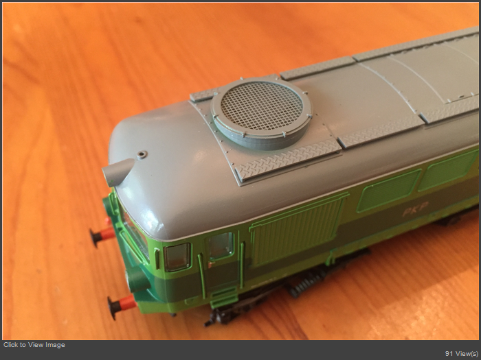

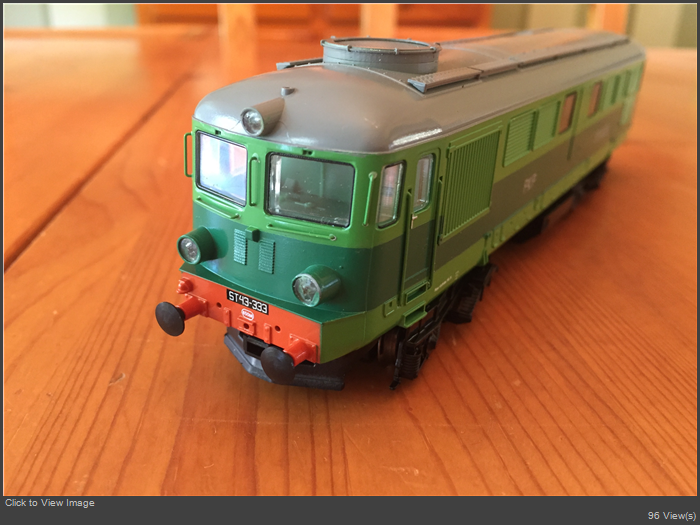

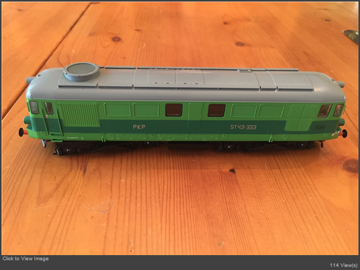

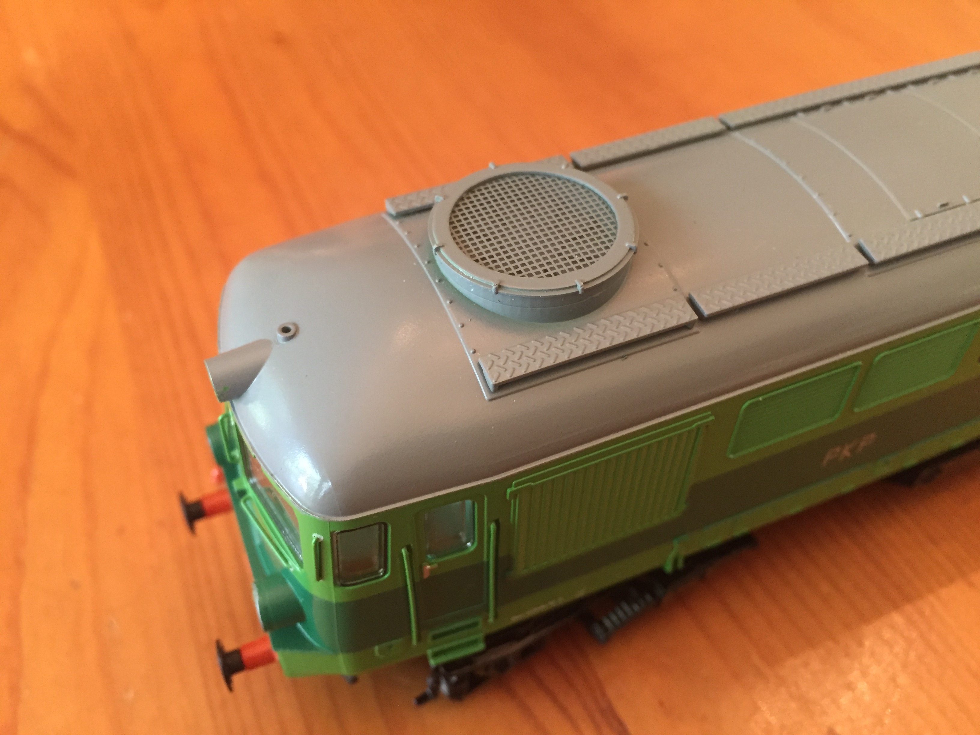

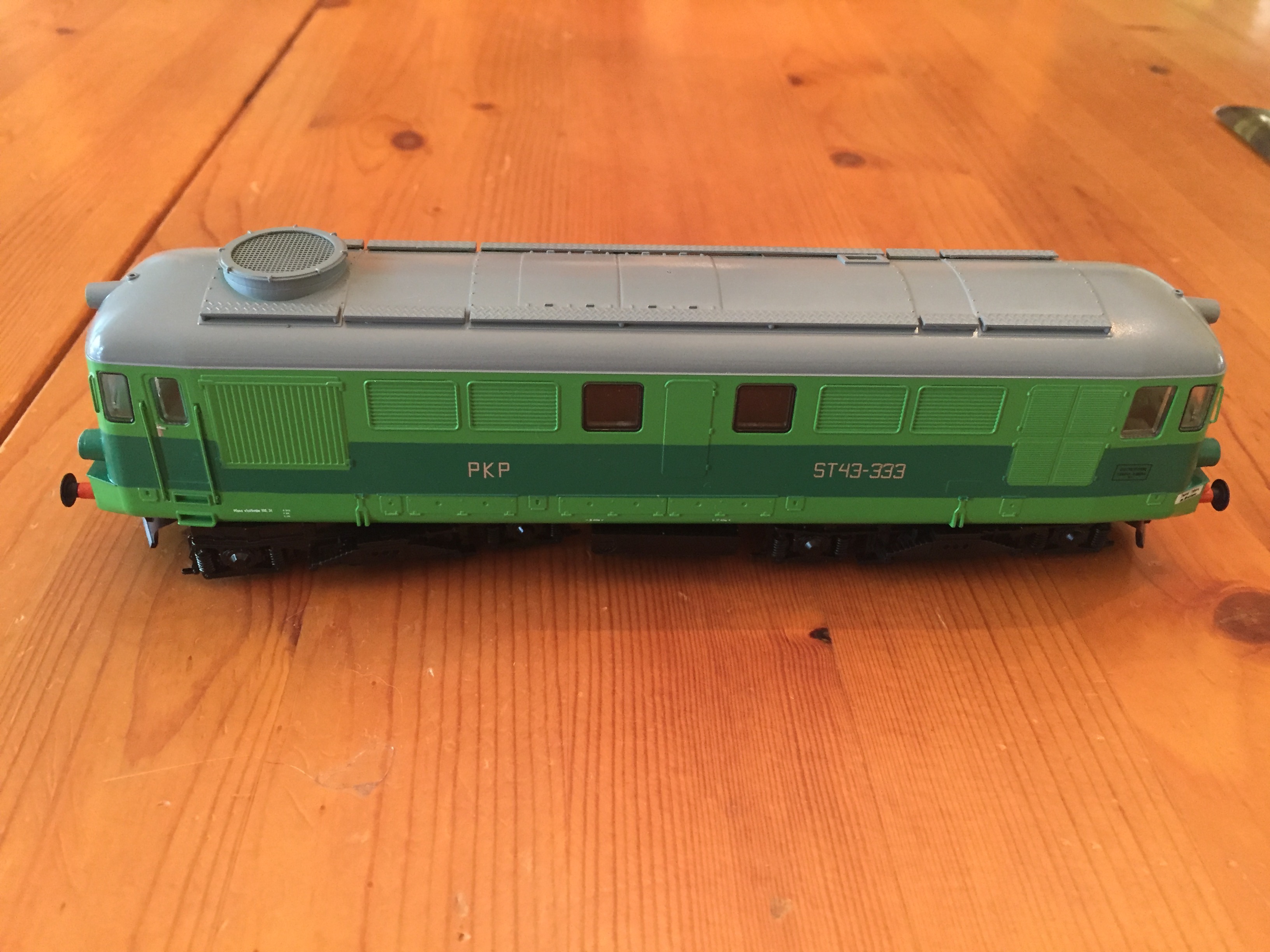

This review is for the MTB ST 43-333 PKP diesel locomotive in HO scale. The model has a motor with flywheel, digital control of lights including cabin lights. The model is decorated in the two-tone green paint scheme which dates it from the late 1990’s through 2008.
UP CLOSE:
The model is well packed – the box holds a nice plastic packing tray and lid along with some foam padding. My first impression of the loco – HEAVY! It weighs 550g per my scale where my SP45 only weighs about 475g. There is a small bag with add on detail parts to be applied to the loco.

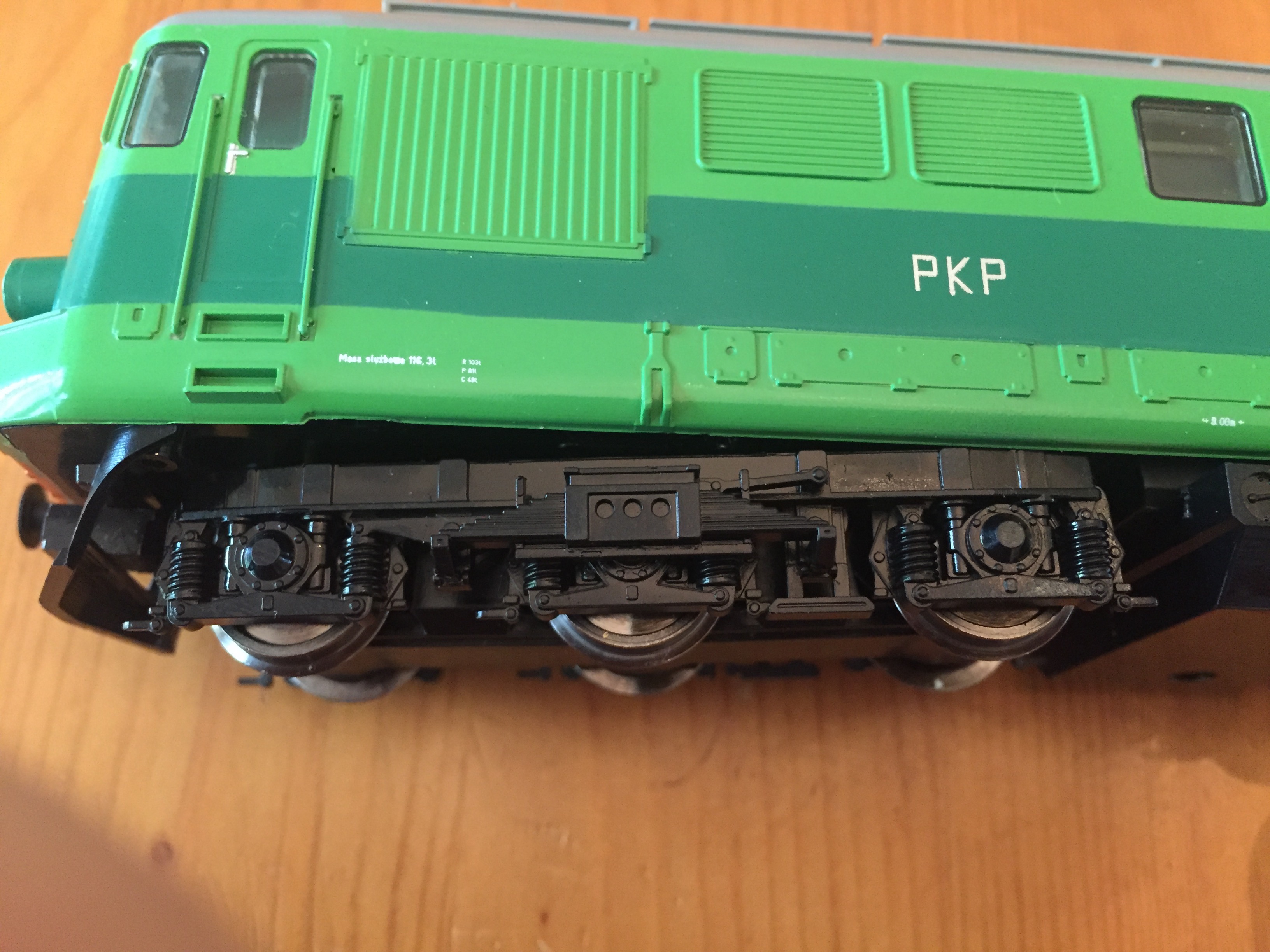

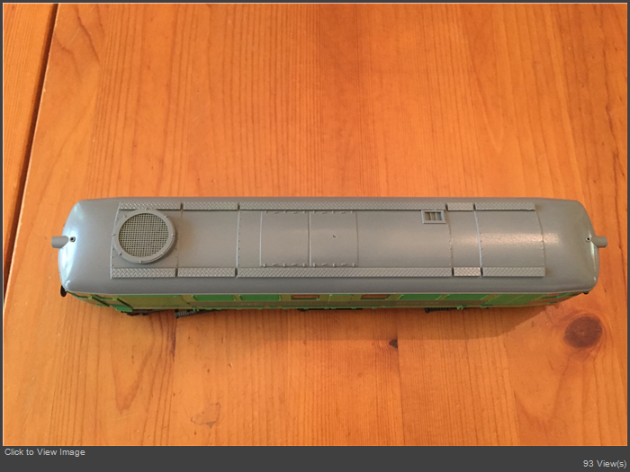

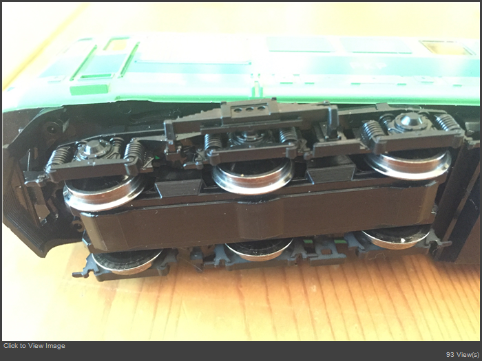

Starting at one end, there are handrails applied horizontally and vertically around the windows along with holes for windshield wipers, a horn, and various hoses/coupling gear. The buffers are non-functional. Molded in details including louvers, steps, hatches, and the like. The handrails around the doors are also separate items. Window glazing looks clear and fits cleanly in the openings. Detail on the roof is also well executed with separately applied walkways and a fan with a see-through grate. The bogies are shiny black plastic (we’ll fix that!) but have nice detailing and depth.
Paint is overall good, although not as super smooth as the current offerings from Piko, Roco, or others. You really have to look close to see the differences. In other words, the paint looks great at normal viewing distances, other than being a bit shiny.

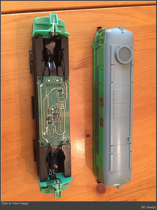

Body shell removal is easy spread the shell and it comes off crisply. The PluX22 decoder socket and lighting control DIP switches are right on top. The shell snaps back on securely.
DIGITAL:
The model has a PluX22 decoder interface and is ready for speaker installation. My decoder (ESU LokPilot 4.0) and speaker are on order – I will update the review once installed.

3-RAIL CONVERSION:

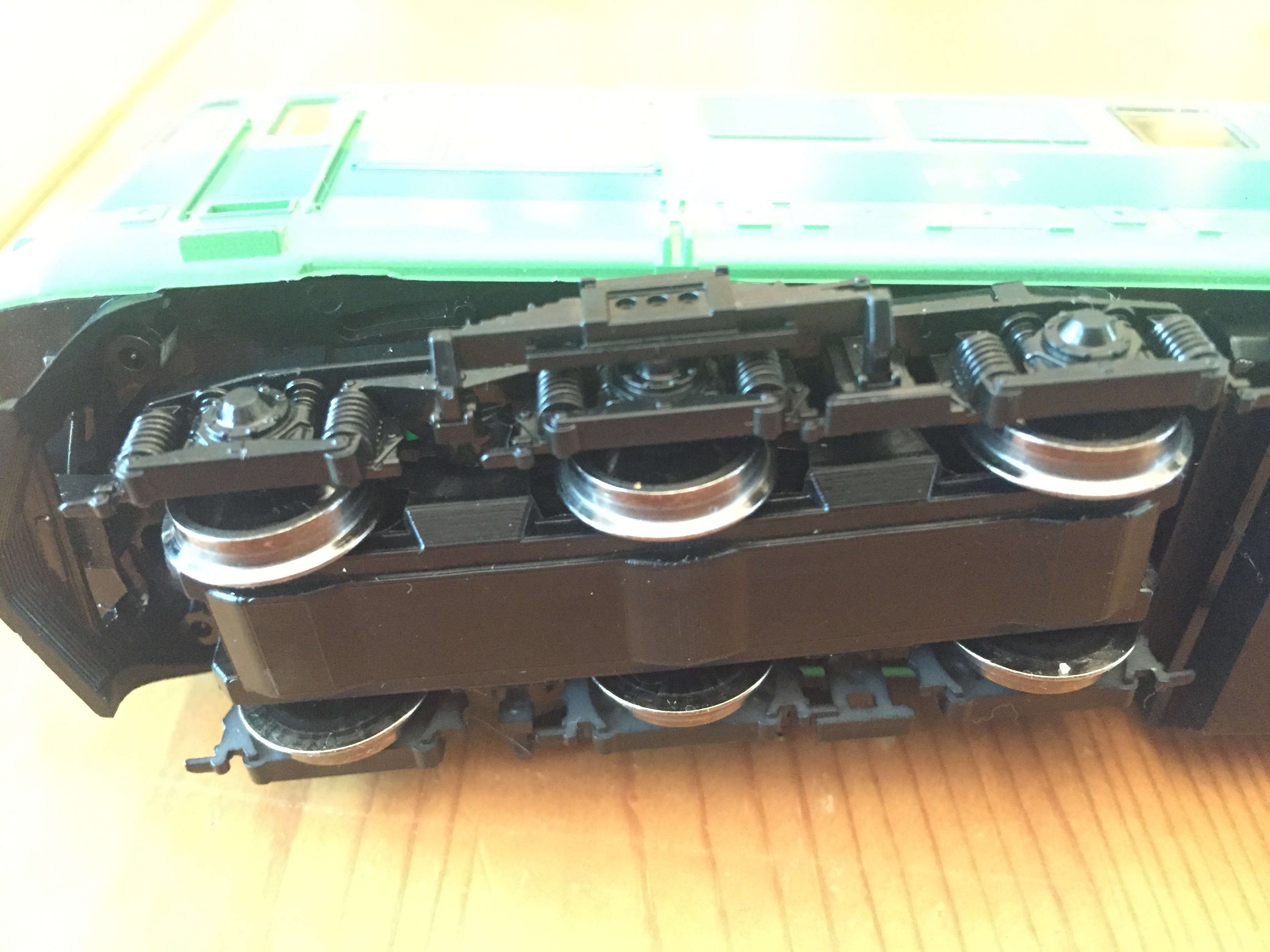

Sadly, 3 rail operations is not going to be simple for this model. As shown in the photos, there is just too little clearance under both bogies to allow installation of a slider with proper clearance on Marklin 3 rail track. I think a successful installation would require significant alteration to the chosen bogie.
I think my Dad would love this on his Marklin layout, so I’m not giving up easily on this loco. One idea I’m considering is to use current conducting coupler/drawbar to pass 3rd rail power from a boxcar fitted with a pickup shoe. I’ll post more info if I decide to go this route.

#2 Posted : 31 July 2017 04:40:59(UTC)
Posts: 14,874
I've done this on a couple of Austrian locos (from Roco and Liliput) and added electrical couplings to the loco and a carriage and it works fine.
That's good to know - thank you! I just need to locate the appropriate era car. I think I have the slider and couplers on hand.
