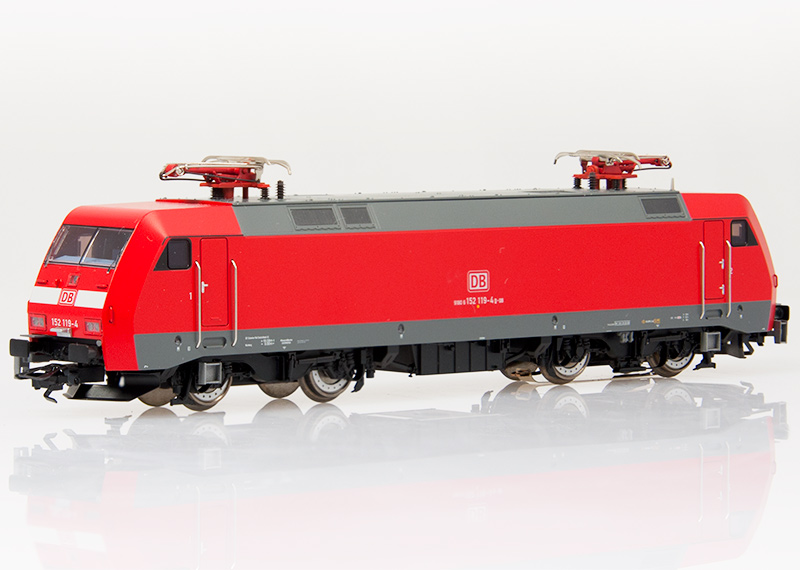

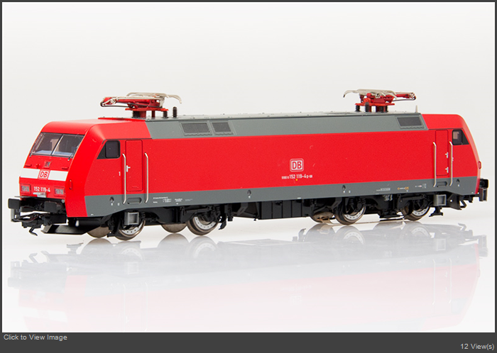

I would like to buy a German loco for my Gothard line, I am looking at getting the Marklin 39850
Can anybody confirm that these locos work the Gothard ?
Tim
#2 Posted : 07 May 2017 14:47:52(UTC)
Posts: 15,452
Class 152 locos operate in Germany. AFAIK they are still not allowed to operate in Austria.
They do not have pantographs with narrow wipers and do not normally operate in Switzerland. Voltage would fit, but there is no Integra.
Are you looking for a class 185 loco with four pantographs? Those locos operate in Switzerland on the Gotthard line - same as the Re 482 locos of the SBB. Roco make nice models with Integra magnets and rear-view cameras. The Märklin/Trix models with plastic bodies also have the Integra magnets.
Thanks for your reply, I will change my order for the 185.

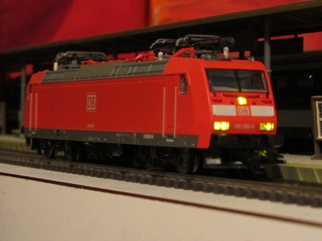

I needed a pair of DB 185s for a container train. I settled on 36856 and 36892, the latter being the one painted to advertise Railion in Switzerland.
The two work pretty well in tandem.
