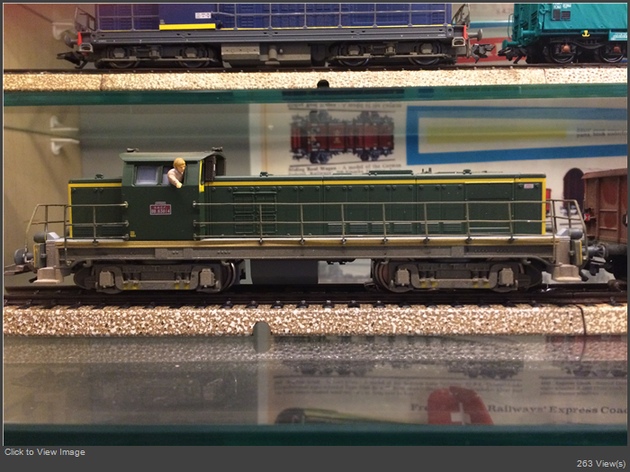

Dear all. I have two Piko locos, they both are light weight and have very basic decoders. What I was thinking of doing, is placing a stay alive decoder in one of these, to see if that helps. I also wondered if stay alive decoders come with Accessorie capability to enable Marklin automatic uncouplers to be fitted. I have already moved the buffers up to the same level as Marklin freight car buffer height, stopping any problems with the trouble you get with other makes and Marklin close couplers. The first loco I want to do has an eight pin plug socket, but there is not much room? Hope you can help. :-)

Yes, the type of decoder which has a capacitor to bridge a gap in track power. There is not a great deal of room inside the cab, were the decoder sits underneath the dash board. My other plan however is to fit a Marklin decoder inside with braking delay and a function use, to allow telex couplers to be fitted. And just add more weight inside, if I can. The decoder I was thinking of was 60760, 60962. I am not sure if they are suitable or have a function. 60962 I'm almost sure is.Confused BigGrin
