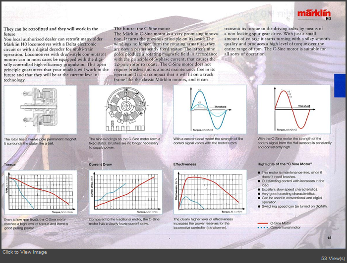

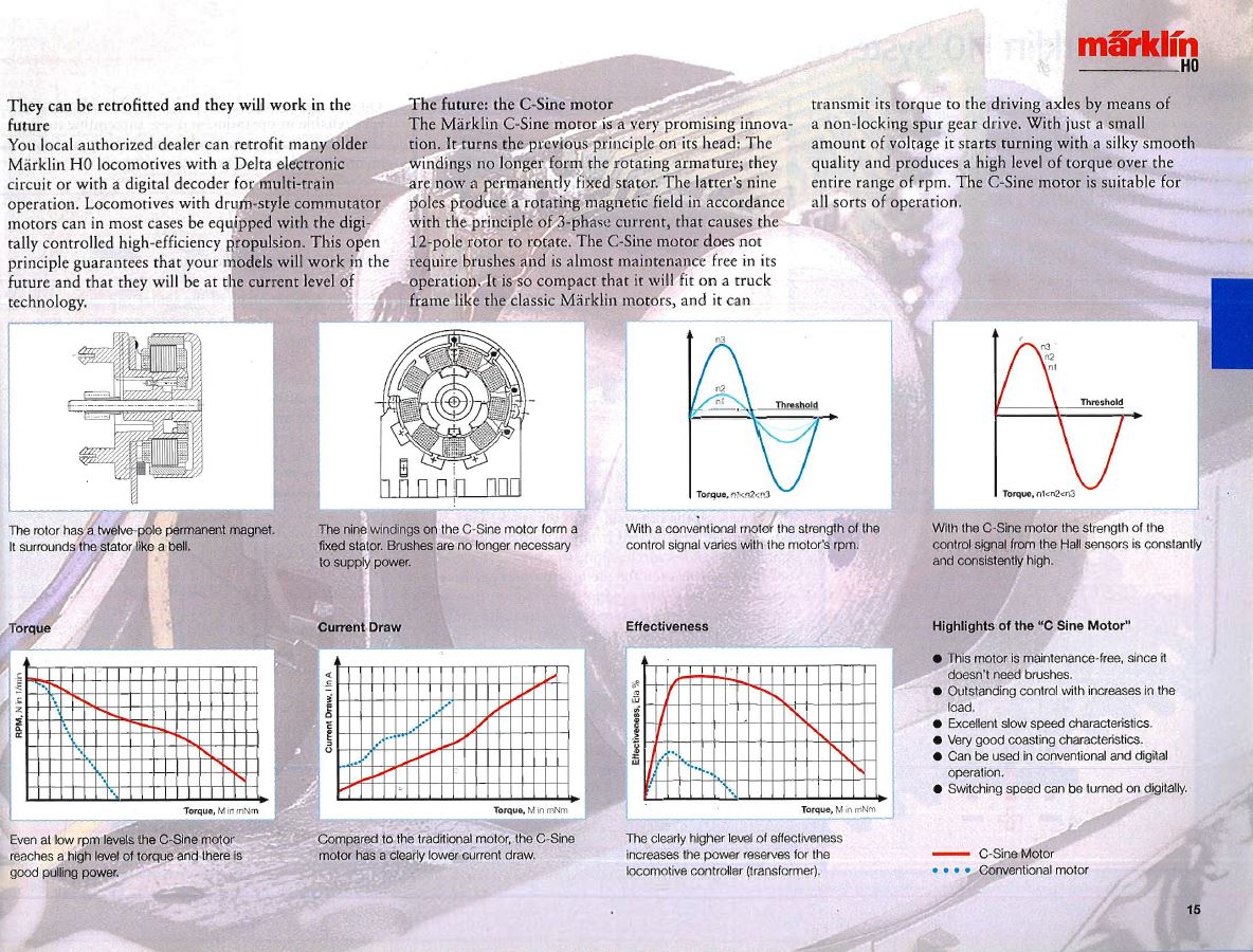

#9 Posted : 08 January 2017 23:46:43(UTC)
Posts: 8,544
And if you find a loco that you like equiped with a C sine motor, dont let it go away, i actually hunt for them.
"a C sine motor" Confused BigGrin
A C-Sine motor is a rather nice motor (in my opinion, but I know not everyone has the same thoughts) which is rather more complicated than the usual AC otr DC motors used because of the extra electronics needed to run it. There are no brushes and the original version claimed to be maintenance free. A later version had poor performance, which was later improved with redesigned electronics and used the term 'Soft-Sine'. But as mentioned they are a more costly motor to produce and with suitable electronics good quality DC motors are capable of equal performance, so Marklin no longer use the C-Sine series motors.
Originally locos with the catalogue numbers in the series 39xxx were c-Sine motors, but then they crept into some 37xxx series models and other motors in top end models crept into the 39xxx series numbers.
#10 Posted : 09 January 2017 00:09:32(UTC)
4. The address number of a loco for an FX decoder is crucial - if two locos have the same address - both locos will respond to the same command at the same time. I know, I have done it with the wireless digital remote control.
Two decoders using the same address can be a feature (simple double heading or loco decoder and train decoder using the same address for simple access).
To throw a spanner in the works, it is possible to have 2 locos with the same address operate independently of each other if one uses the MM protocol and the other is using DCC.
So a loco set with MM address 35 will not conflict with a loco with DCC address 35, because different protocols are used.
#11 Posted : 09 January 2017 00:14:16(UTC)
From the 2003/2004 Yearbook.

My experience with soft-sine is that it is a beautiful, quiet engine.
However some models are prone to stall with just the slightest power disruptions from dirty tracks etc.
If you install a capacitator or a power bank in the loco I reckon it's one of the smoothest Marklin engine you can drive. Without it can very easily become a train you just keep in storage and hardly run...
