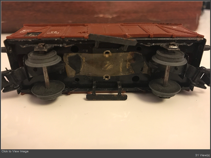

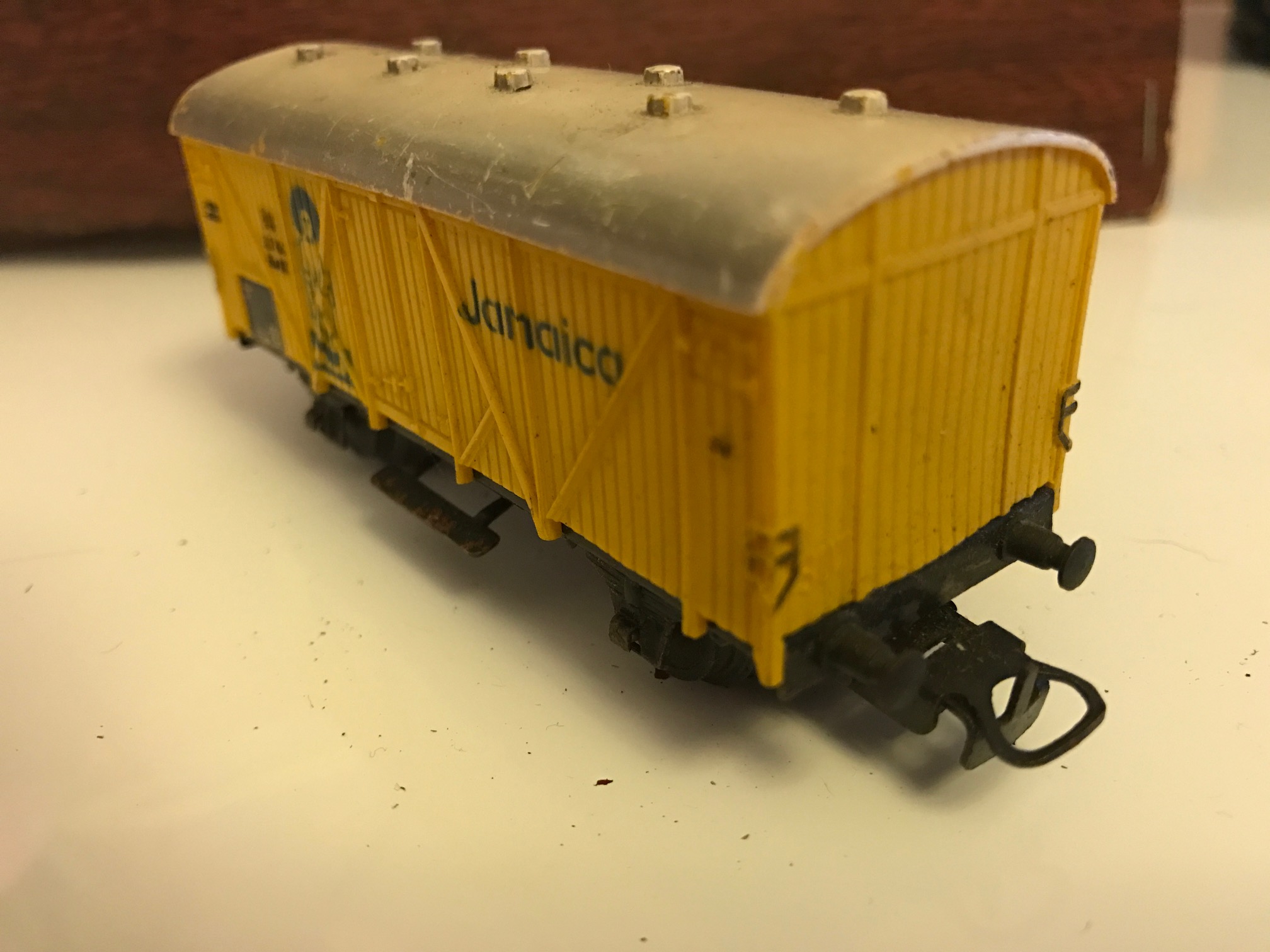

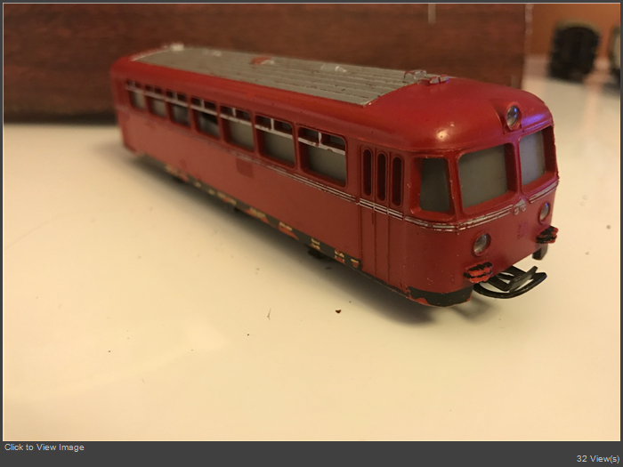

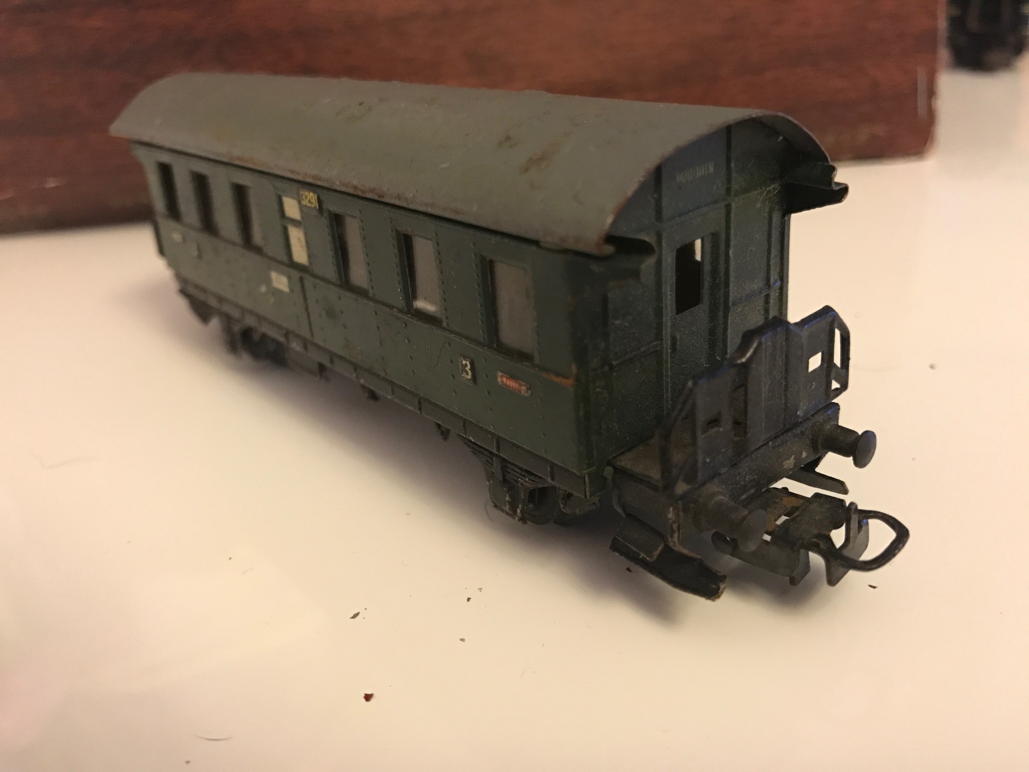

Im attaching pictures from the 13 locomotives/waggons I found so far
Looking forward to your input

yes, these are HO scale Märklin and they look like 1950s era.
Many of the cars need new springs underneath the pull the couplings.
Slider pick up shoes should be replaced.
The locos will need some cleaning and servicing of the motor. New brushes.
The good news is that your local Märklin dealer can probably supply all those parts for you.
Do NOT plug in the transformer until the old power cable to it has been replaced. The old power cable has probably perished by now and you could electrocute yourself on the metal case. New analog power supplies are also available from Märklin and will work the trains.
How much restoration of paintwork and bent ladders etc. is up to you.
Some of the metal shows signs of 'zinkpest' (white powdery surface) - the natural decay of the metal used post war. If it has become fragile, there is little that you can do, other than place them in a display.

#7 Posted : 07 January 2017 16:45:48(UTC)
Posts: 15,873
Restoration of these items would have to be a labour of love as, to be honest, their condition is quite bad and the value of most items would be quite low.
Removing the white oxidation would have to be the main concern. I would try dipping the affected areas in something like vinegar or lemon juice. However the paintwork will have been severely compromised so I would try a combination of stripping old paint off and respraying all over, or just touching up less affected areas.
If you are not that much into the hobby and are just looking for some cash I would advertise the whole lot "as is" on ebay and see how much you get.

I agree with the other ones. Sell everything as it is and don't try to restore anything.
If you live in Sweden use tradera under the headline "Vagnar H0 Växelström" (AC)
Expect to get about 30-40SEK (3,30-4,40$) for the Jamaica-wagon. About 60-70SEK (6,60-7,70$) for the 4506 closed goods car with closing lights.
The green passenger wagon is about 40SEK (4,40$) in that condition.
The electric loco and the railbus will also bring in some money. Maybe 300-400SEK (33-44$) if they work properly. The steam loco is hard to value, because it's in such poor condition.

I would suggest you have a go at that one first because it will be the easiest to get some experience and confidence on and will probably require the least parts. The railbus is designed to only couple with the additional 4018 matching trailer, not with any of the other rolling stock.
Next would be the Red/Brown CE800 (3002). The flaking paint is very common on those. I had a green one in very similar shape so I removed the wire hand-railings (carefully remove the split-pins and pull out from the body) stripped the paint and removed the window plastic. Then gave the body a respray with a Tamiya spray can. Make sure to apply an undercoat first so that the new paint does not come away.
I found a Red that was reasonably close, then masked the body and sprayed the roof silver/grey. Refitted the handrails and windows and what a difference. If you have a very steady hand you can try hi-lighting the numbering on the cab. You need a very fine artists brush for that.
Again, like the Railbus, the chassis on those CE800's are very solid, well-made and generally easy to work on but may require only a bit more work. You don't even have to paint it, leave it like it is it will just look like it's seen very heavy work in the shunting yard!!
Once you have those two up and running, then you will have a better feel for the G800 and whether you want to tackle that. If not, let me make you an offer :-)

Some more pictures of what I found
Interesting photos of old, worn Märklin items. You have a Märklin car, which is quite rare nowadays.
I havent seen the wagon with the crane before, is it original or maybe rebuilt ?
The catenary posts are sought after at netauctions like Tradera.
The old transformator is not 100% reliable. Be cautious when you use it.
