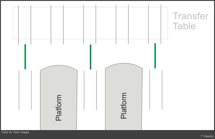

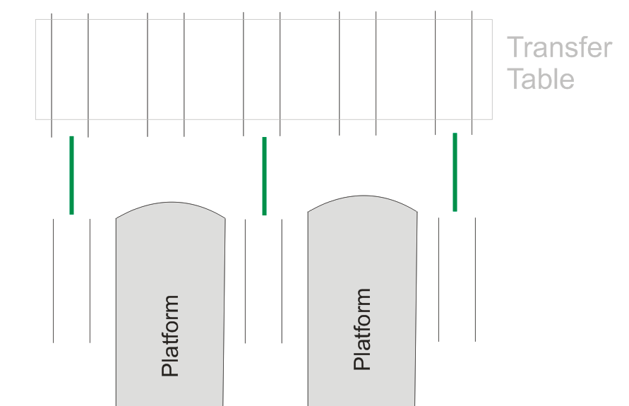

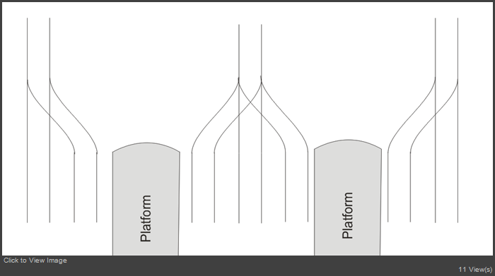

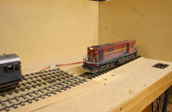

In my planned layout the two ends will be at head stations (kopfbahnhof) at Hamburg-Altona (soon to be dismantled in Germany it seems) and München.
As those two remote ends of my layout run will be on the self sections I have to solve the problem of how to have trains exit out again, after stopping.
In the prototype, the loco gets uncoupled and a new loco installed at the other end. That would mean I'd need approx 2x the number of locos as I have trains (so for one train, I'd need 3 locos just to be able to return the train once it gets to the other end: 1 loco is running the train, and 1 is positioned at each end station waiting to become the next train loco). Now add in other loco types for other types of trains, and quickly I'm having to purchase 4 or 6 locos just to run my 2-3 train classes from end to end. (lucky the ICE is bidirectional). At $300+ per loco (for a DB BR110 or DB BR103 for example) thats is gonna get spendy.
So I thought, what about using a transfer table inside the station building (where it won't be seen), so I can uncouple the incoming loco, drive it to the transfer table, transfer it to a empty track, and then drive it out of the station, and back it up to the train that is there, and off I go. Given the transfer tables are about €20 cheaper than a single loco, for 2 transfer tables I'd have my problem solved for any non-two-headed train. (ie for all of my IC, E, and local trains).
Does this seem like a reasonable idea? Is there a cheaper transfer table solution available (as I don't need the prototypical look, its all going to be hidden inside the station building)?
The open question I still have is what is the track spacing on the 5 tracks on one side? I'd have to spread them out to be able to get platforms between them in some way. But how much further length will that add to the solution (and station building as a result) to put in the added s curves?
An alternative is to just use the center and outer 2 (so 3 of the 5), is that enough to get the rails in there.
Which one is best depends on how much width I will end up having as well as station depth (length), and # of tracks I will need. I can see getting by with 3, and that lets the station be narrower, but is there enough space between the tracks if I skip on on the transfer table so that I can put a workable passenger platform between them?
What is that spacing from table track 1 to track 3 (center to center)?
#2 Posted : 28 November 2016 22:31:43(UTC)
Posts: 3,997
I don't think transfer tables will work so well inside the building, plus you have to uncouple them somehow and if you can reach in to fix issues, they you can also see in.
You only need one spare loco per station, and the coupling and uncoupling will make very prototypical activity.
#3 Posted : 28 November 2016 23:39:00(UTC)
Posts: 2,319
Valid points.
The theory all hinges upon having a reliable uncoupling track segment that will fire when the locomotive pulls in the end spot. Or I'd have to fit telex couplers to the locos (but the my plan of feeding power to car lighting via the locomotive coupler is likely out the window). I'd like the operation to some day be fully automated, to get a train to run end to end continuously with the repositioning of the locomoitives also being computer controlled.
I'd need one spare loco of each type at the each station. So if I am pulling an InterCity train (in my case a red/ivory livery BR103), I'd need a spare for that. For the schnellzug pulled by a blue/ivory BR110 I'd need a matching spare for that, etc. I don't want to mix and match any old loco pulling the cars. Thats why it would be so spendy. Granted, I could use a switching loco at each station to pull the passenger cars out onto a siding, back out the main loco, then reposition the passenger cars, and pull the loco into place again, as an alternative. That would indeed then only require a single small loco at each station, though I'd still need the uncoupler tracks.
I'd build the station to have a removable roof panel to address any occasional issues. Why (beyond the uncoupling problem) do you feel having a transfer table inside a station to move locomotives off of a track and around the platform to an exit track? Its a problem I need to solve. A loop of R1 would take up much more space than a transfer table, hence why I'm considering this.

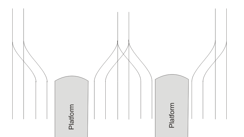

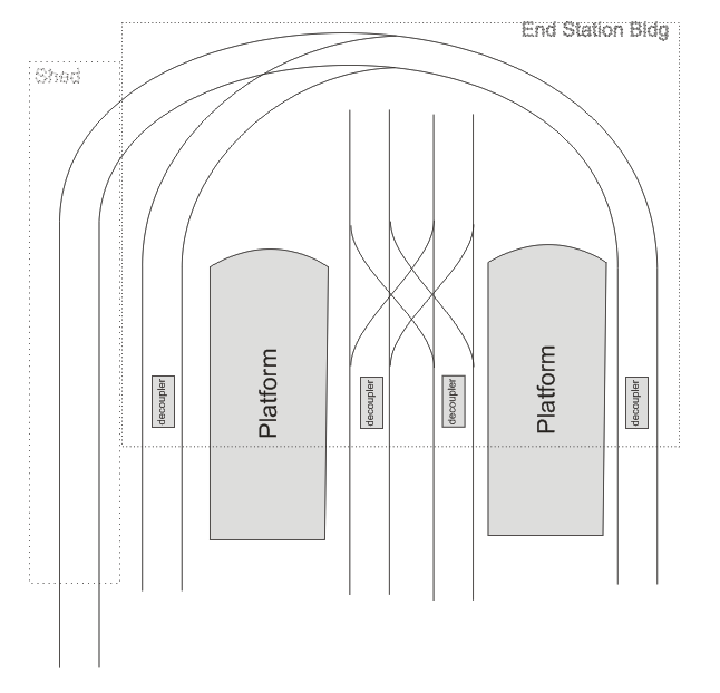

- update -
And I realized of course, that one can solve it with just turnouts, and they don't even have to be electrically controllable and can be merely spring-driven to maintain one state.
I'll have to sit down with the track layout software to see what the space requirements really are, as this solution is the most foolproof and inexpensive, if it doesn't take up much more space than a table.

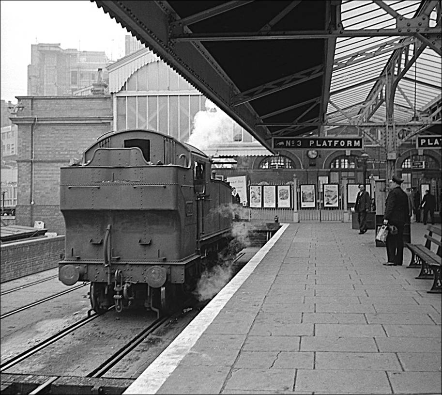

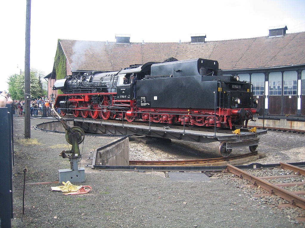

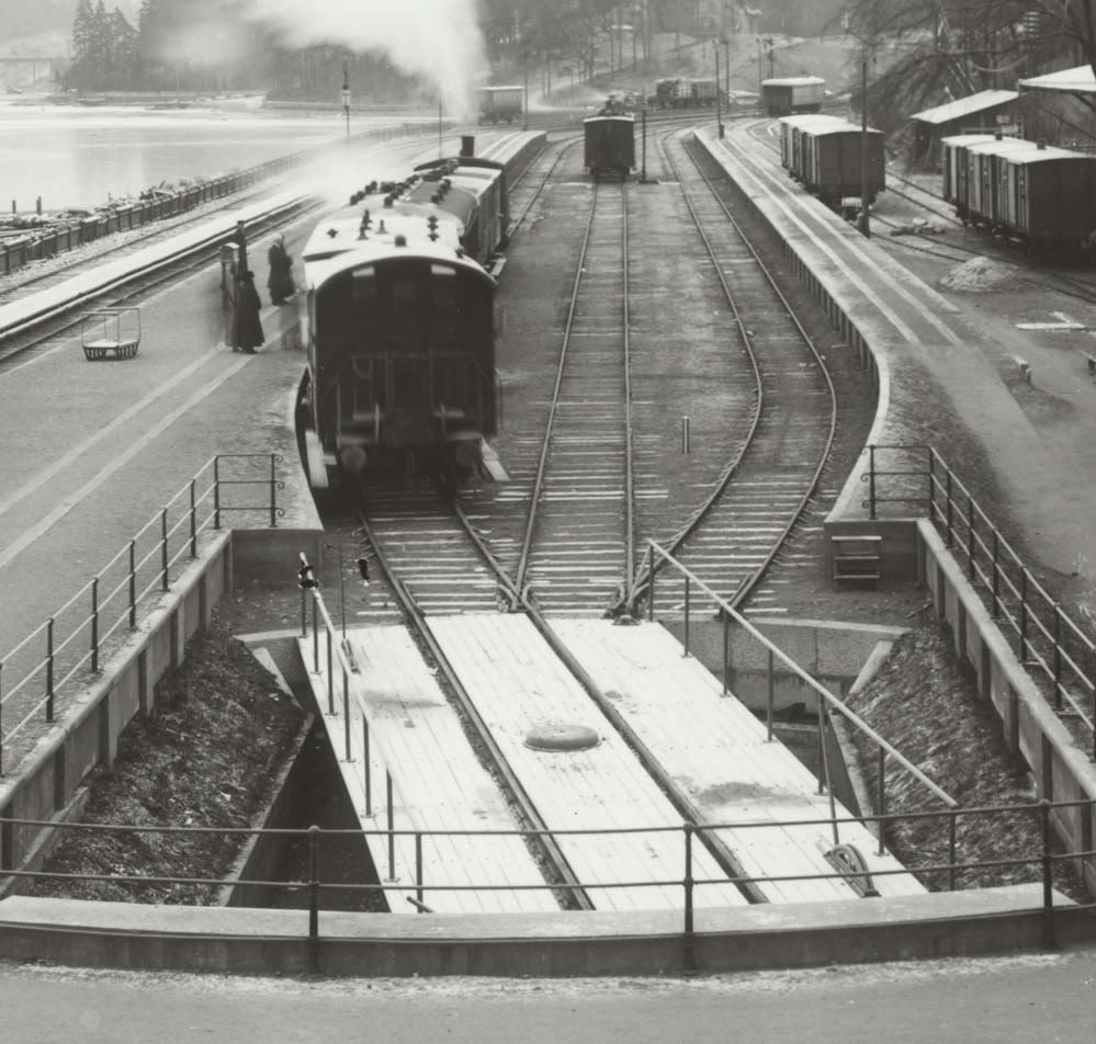

Hey Minok,
Have you considered using a Sector Plate arrangement?
It seems to be a simpler alternative to using a transfer table.
You will have the freedom to set as many tracks in any position as desired.
It has been used in the prototype.Drool ThumpUp
Mikey.
post-6867-0-77554500-1346354446.jpg1024px-DRG_Class_41_on_Neuenmarkt_turntable.JPGsector-plate-5.jpg
thanks 4 users liked this useful post by analogmike

#7 Posted : 30 November 2016 22:21:27(UTC)

Hey Mikey, where was this photo taken? I have the Noch 66250 sector turntable and have an idea of how to justify using it, but am looking for prototype examples.

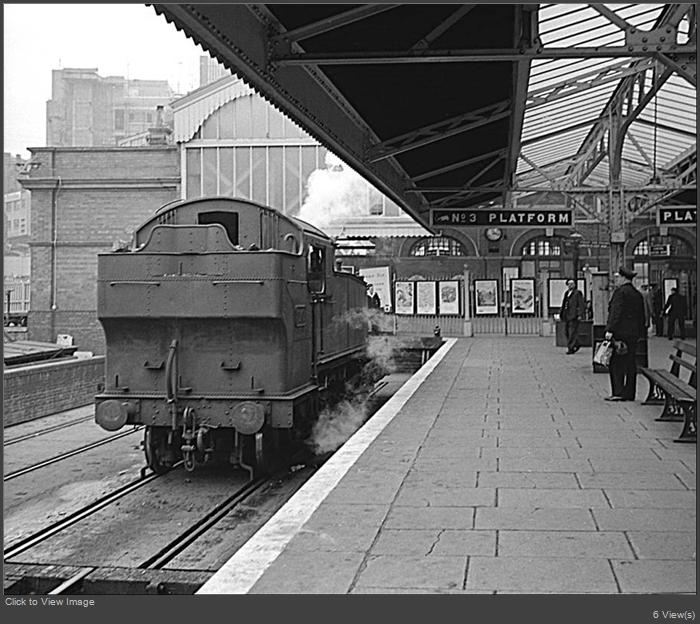

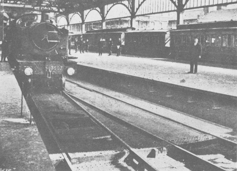

Hey,
I found some more.
Birmingham Snow Hill Station
Moor Street Station Traverser
Location unknown
Mikey
#12 Posted : 01 December 2016 04:12:44(UTC)
Posts: 3,997
I think the prototype images suggest a great thing to model. I wonder if it was ever done in Germany also?
#13 Posted : 01 December 2016 22:11:22(UTC)
Posts: 2,319

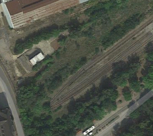

They apparently did. Thale had one until 2003 apparently ( https://en.wikipedia.org/wiki/Thale_Hauptbahnhof )
You can see in Google Earth where it used to be ( https://goo.gl/maps/nTsHGkhHQ3K2 ):
#14 Posted : 01 December 2016 22:17:45(UTC)
Posts: 2,319
Another option with switches only - its going to come down to what real-estate will it actually take with real track and turnouts.
The one region is under the roof of the station (so you won't see it unless you look under or remove the roof (for maintenance designed to), while the side return track comes out of a separate building of a train shed, so the locos from the outer two platforms get returned out of the shed, while the inner two get returned by the other inner track (so it requires that track remain clear - so both center tracks both blocked for an incoming train until after the loco has been maneuvered out.
Again, the switches are always in one position held by the springs.
Summary
From this brainstorming, idea suggestion, and a Stummi thread from a few years back that describes the operations at the two end stations I want to have (though not mimic in size/scope/operation necessarily) there are several forms of prototypical operation:
  1. Train enters w loco at front, loco decouples (while passengers exit and enter), different loco attaches to back, train departs with new pulling loco, freed up loco goes to BW (this will require purchasing more locos <darn>)
  2. Train enters w loco at front, (passengers exit), train pushes out to staging station/track in the nearby area for re-arrangement, and is then pushed back in by the loco that's been relocated to the proper end (passengers enter),same loco pulls train out on new run
  3. Train enters w loco at front, (passengers exit), loco uncoupled, switching loco pulls the train out, freed loco drives out, switching loco puts cars back by platform, uncouples and goes away, main loco reattaches (passengers enter) and train pulled out by same loco. YouTube - München Operation
  4. Train enters w loco at front,( passengers exit), loco uncoupled and loco then exits out via switches through a siding track to drive around the cars, (passengers enter), same loco pulls the train out
So from the prototypical operations stand point, all varieties exist.
From the building my self based model that has such a station at the end (two actually, one at each end, just differing in scenery/backdrop/decoration).. I need to implement some form of operation in the space limits, seeking to automate (read: computer control) as much of this as possible (all ideally). Decoupling apparently works pretty reliably if you do it right (sequence of loco movements on the uncoupler), the re-coupling is the trickier bit... will have to test things.
What I'm then left with is deciding which operations are most reliably automated in the space I have, where I can (under the hidden area of the station under the removable roof) implement cheats to simplify/shorten the operations.
  • A transfer table lets me avoid having to have the switching track area before the station to facilitate the rearranging of the loco and cars, but adds the complexity of a moving component that has to be orchestrated - so engineering/sensing/control complexity added to reduce space requirement. But the complexity of moving the train around in the switching area before the station is eliminated (which would be more uncoupling/recoupling)
  • Using switches and a loop-around possibly, eliminates the transfer table complexity but may add more space needed in the hidden part of the station area.
In all cases the uncoupling-recoupling problem has to be solved. In all cases, the train coming in to the station and then exiting again will be a complex control system dance of rolling stock, loco(s), switches, and possibly other equipment to make it happen. Automation will be a challenge, but is theoretically attainable, if I can get recoupling to happen reliably. Otherwise automated trains arriving will get stacked at red lights coming into the station as I have to manually take control to recouple locos for exiting trains. On the plus side, the testing of "did it couple" should be easy to instrument for so the control software can try it, test for success, try again, and maybe after 2-3 fails throw an alert to the HUMAN to come help.
Clearly not a layout for one to sit there and watch the trains go round-and-round. Maybe the solution that requires the least amount of uncoupling/recoupling is the best.

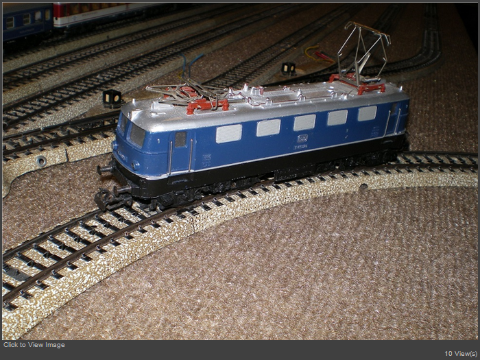

I remember doing a small temporary layout once.
I was forced to use 5120 M-track for a lower reverse loop.
All my E-loks/diesels with 4 wheel bogies rolled through it with no trouble at all.
Loks with 6 wheel bogies and big steamers were no good.
I wouldn't go anything tighter than that.
Thanks. That's good to know most of my locos at 5 wheel bogies so that means I'm stuck with R1 curves at the tightest. Bummer but it's solvable. Just means id have to have track further into the room than I'd want.
Offline Shamu
#21 Posted : 03 December 2016 06:07:18(UTC)
Shamu
Joined: 12/07/2011(UTC)
Posts: 1,068
If you look at the bottom section of the mess 6x3.scarm (28kb) downloaded 19 time(s). you will see where i was playing around with how to extract loco's from a terminus.
It works out to just on the metre mark.
I'm inclined to have the straights between the uncoupler track and the points as I avoid loco's stopping on points etc, so i suppose you could shrink it by around 100 to 200mm but its still another 800mm you need to tag on.
