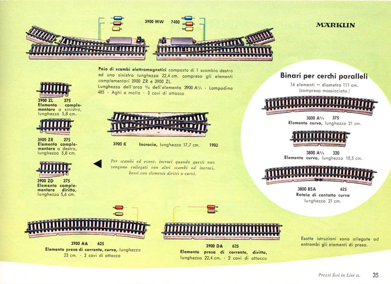

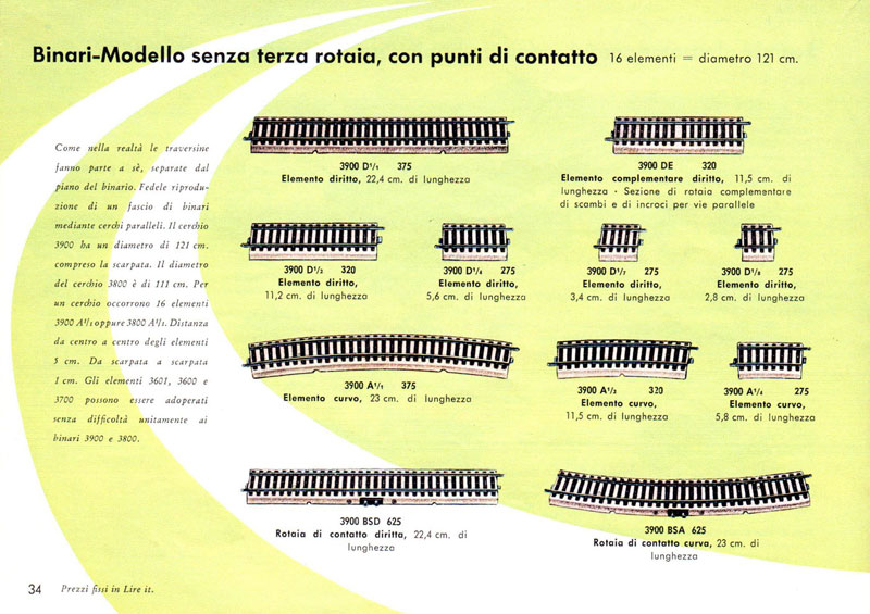

Yes Märklin 3900 and 3800 tracks ("ModellGleis") are very nice and hard to find (produced only during 3 years) and with large radii (1,2 m and 1.1 m diameters)
Here is a 1953 catalogue. See pages 34 and 35.
Cat Marklin 1953 EN.pdf (3,535kb) downloaded 71 time(s).
The 3900 curves are NOT equivalent to 5200 (on has a 1.1 diameter while the other one has a 0.91 m diameter)
The Modellgleis is searched for because of big diameter, imitation of sleepers, insulation of 3 rails allowing long detection zones, narrow space between tracks but alas no double slip switch. Fully compatible with other Märklin metal tracks (prewar M, post war M with center rail, M with studs).
