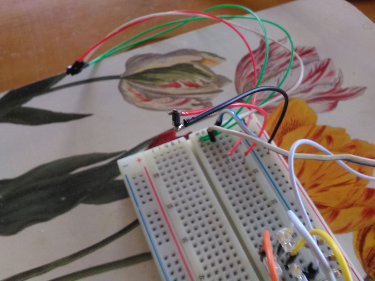

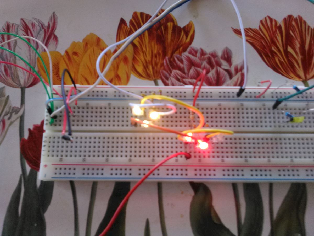

This photo shows the three white front and 2 red rear lights lit up
this other photo shows the 3 rear lights and 2 front light lit.
If you look carefully in the next 2 photos you can see the very small size of the bridge rectifier and the CCR
We still have a problem with getting the flashing light to work consistently. At low tranny settings below 1/4, it flashes normally. above that it starts to get erratic then goes out completely.
Dereck
