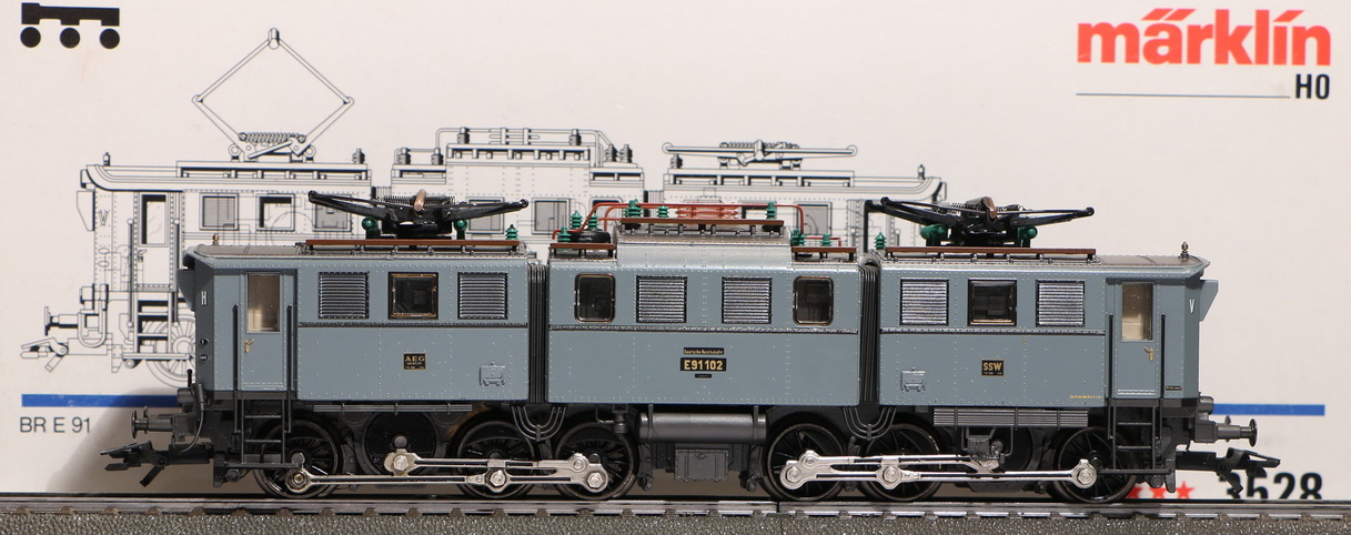

First of all conversion is a big satisfaction.
Of course the cost depends to what do you want to do, and what locomotive you are going to convert.
If you want to run a DCM Locomotive in Digital with basic functions (fo, f1, f3) no mFX and no sound and have LED lights as well, you can use 60760 set for less than 40Euro (motor & decoder & Led etc). This cost is Ok even for a 3000 that you have unused.
If you want sound, MFX, and motor, the cost is more than 150 Euro.
In comparison A good new Loco cost at least 300 Euro plus
I am converting at the moment a 3352 Crocodile, a 3009 Br 85, a 3528 Br E 91.
All these locos were the most expensive in the catalog in their time.
I bought the 3352 150 Euro, the 3009 80 Euro the 3528 120 Euro boxed in excellent condition. (there are pictures in marklin-users.net).
I belive that for this level of locos are worthy the 100Euro that is the mean cost for the conversion.
I will post all the conversion process and the cost, and everybody will decide if is worthy.
Any way model railroads are just a Hobby and we spent money for something without any practical value, just for our enjoyment.
The conversion alone is a great procedure!!!!
So go on give live to the old Ladies. Locomotives are to run on the tracks not to stay in sealed boxes!!!!

1st case:
3528 E 91
I paid 120 Euro for this 5***** model
The conversion:
Motor 060941 32.00 Euro
Decoder 060977 (sound) 105.00 Euro
Decoder 060972 (no sound) 42.00 Euro
LED, resistors etc 5.00 Euro
Total cost: 120+32+105+5=262 Euro with sound or 120+32+42+5 Euro=199 no sound
Prices are from my local dealer, you can find cheaper on web shops.
The same model E 91 in the 2016 catalog is 37294 and the price is 383 Euro !!!! near the double !!!!

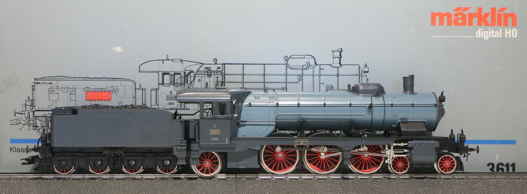

2nd case:
3611 Wutt C
I paid 130 Euro for this 6081 based digital Loco with a Faulhaber DC motor
(In 1987 Catalog was the most expensive model 568 DM, in the same catalog 3652 "Crocodile" was 409 DM !!!)
The conversion:
Motor: don't needed
Decoder: 060975 (sound) 105.00 Euro
LED, resistors for cabin Lighting: 1 Euro
Smoke Generator 72270: 26 Euro
Total cost: 130+105+1+26=262 Euro (without sound is only 200 Euro but in my opinion is not recommended for a Loco like the "Beautiful Lady")
In 2016 catalog there is the same Loco 37117 in the BR 18.1 version and with ESCAP motor who is in the same price like Faulhaber, the price is 417 Euro + 26 Smoke Gen = 443 Euro !!!
Plus the satisfaction from the conversion.
