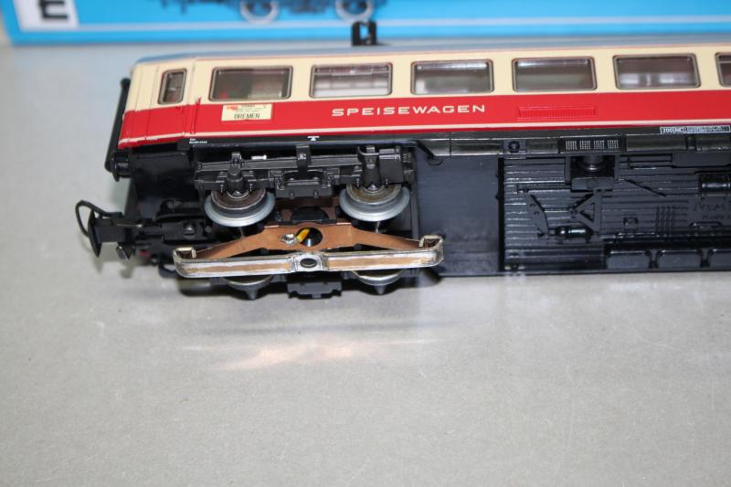

I just received my Marklin 4153 restaurant car to complement my TEE set up. I realize now that it has lights, I was not sure before, but as I have no overhead wiring I will have to add a pickup shoe. Has anybody done this? Most likely I will need the 7190 slider and I not to sure how to take it apart it looks like you have to pry the sides apart. Any advice will be helpful - Fred

My 4153 have screw under - one in each end - just pull it apart. Slider 73405.

See pictures for clarification.
Unsure of slider #
Small slotted screw holding the body to frame, just behind the coupling to truck joint.
