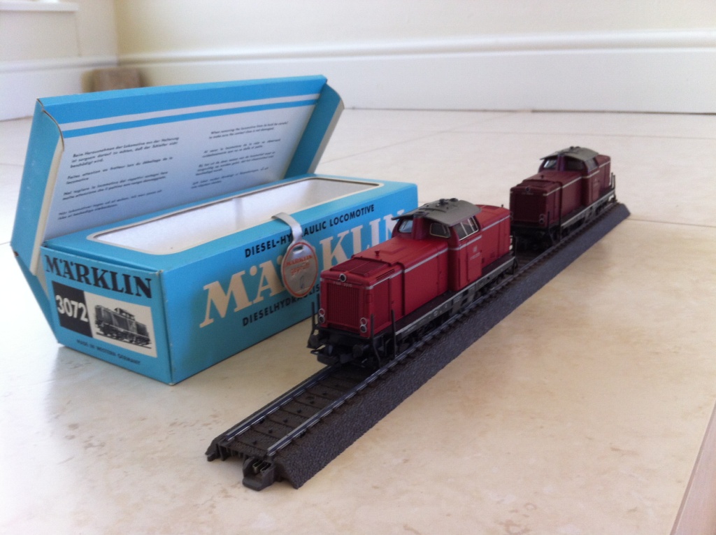

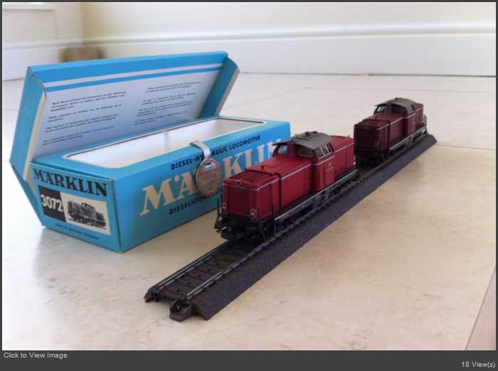

Some time ago, I converted a DB212 Diesel using a 60760 kit, using motor and decoder.
It was very simple conversion.
(Not absolutely sure what Marklin loco number it is)
I recently purchased another similar loco (3072 V100) with the intention of another similar conversion.
I was then surprised to read in this thread that it required a 60944 motor kit.
And indeed, when I opened the body, it does seem to require a 60944.
So, the DB212 has a different motor from the 3072. Picture attached, the front is the 3072, and the back is the DB212, you can see a slight change in colour and the road number is different, but the rest looks the same.
Can you please indicate more clearly which part of the 3072 you had to file down to get the 60944 motor to fit ?
Many thanksBigGrin
