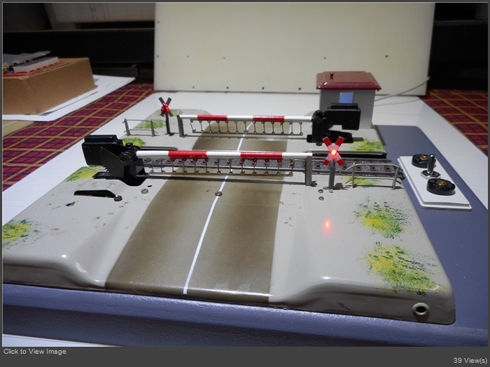

These gates were always a favourite of mine and they have been around for many years, a testament to a good design and sound manufacture.
My two issues were rapid speed of action due to solenoid actuation,and the fact that the solenoids had to be powered to hold the gates down. (250 mA or so.) When powered off, the booms simply returned to the upright position by virtue of the counterbalance weight.
I bought a set recently to have a look at with the idea of motorising them. Under the metal base the great quality of Marklin manufacturing was evident, everything well laid out, screwed not riveted and blued metal for the solenoid frame. A very easy job to remove the boom arms from above.

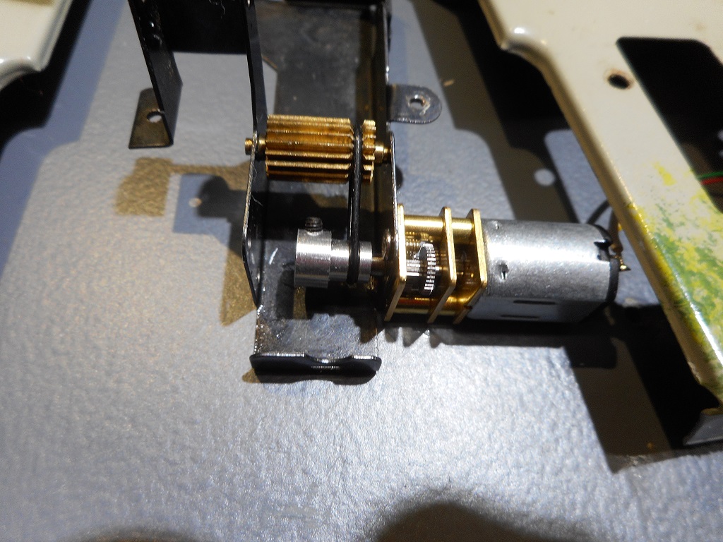

When the solenoids were removed which was simple, it was as if Marklin knew I wanted to mount motors to the frame because holes existed in the frame which lined up with the small geared motors I was to use. I had to drill a couple more to slip a small screwdriver through the frame to tighten the motor mount screws. The motors are 6Volt 30 RPM.

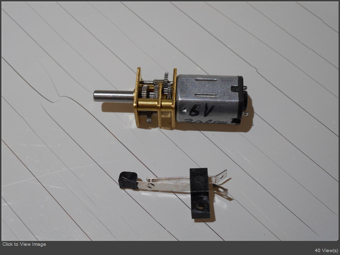

Next step was to make a small aluminium pulley wheel ( for both sides) and to cut a thin 2mm groove on the right hand side (facing along the boom) of the long brass gear which drives the arcuate gear on the boom shaft. I did both these on a lathe, using a thin flat diamond file to cut the groove in the brass gear. This did not harm the gear at all and it is still quite useable should I wish to return to solenoid drive. ( The arcuate gear meshes with the left side of the gear and the solenoid in the centre of the gear.) Marklin knew I wanted to use that gear! The drive from front pulley to brass gear is via a 10mm silicon O ring. The rear boom drive is via an 11mm ring to allow for a little slippage if needed. (The rear boom is set a fraction faster than the front to make sure it travels the full distance both ways.)
Two leaf switches were mounted under the metal base to arrest the booms at their limit of travel. A plunger was inserted in the support for the boom when down, and the other was actuated by the counter weight when it raised fully. I used the front boom switches to cancel both booms and made provision to synchronise the booms timing.

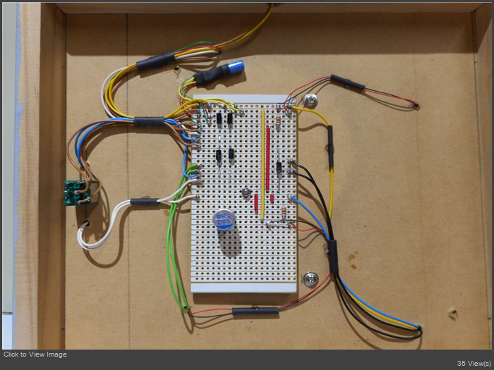

The motor control was 6 volts AC via two diodes per motor. This allows simple reversing of the motors via a SPDT switch and also drives the motors with half wave DC . This gives the motor 25 pulses per second and allows very low voltage yet still overcomes "stiction". I mounted the gates on a plinth as I couldn't use them on my layout. The switch would be best replaced on a layout with track detectors and a latching relay.
I added a flashing LED to each crossing sign and a light in the guard house as it was begging to be done!
After all this I made a Vero board circuit board under the plinth and wired it up. It all worked and then I realised I hadn't taken any photos ! Aaaargh! Sorry but I wasn't going to pull it apart.
Level xing 1.jpgLevel xing 2.jpgLevel xing 3.jpgLevel xing 4.jpgLevel xing 5.jpg
A short video
Thanks,
Howard.

I nerved up and took it apart to this stage without disturbing any wiring.
Hope this helps to supplement the description.

I found some drawings I did when I set up the gates. I have to do this to jog my memory later!
The top part shows the basic wiring using 6VAC and diodes to control the motors.
The two switches before the motors are normally closed leaf switches which stop the motors at the down or up positions.
The bridge and associated capacitor supply around 9 VDC.This is used to supply the two flashing red LEDs on the crossing signals (they are 9-12 V items) and the other LED is in the guardhouse.
The lower part shows the basic connections to trigger the gates using a single trigger input module.( the middle module in the photo below).

I used two of the 6Volt geared motors in the photos above, wired in parallel. I mounted the leaf switches under the base plate on an angle of aluminium.
A small screw from the base plate above held the angles in place. I did not have to raise the base plate at all.
The nitrile O rings allow a bit of slippage if one boom gets fully up or down before the other. I have not noticed this happening however.
By "arcuate gear" I mean the segmented gear attached to the base of the boom on each side. It is normally driven by the solenoid rack.
