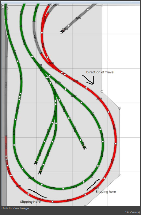

Did some tests on pulling power last night after breaking in the motor (15 mins medium speed in each direction with no load). The locomotive has four powered axles, two traction tires on the back axle as per Marklin's standard and a non-articulated chassis.
Results:
Can pull 15 Marklin tin-plate 4-axle US boxcars up and down a short 2% grade with no issue. I did not try more.
In a loop (approx 240 degrees), on R2 curves it starts to slip at slow to medium speeds (FS44 and under on the CS2) with more than 9 Marklin tin-plate 4-axle US boxcars. In this area of my layout the cars pass through a sort of S curve (straight section in-between), which is hard for this heavy US rolling stock (see attached photo of trackplan). Around FS56 on the CS2 it can pull through the curve fine, which is probably modeller's "full speed".
I think due to the axle arrangement, traction tires, and non articulated frame this is to be expected. The locomotive has a good weight, I don't think that's impacting traction (like BR41 3792 which is a little too light in the traction tire axle). I don't expect this locomotive to pull as much as a 3 unit dual motor Marklin F7 set. I think with plastic boxcars it would pull more, but I have no US plastic stock to test. I also suspect at R3 or larger this would not be an issue. 9 cars is still a pretty good express freight train for me. My layout intended for shorter German trains, I would plan R3 and larger on a US layout if possible.
Santa Fe all the way!
-Brandon
