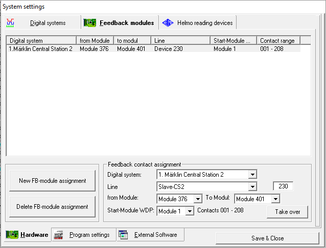

Hello Steve,
I have connected my 13 6088(0)'s to Bus 3 on the L88. My device number was 230. Voltage setting is 5 volts. To keep the contacts numbered from 1 to 208 I used start module 1 in WDP.
See attached configuration screen.
Aloha,
Elliott

Thank you Elliott,
Problem now solved....it was my feedback module not starting at 376 with Windigipet...Now all contacts respond accordingly.
Thanks for the tip..
