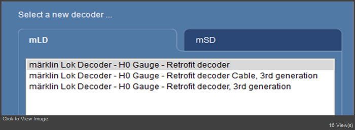

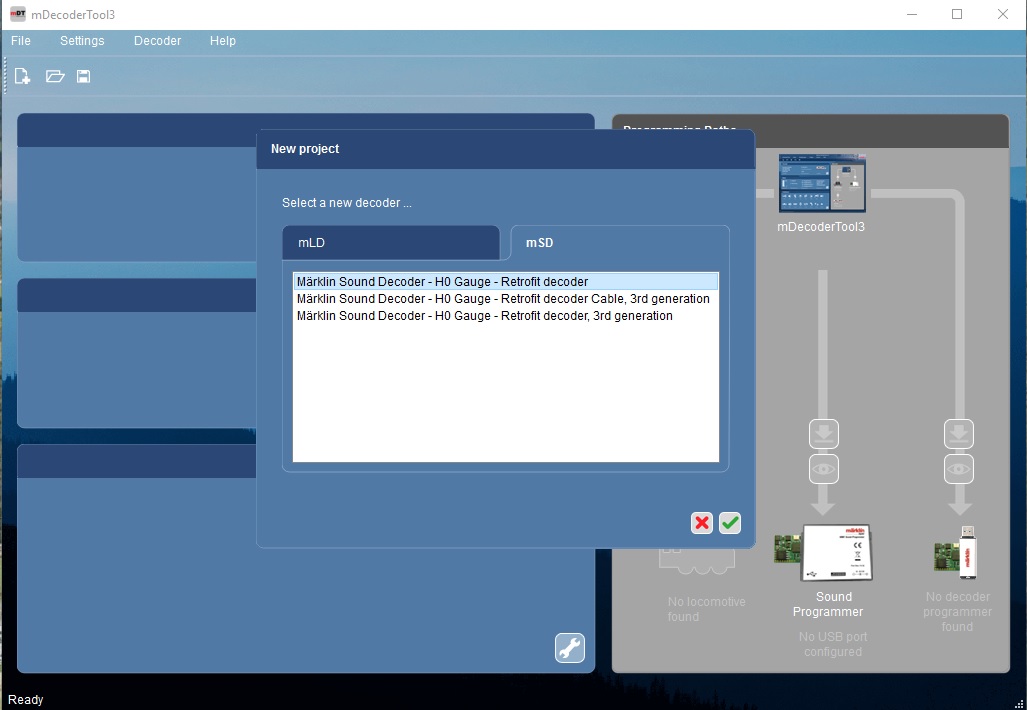

Can anyone explain the differences between the options on the 'select a new decoder' menu?
Does the first option allow you to programme earlier versions of mSD?
Michael.

Offline graafjp
#13 Posted : 03 April 2016 20:48:46(UTC)
graafjp
Joined: 16/04/2006(UTC)
Posts: 117
Hi Michael,
I did successfully program a mSD decoder (NOT MSD3) with the tool using the first option.
But I had to take some undocumented steps.
First create a project and save it with the MDT3 tool.
This wil give an .mdtp file.
Unzip this file (if necessary rename (a copy) to .zip).
This will give you a directory with the necessary files.
Put this directory on a USB stick in the \cs2\sounds directory.
Then you can update an mSD decoder by downloading the sound files on your CS2.
When trying to program the mSD decoder via the MDT3 tool via the connected CS2 I always get a file-crc-error.
Jos
thanks 2 users liked this useful post by graafjp
#14 Posted : 03 April 2016 20:55:34(UTC)
Posts: 11,166
I thought I would get the mDT/3 USB hardware from a local shop some days ago, but it was not in stock so I am now instead waiting for it from Germany.
From what I understand, the option without "3rd generation" should be for mSD decoders of the 6094x kind (mSD) while the other options are for the 6097x/6098x kind (like mSD/3).
Since the 60971 USB hardware has 2 kinds of decoder interfaces, I suppose the other 2 options are to be used with either the MTC board type of decoders or with the cabled 8-pin NEM type.
I would be interested to see what's under the mLD tab too, since I mainly will do conversions without sound...

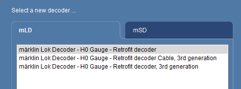

Juhan,
Options for the mLD decoder are the same:
Jos

The dealer I visited told me that there was a "quirk" with programming the mSD/3 decoders directly with the 60971 USB hardware.
He said that when you have made your stuff, you write it to the decoder and think that you are done. But after a while, the software
pops up a question asking you to confirm if you wish to program the sounds too... Ie programming is written in 2 steps, first the
decoder functional parameters and then the sounds as a separate programming step.

When using the 3.1.1 version you get a window asking if you want to program:
- Program Settings
- Program Sound
When you select both and click yes, programming is executing the two steps automatically without any pop-up for programming the sound.
Jos
Certainly not 100%.
At first look I would have expected that, give the 6097x/6098x distinction, there should have also been a 6094x/6096x distinction.
But then again, I would have thought that choosing a particular option (e.g. 6098x) would have filtered out those aspects it could not do (i.e. Aux output 3 and 4)
The description (.html) files just lump things together anyway.

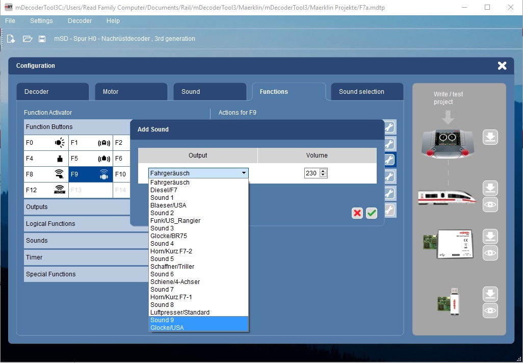

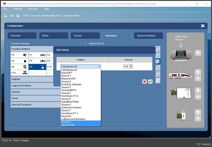

One thing I have not been able to resolve so far is trying to update the 60976 decoder with 'bremsen' or breaking sound. When I try to attach this sound to a sound 'key', the curser reflects a symbol indicating it cannot be attached. Not sure why;
If anyone has any experience with this?
Again, we are left to work all of this out ourselves because someone cannot write an instruction manual Cursing Cursing Cursing !
Michael.
Michael,
When adding a new sound select "Sound without output" from the drop down list, then you can add a breaking sound into the sound slot.
Jos

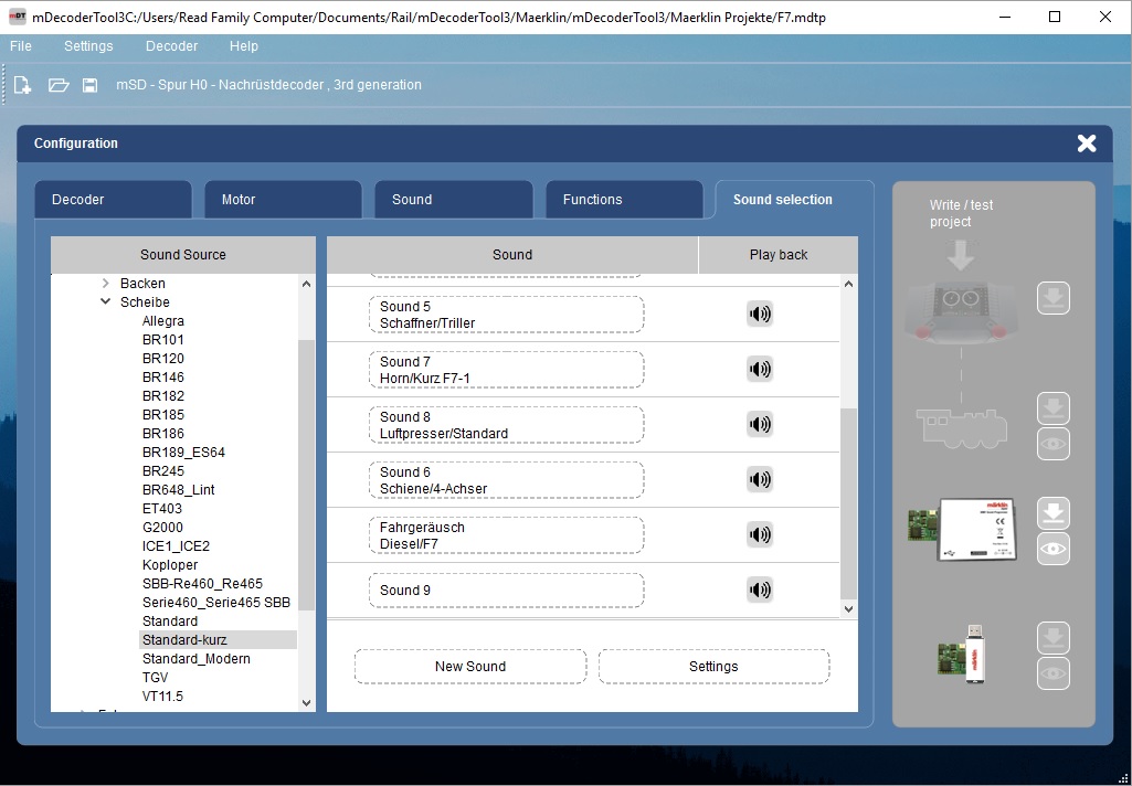

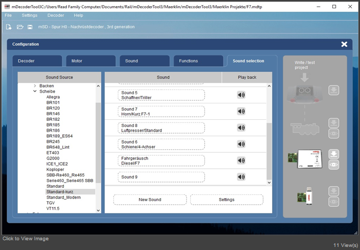

Hi Jos,
thanks for the advice. I did as you suggested and it appeared to work insofar as being able to move the selected sound across as per attached
but when I try to associate the sound with the function, the functions menu does not show the option to add 'sound without output'. Have I missed a step here?
Michael.

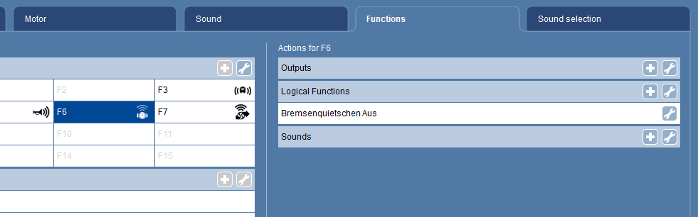

Hi Michael,
The braking sound is automatically on as far as I know.
You can add a function button to turn if off:
Select "Bremsenquietschen Aus (Brake squealing off) under the logical functions for the button you assigned it to:
Click on the + sign behind Logical Functions and select this entry from the drop down list.
Jos

This 60971 is a real dog. Apart from, as reported, bugger all English, it doesn't seem to work anyway. The latest software is 3.2.0 on Marklins site, but the English has gone backwards.
I asked my friend in Germany who knows this stuff backwards (he has 500 models and was a marklin dealer),
the 3 options (6 actually) are the top old mld decoder (programs on CS2 only), the middle option is the mld3 (msd3) with the 8 pin nem flying leads, the bottom is the 21 pin connected decoders.
Although the programmer is recognised on windows 8 it did not program my brothers sound decoder, couldn't see it. Now I have to check that he didn't have an older msd decoder, because the programmer cant program them. I have some mld3 decoders, so maybe those work.
My German friend was going to have a look at the documentation (he is in contact with Marklin engineers) and says if he has too he will translate the german to English, send it to me for checking, then give it to Marklin to publish. Given their software guys cant write a decent program that configures itself for ALL English , rather than some English and lots of german, the manual will need a translator anyway to tell what the german words mean.
This is a very poor effort on marklins behalf, but my friend who comes from Schwabia, jokingly said "its the Schwabian way, never quite gets it right".
thanks 2 users liked this useful post by craigshaw
I think you need to qualify what you mean by "doesn't work"
My 60971 is certainly capable of working. Is yours faulty ?
By The Way The 60971 is the mDP/3 (Decoder Programer) the mDT/3 (Decoder Tool) is standalone software.
While the mDP/3 does need the mDT/3 software, the mDT/3 software does not need the mDP/3 - it can work with the CS2

Peter,
The software installs with no problem. Inserting the programmer registers the programmer com port in windows (com3 in my case). Looking at the tool it sees the 60971 programmer has a com port assigned. Attaching a 21 pin mfx decoder to the programmer does not allow me to read the decoder inserted. Using the dropdown (Decoder) to look at the decoder the options are greyed out. Seems the program does not know that a decoder is connected to the programmer. The icon for the 60971 in the software never highlights the greyed out download icon. However, the other programmer icon (don't know what it is) has the arrow icon activated, but of course doesn't exist and therefore does not work. Hope that is a better description. The OS I'm using is windows 8. Tried 3.1.1 and 3.2.0 versions of the tool.
Craig
Offline craigshaw
#31 Posted : 04 May 2016 09:01:27(UTC)
craigshaw
Joined: 05/01/2016(UTC)
Posts: 6
Location: Australian Capital Territory
Peter,
I have now tried the programmer using V3.2.0 on windows 7 with the drivers downloaded from the Microsoft search. The 21 pin sound board only ever highlights the middle programmer in the program but doesn't work because there is no driver. I then tried an mLD3 on the programmer. The USB port came alive and I can read and "presumably write" to the decoder. So the program see's a non sound decoder but cannot see a sound decoder. The wiring to the programmer for both types of decoder is the same, the 21 pin goes to the screw connector pins. So the sound decoder doesn't work, I'm guessing. Will now try a wired sound decoder and see if that works. If it does the 21pin decoder must be defective.
Craig Shaw
