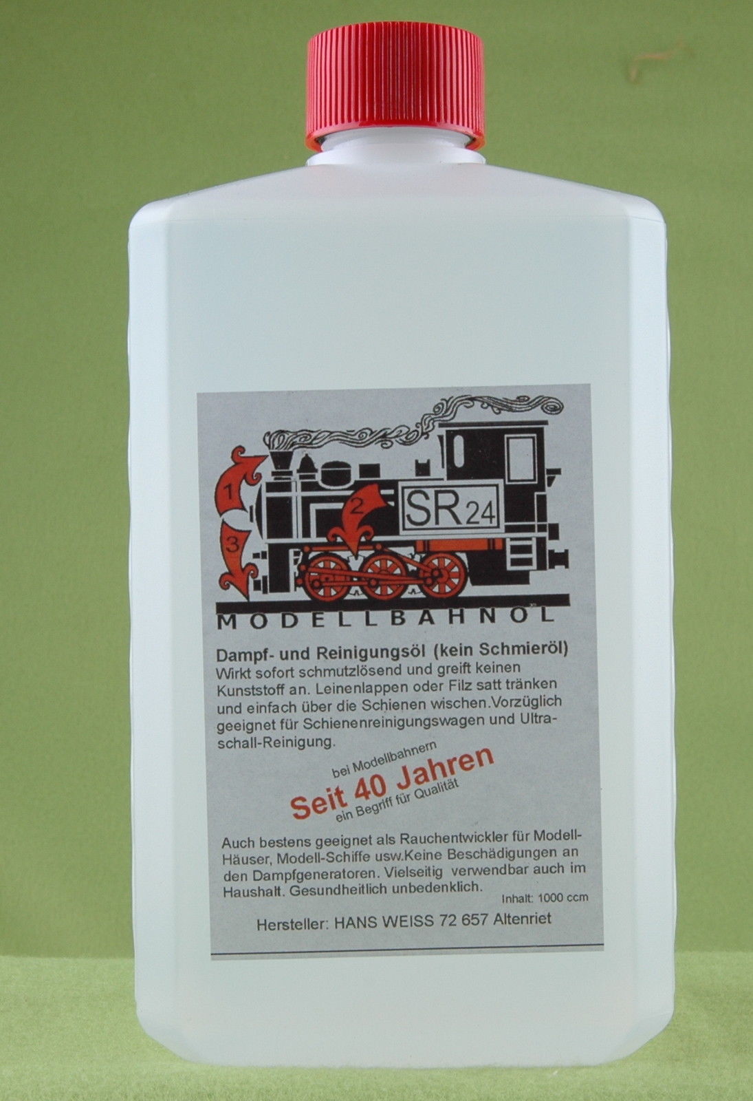

Hi baggio,
90 seconds sounds too short time to me but I run my steamers in analogue mode only
which I think uses lower voltage in the smoke unit.
After a smoke fluid dose is opened it also begins to evaporate so my Märklin 50ml dose
didn't last very long. So I bought 1000ml bottle BigGrin

Funny you should mention the SR24 fluid, BR, because on an Italian forum someone mentioned that very same fluid at a cost of 12 Euros per litre (about $18.00 CAD).
Much cheaper than the Marklin fluid, $29.00 CAD for 250 ml..
Is it available in Canada?
Offline Br502362
#8 Posted : 09 March 2016 07:18:23(UTC)
Br502362
Joined: 05/03/2014(UTC)
Posts: 717
Location: Finland
It's not available in Finland so I bought one from Germany.
Moba Petersdorf has worldwide shipping.
http://www.ebay.de/itm/12-99EUR...49ba9:g:-yAAAOxyaTxTRtt5
Åke
