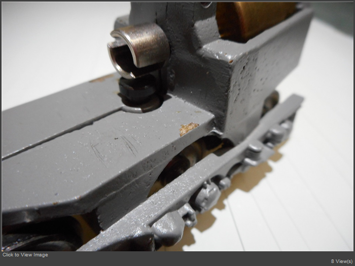

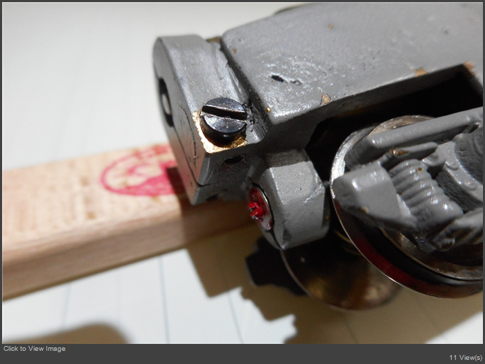

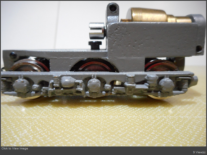

I remembered I had bought a complete drive train bogie with clutch etc from the US on eBay a few years ago for a bargain, to have as a spare part.
When I checked it, it was fine but to my amazement I noticed a yellow gleam under some small paint chips and lo and behold it is a complete brass casting.

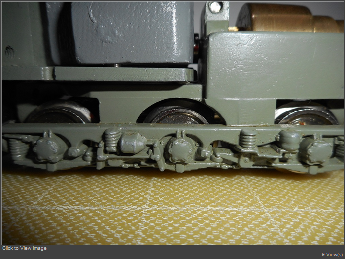

Has anyone come across this before? It would be no mean feat to cast brass at home and I am sure Pocher never did it. I have posted a photo and one of my loco's bogies for comparison. The detail is very good but the paint has been applied a little too thickly and has blurred some detail.

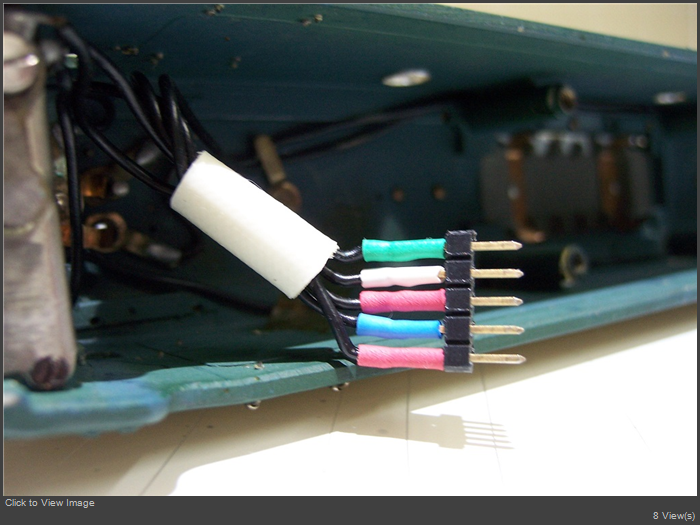

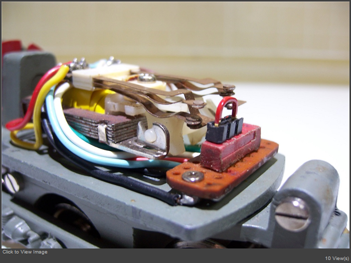

I have replaced the simple Marklin switch with the double change over type and built a small connector plate so I can easily remove the body. The jumper allows running with the top off. I have worked on an earlier CC7107 with zincpest but it did have Pocher's lovely mechanical reversing switch in it.
Otherwise it is a rather tedious job of undoing several small screws to look at the mechanism. I have retained all the original parts of course.

Hi Howard,
I remember that sometimes in 1990s such brass-parts were offered by someone from Belgium. Also a German offered reproduction-parts around 2005 but these were made of another metal and had a more detailed casting.
