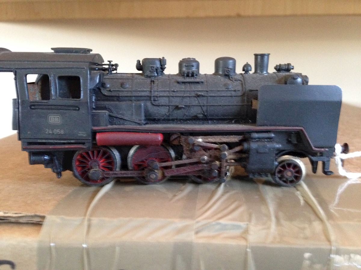

#10 Posted : 09 December 2015 23:38:03(UTC)
Posts: 8,717
Originally Posted by: JohnMishler Go to Quoted Post
The third loco is a 3003 DB class 24. This model is missing its tender
It is also pretty heavily 'weathered'. Hard to say if this is deliberate or just from being left somewhere where it has got very dirty. It should have a 3 axle tender.
The 3005 ray identified should have a 4 axle tender.
All the locos should be able to be brought back to operating condition, and i would do that first before trying anything else. Depending how much running they have had you may require new pick up shoes, and brushes, possibly gears as well if has not been properly lubricated as the brass gears are known to wear out with a lot of use.
#11 Posted : 10 December 2015 02:08:43(UTC)
Posts: 14,921
Ray, I had a look at my 3005 and found the picture and my loco are pretty much identical in the front, the front step is bent, a support arm from the frame to the platform is deformed or has come loose but I don't think the whole front assembly is bent., the frame does go down in the front towards the buffers., to bend this part of the loco would be highly unlikely as it is solid metal, so I would say obvious the tender is missing in the photo; the loco is for its age and usage in a pretty good shape unless I've missed something you can see I can't see.
the 3003 had a spray job and someone tried to weather it but hasn't fully succeeded and most probably you can't reverse the action without loosing all the detailed writings.
looking at all the locos most likely all of them need a good cleanup inside the motor but apart from that, I can't see any major issues and after a maintenance service they should run as new.
if you are intending to convert them to digital, it is possible and they are all using the same conversion kit (60943) which you can buy on their own or with a decoder included.
the conversion kit depends on wheather you would like a 5 pole highefficiency motor or a motor with the existing 3 pole motor and a perm. magnet instead of the coil magnet you need for DC/digital operation instead of AC operation (current set up).
to keep it within the period when they were produced the M-track would be the way to go but C-track has its advantages with a broader range of tracks particular sleek turnouts.
the other question which you haven't mentioned is how much will it cost you to buy the whole lot (I've just noticed you've bought the whole lot) ., my guess is it isn't worth more than US$ 250.00-350.00, taking into consideration buying these locos overseas including postage you could perhaps get them cheaper but again the amount of m-track and other components could come out with the same price.
there are signs the locos have been in a damp place as I can see the couplings being slightly rusty and this also could affect the armature axle getting oxidized with the metal frame, wouldn't try to run them without a thorough inspection first.
