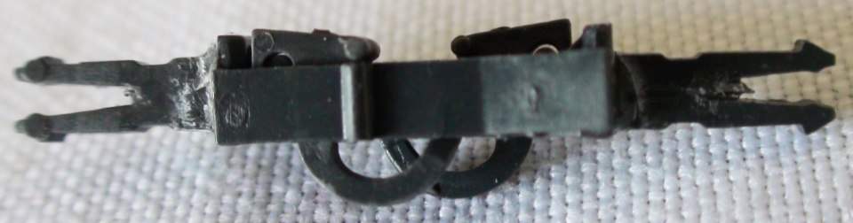

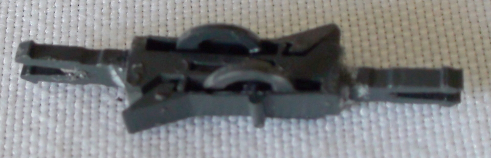

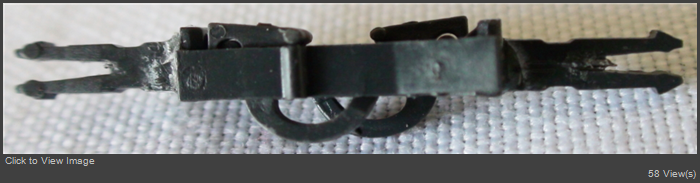

it doesn't look like an electrical coupling, this is an ordinary coupling if you are concerned why not use different Roco couplings ?
so far connecting all the carriages, yes it can be painful and this also applies to my Roco 4 pin electrical couplings sometimes you can slide them together but if this doesn't work you can ruin the whole alignment of the pins, hence I lay the whole train (as you've done) upside down and than carefully connect each carraige holding both coupling shafts, turning them up again making sure you don't have too much of an angle and I agree with you there is a danger of braking the coupling shaft. you need enough room to do this otherwise your chances of breaking it increases.
right I just had an other look at these couplings and the standing up not lying down. so an ordinary coupling wouldn't work, back to square one.
Ok another option is not separating the train, or get an ordinary coupling cut the end off and rotate it by 90° and superglue it. I've done similar ones whereas I've drilled a hole into the end bit just between the split tongue and drilled a tiny hole as well into the coupling itself and pushed a wire through and super glued it. it involves some work and craftsmanship.
I can make you some up if you like.
the Märklin ICE 1 had similar couplings but they had a male and female fitting and this was much easier to separate.

Stefan, the only problem with the Roco ICE couplings they are not horizontal but verttical

Why do you say that, John?
They go parallel to the wagon/engine, below the carriage. They are horizontal. Take another look at the diagram.
