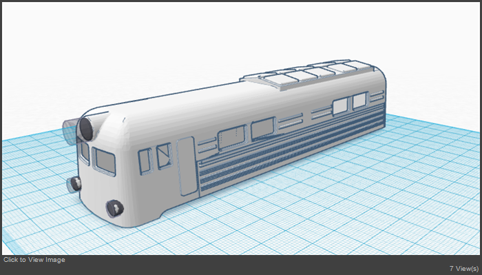

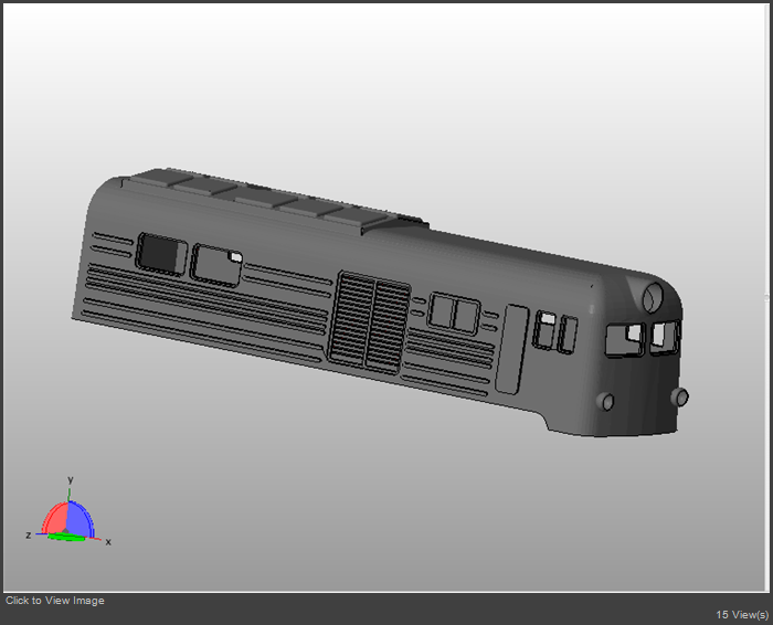

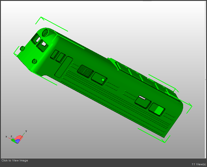

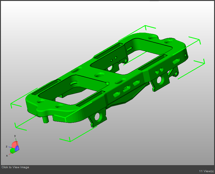

We are using a combination of traditional, and highly advanced modern manufacturing techniques to produce models of all Russian prototype. Our first model is the classic heavy hauler of the 1950s, 1960s and 1970s, the Vladimir Lenin 8 (VL8 - ВЛ8) in H0 scale.

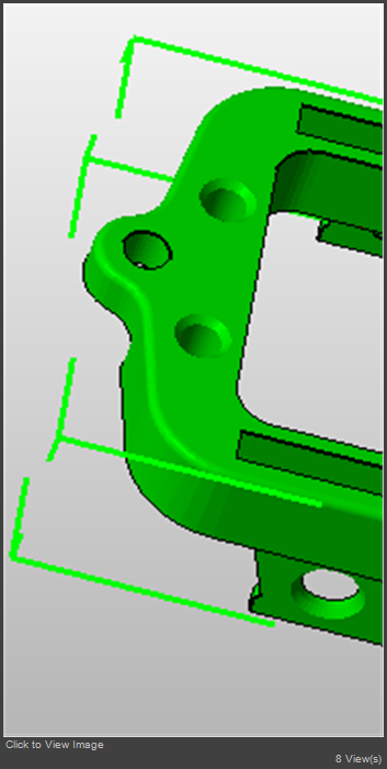

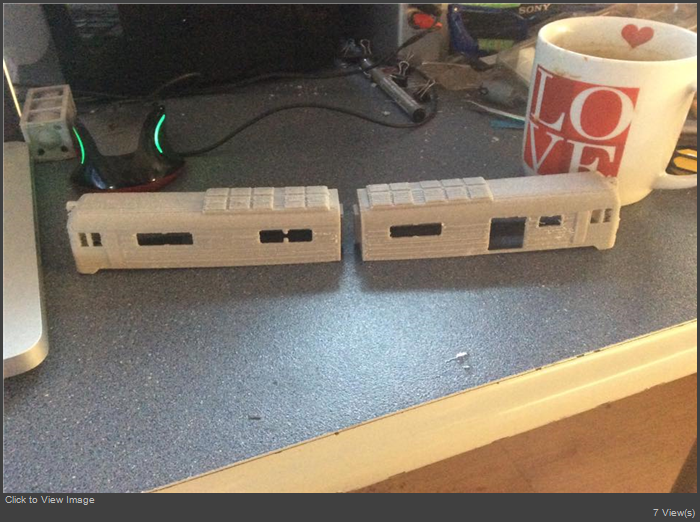

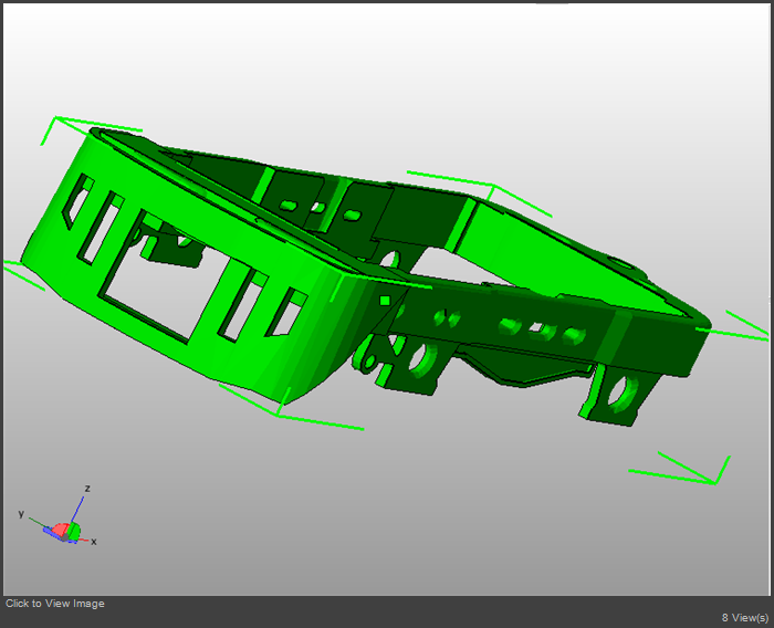

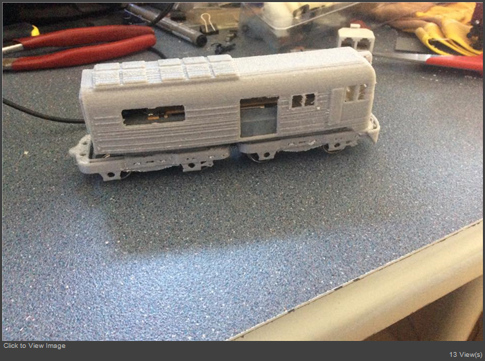

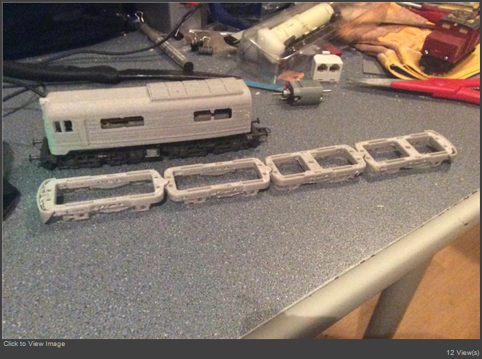

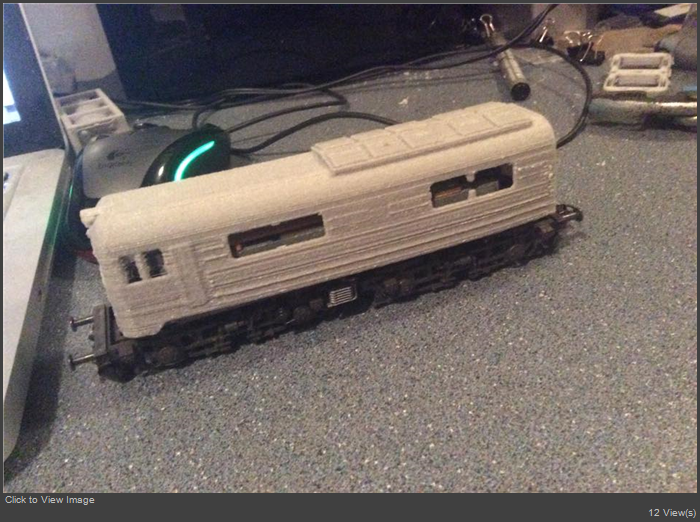

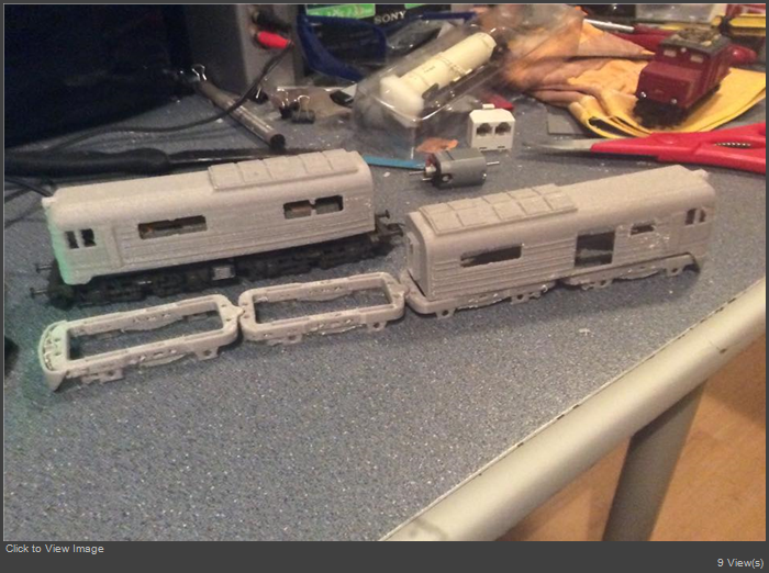

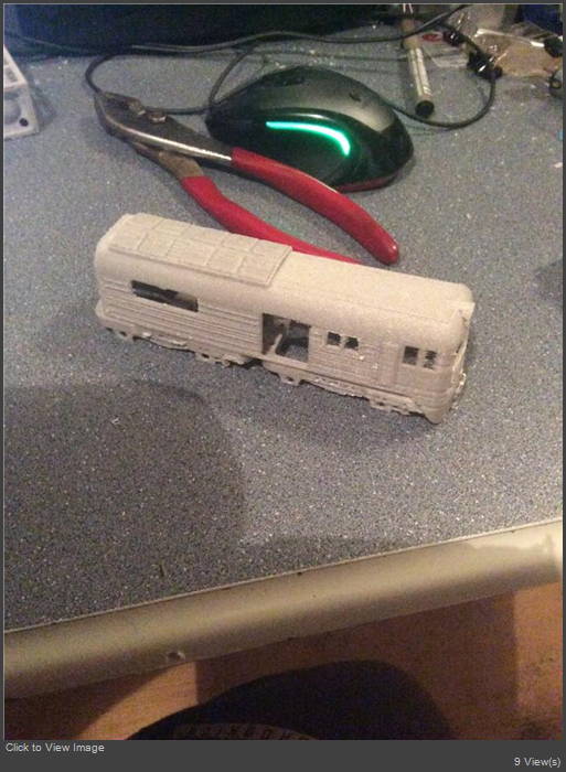

Attached to this post is some shots of our 3D model files as rendered, and also of the pilot model which was printed today, and mounted on a Roco E44 donor mechanism. As you can see, our pilot model certainly needs quite a bit more work, it is not indicative of the final models quality - final models will have a far HIGHER quality!
Your choice of livery, body styles and associated relevant works plates, and options of couplers and ESU LokPilot DCC decoders fitted. Units will be powered by a high quality, high output German Buhler can motor, drive and pick up on all eight wheels of the powered "A" section, a weighted second "B" section, warm white LED headlights that operate in the direction of travel and non-functional pantographs.

It'll be 2 rail. I don't do AC.
The radius - 360mm - I think its probably far too small for what is essentially, in 1:1 scale, a 27,000 odd mm long machine. I haven't gotten all my production specs just yet, I'm only running it on a rolling road. The key balance here is the size of the two body units over the rear of the units coupled together - too close, and you'll need a very large radius. Too far away, and they'll look unprototypical. As seen in the photos, the bogies of both "A" unit and "B" unit will be articulated like the real thing, and not coupled with a "traditional" coupler (NEM/ Kadee/ so on). These things were never designed to run as individual units (unlike 2TE10U or 2TE116 diesel locos).
Those are the shots of the "A" unit on a Roco E44 test chassis. I've not done the adjustments for the "B" unit yet, or gotten the materials for its chassis. Those grey bogies will be printed in black ABS this week coming, and fitted to the "A" unit. I'm waiting on my production house in Sydney to get back to me with second stage test shells, which will also be 10mm longer than those printed shells in the photos - long weekend here this weekend gone, then I learn he is jetsetting to Las Vegas for CES. It appears he owes me a favour in any case.
