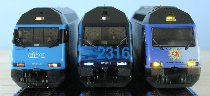

I have a Re 460 from Roco, but without sound and bought a few years ago.
This pictures shows HAG, Roco, and Märklin (left to right):
My HAG loco still uses light bulbs - current models use LEDs. Closed front skirt for HAG loco must be bought separately, Roco and Märklin include it.
My Märklin loco still uses yellow LEDs - current models use white LEDs.
I think the detailing is nice with all three locos, but Märklin paid very little attention to the interior details. The Märklin model comes with DB pantographs - the photo shows narrow wipers that must be obtained separately if you want them.
