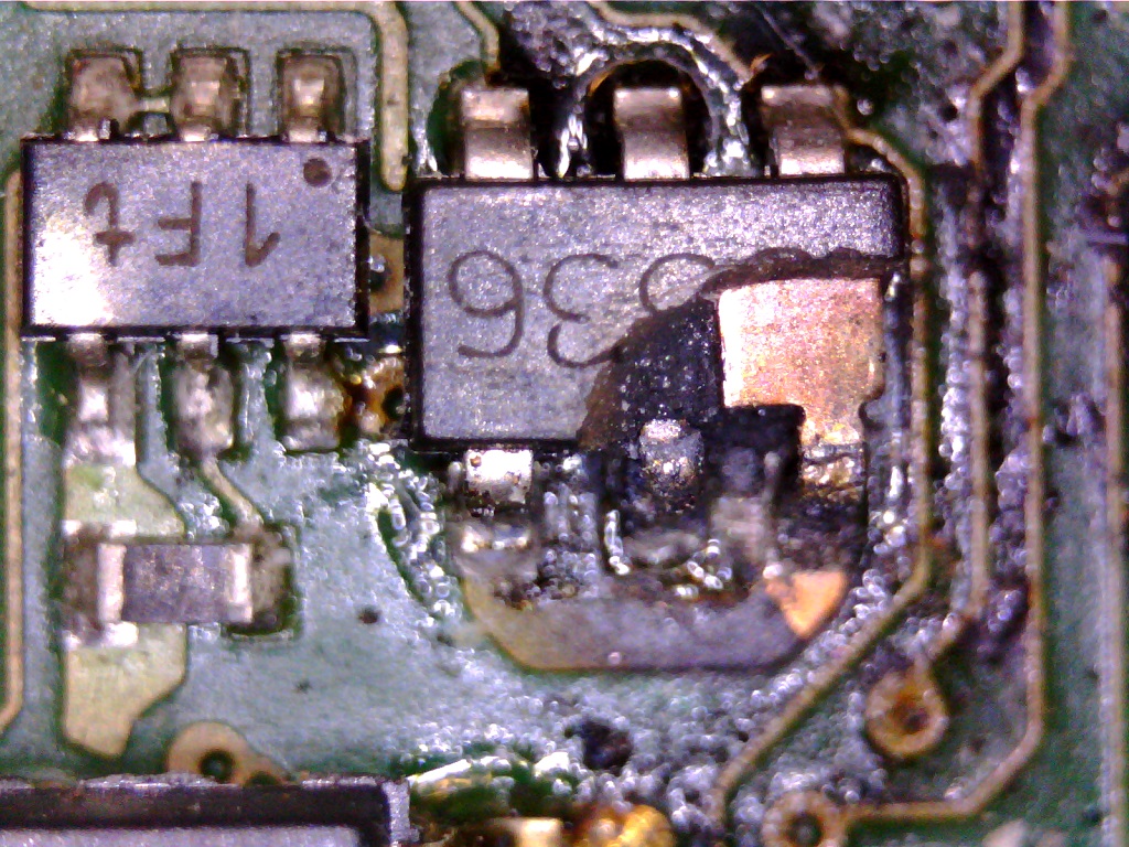

These images show the exploded component which is an smd voltage regulator number 3336. I have found them for sale quite cheaply but the whole board is about 55mm long and the solder tabs are fiendishly tiny. I have repaired boards in the past but I think this one is beyond me.
Anyone know someone in Australia , preferably Brisbane who might be able to sort it?

Are you sure they are voltage regulators? i doubt it considering the number of them on there - 8 in total by the looks of it. Components that size often have numbers that are unrelated to the actual part number on them, and you need to refer to a datasheet for a likely part to find out what it actually is.
My suspicion is that they are the transistors that drive the motors, and possibly something has happened to the the motor that it drives, possibly the commutator needs cleaning.
I'll be surprised if that is the only device to have blown up, I think you will find at least one other will also have failed, just less spectacularly (it is a typical problem with circuits that drive motors). It will really require someone with good electronics knowledge to repair this board.

Hi and thanks for the advice. They are almost certainly output transistors and I made the error of not counting pins! I will try and source them locally.

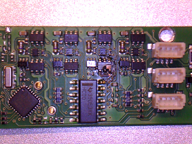

Howard I spent about 10 minutes searching and came up with nothing on those 3336 numbers.
And worse still, I plugged the other visible 393dEX IC from Texas instruments into the mix and again came up with nothing.
The miserable sods have used coded unlisted ICs throughout their design to prevent copying or repair attempts in this case.
If I had the time I would plug the board back into circuit without the motor loads attached and use a CRO to determine what is being fed to the 3336 pins to determine whether they are using logic or analogue control and the voltage level of the suspected push/pull 3336 IC's. Only then can you begin a search in say RS components, element14 or Mouser.
They are not going to be a complex IC as obviously they have no thermal overload protection.
A nuisance and unnecessary as the Chinese can De-engineer these boards very quickly these days if they want to copy them!

I don't think so, there is 'HC00' under that, which to me means it is a 74HC00 device. It is the right size package, and I wouldn't be surprised to find it being used to either gate signals to the output drivers, or just used as a buffer to get higher drive for the output transistors.

I have managed to get an idea of what this component is. I think it may be a Motorola digital transistor MUN5311DW1T1 series. Unfortunately this series transistors have different internal resistors and if it is the right component series I still can't tell which version. At least it has the correct pin out SOT-363.
Still up the creek.
