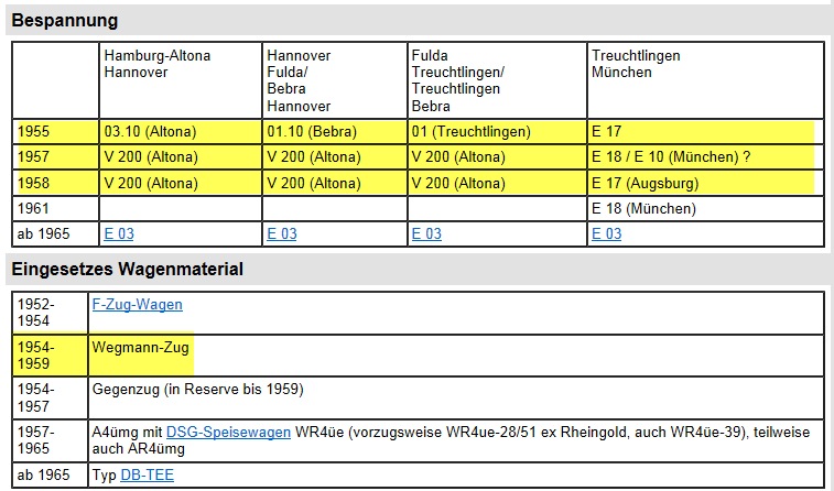

The locos V 200 001 to 055 were ordered prior to the introduction of the DB emblem. Therefore they received the large lateral aluminum lettering „DEUTSCHE BUNDESBAHN“. As of the mid-1960s, the lettering was replaced by the DB emblem. Serial production started in 1956 (first trial in 1953). Thus, the scene is set between the mid-1950s and the mid-1960s.
As determined in a parallel thread, the Blauer Enzian is one candidate:
Source: http://www.heinrich-hank...sezuege/blauerenzian.htmtable.png
