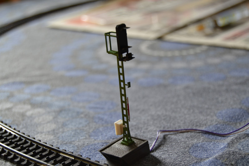

I decides to start this topic by present reviews about Märklins new light signal.
Nobody other does care to present reviews about accessories in this forum.
Okey...
Nice package and easy to open.
Lot of candy inside by follows with the signal.
Decoder do have very small dip switches,so you need an magnifying glass and very small screw driver,to change dip switch.
It´s very nice details of the light signal.
The simulate box on the light signal looks like plastic,so to painting needed.
After i did test function,i will weathering the light signal.(pictures shows up in another topic)
What about disadvantage?
There is no parts to order,if the mast brokes and decoder stop in function or burn up.
However there is 2 years warranty,so you won't be afraid to get an new package.
Save the receipt!!
Without it,you can´t use the warranty!
I enclose the pictures here.
More pics later,after i did tested the light signal.
Goofy attached the following image(s):
thanks 7 users liked this useful post by Goofy

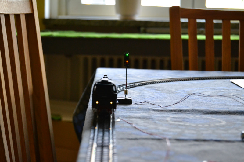

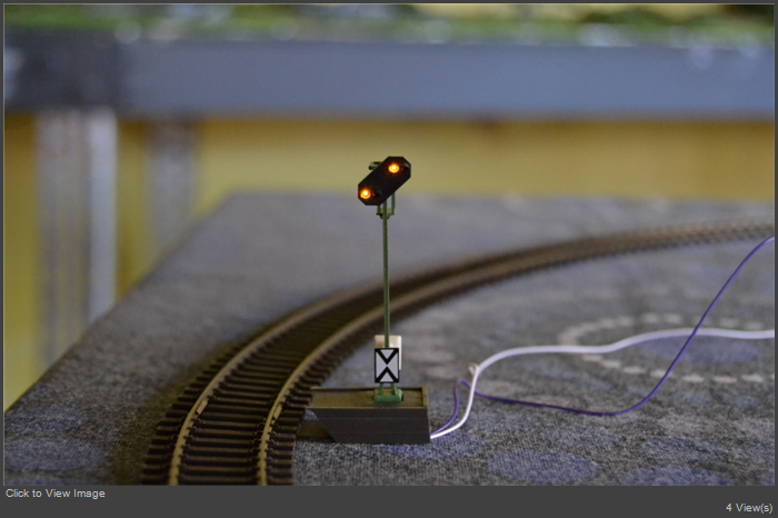

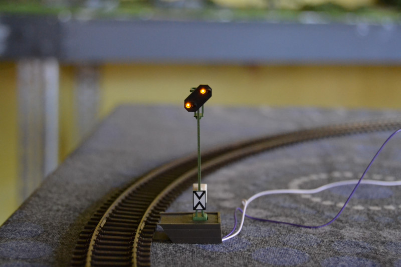

Okey!
I did tested mfx signal and it works excellent! ThumpUp
I did decides to use DCC protocol and program by adjust CV value.
First to use an ghost locos adress and i did choised number 13.
Also this with DCC protocol.
Before to start programming,i did first change dip switches by use number 10,this to use DCC.
Second to use number 1-3-4 as adress for the signal.
Power must been shut off before to change dip switches!
I did programmed with CV 48 and 50,by change switching duration LED on/off and Cross fading behavior.
I choised value 1,so it simulate like prototype perfect.
The only i don´t like is sun shields,it protrudes too far out,so you can not see the lights obliquely downwards,but rather at the same level you look straight ahead.
I will change it,by shorten sun shields.
What about the brake section?
It works.
You can use signal brake modul in two difference way,by use Märklins for the Märklin locomotive and Lenz BM1 for the locomotives with the ABC-technik(only for the two rail).
I enclose few pictures here.
thanks 6 users liked this useful post by Goofy

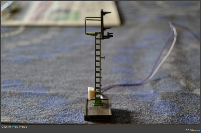

#10 Posted : 01 June 2015 08:43:56(UTC)
Posts: 9,278
Thank you for the respons boys!
I enclose closer pics of the signal.

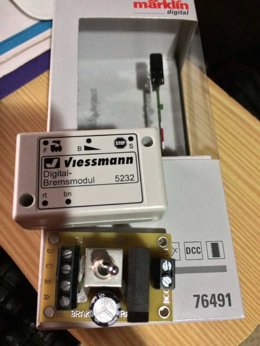

#19 Posted : 07 June 2015 14:34:38(UTC)
Posts: 9,278
I shall try to get one Viessmanns brake modul 5232 to test with the mfx signal.

#21 Posted : 08 June 2015 17:43:04(UTC)
Posts: 9,278
Originally Posted by: Hackcell Go to Quoted Post
Now I'm wondering if the signals working on DCC will work with DCC braking modules.... Besides of trying with a viessmann MM braking module, I'll try to wire it to this ddcbitswitch braking module.
I hope it doesn't damage the signal...
Viessmann says brake modul works only for the MM(connection red and brown).
But it seems it should do same way with the DCC...?
It will not damage light signal,because connection(two wires of the red) works separately(switch relay) in the decoder.

Hi Goofy,
In theory the only difference between the braking modules is the DCC bitswitch will send a Zero packet signal (CV4 compatible) while the Viessmann just applies DC power instead of digital DC power.
Danilo Jiménez

Posts: 9,278
The two red wires can been connecting with the MM or DCC.
Either you use Märklin or Viessmann brake modul,you use MM.
With Lenz asymmetrical brake modul(ABC brake),you use DCC.
The only you must think about Lenz,is to use locomotive decoder which supports ABC brake too.
No problem with this to use Märklins new light signals.

Posts: 9,278
My new distance light signal works fine. ThumpUp
I was forcement to cut down the sun shields,to see better with the LED´s lighting.
#25 Posted : 29 June 2015 20:10:44(UTC)
Posts: 9,278
Okey...here is few pictures.
It works fine.
