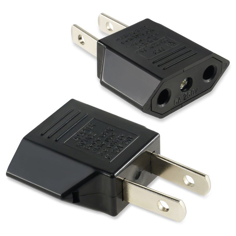

I'm going to the United States this summer and I'd like to get some trains to use there.
Can I use U.S. type AC plug and plug the small end into to rail box item 60113 with the mobile station 2 and have the thing work fine?
If not, how do I get it working? (Complicated ideas accepted.)

I'd buy a wallwart (power supply) for 120 volts and use that with 60113. You can buy it from Märklin (toy power supply) or from third parties (universal household power supply).
Users reported that the Märklin 230 volts power supply does work with 120 volts also. But there is no guarantee for that solution. I don't know whether this is safe or brings substantial risks.

If you have a 66361 switched mode power supply, this is all you need to run your trains with your MS2 setup in North America
Sure, it may not be officially endorsed by Mä, but it works fine, we have been operating our trains and MS2 sets for over three years now here in the US without problems. For responsible adult use, I have seen nothing unsafe or risky with this solution.
The DC voltage output of the 66361 is 18V whether using 120V or 240V, not complicated at all...

As mentioned, it is likely you'll just need a Euro to North American plug adapter for the 66361. When I did this, the MS2 reported 18 volts.
The summary of my findings is at https://www.marklin-users.net/fo...2-starter-set#post501585 which also mentions the alternate power for MS2 thread.
