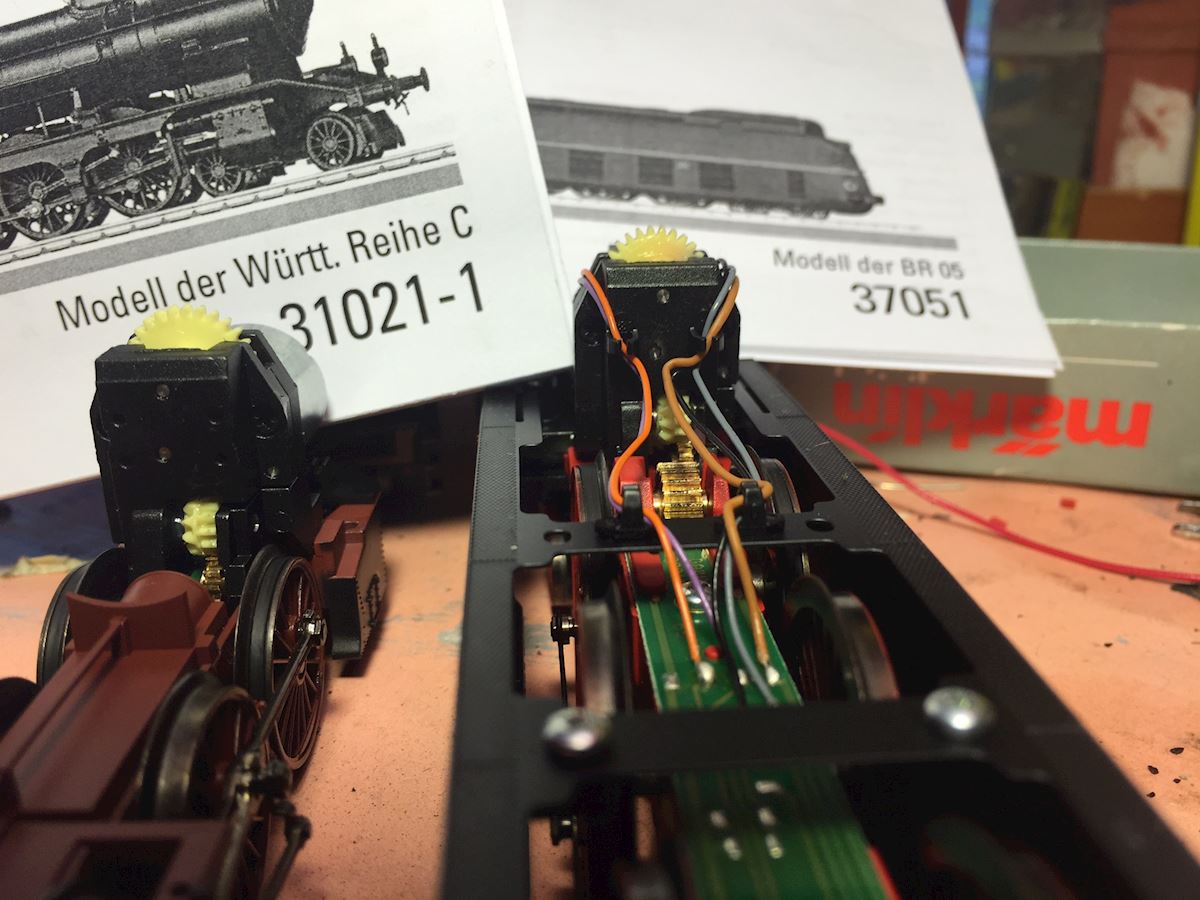

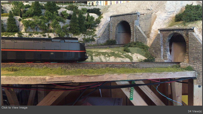

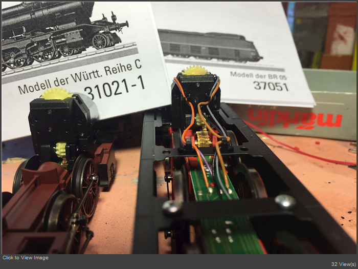

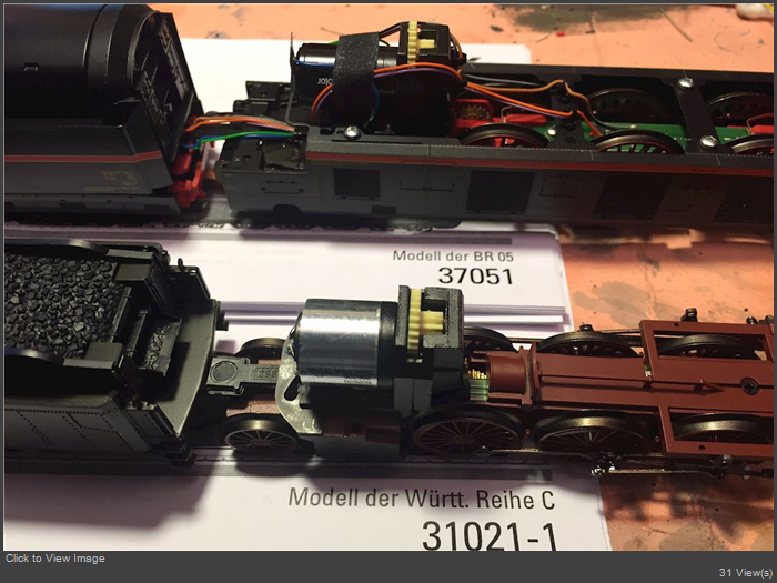

Update: Put another new locomotive on the layout and discovered this locomotive, 31021-1, had the same problem when pulling a 6 car passenger consists. Have taken some photos of the involved locomotives. Discovered the gearing is the same coming from the motors. These are the last 2 of 3 locomotives I have purchased and are the first to exhibit this behavior on my layout. Additionally I believe these are the only locomotives I have that have this motor/gear set up. Additionally a friend brought over his 37051 and we discovered that the drive wheels on his turn just as easily. Unfortunately did not have time to run his 37051 on my layout.
craigericks attached the following image(s):
Marklin:CS2 and TrainController Gold v10

Plastic gears...... sad, sad, sad...... it may reduce the noise a bit but........ SAD.Crying ThumbDown Sneaky
Plastic gears have a long tradition with Märklin. I remember seeing plastic gears in the '70s, but don't know when they were introduced.
I think the earliest loco I have with a plastic (nylon) gear wheel is an SEH 800 (3013.4) Dutch Class 1100, which was made in 1963. Earlier versions of this particular loco had all metal gears, and this use of nylon was the latest technical innovation at the time.
I don't really see a problem with using plastics in the drive train, as long as they are well designed and high quality. I don't know about the durability of my 3013.4, as, of course, it is still brand new!

Here is a photo of the 37051 at the point the problem, accelerating while at a set speed using a CS2, begins. The slope is approximately 8% or 15mm/188m at this point or 20cm/240cm over the length of the grade. I guess I must consider myself very lucky to not have experienced this problem until the 68th and 69th out of 70 locomotives hit this slope. My next layout will have a helix to get me down to the hidden yards. The helix I have made works fine in getting my trains to my wall shelves.
