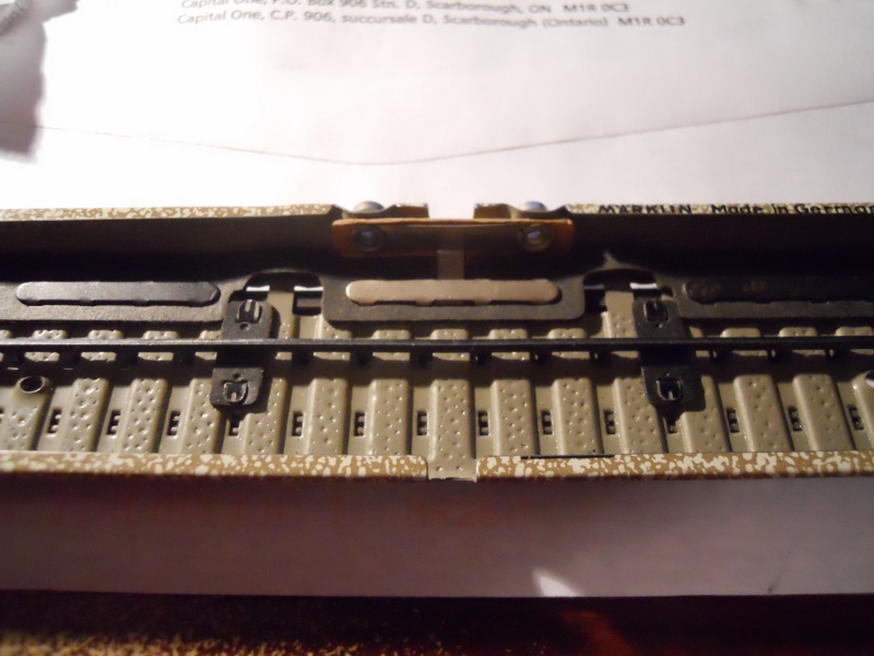

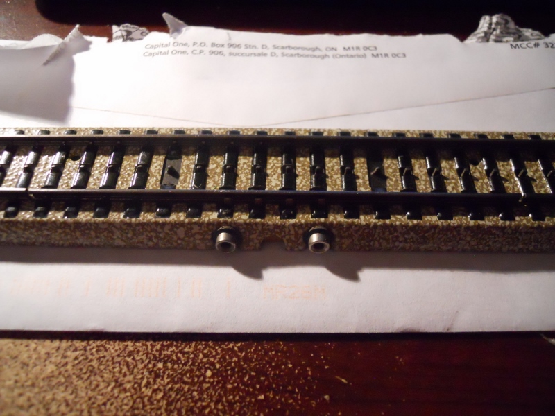

Hello Bob,
What you are looking for is Marklin M-Contact Track # 5105 it is the same length as a Standard Straight Piece and has a short Insulated outer Rail, see Picture
Hoffmann attached the following image(s):
marklin-eh

If Bob is setting up a programming track as he mentioned in his first post, the track that you refer to will NOT be of any use.
That track has a small section that is isolated from the rest of the metal and track so that when a uninsulated wheel passes over it, it completes the circuit and can be used to activate a relay (e.g. for a road crossing or signal). This track will not interrupt the voltage between one end of the track and the other.
If you want to separate a programming track from the main line, you need to isolate the centre rail as I described above. You do NOT need to isolate the rails from each other.
My solution above offers the best transition from main line to programming track and there is no need to isolate the rail sections as long as the third rail is isolated. The danger that I mentioned of a voltage spike when the slider contacts both main line and programming track can be averted by using the two signal zone between the two power sources. This can equally be done without signals by simply setting up an independent power supply for the isolated section that can be powered by either main line or programming track with a two way switch (Main line - Programming). to avoid direct change from one to the other.
http://ecx.images-amazon...images/I/418dqHr1p2L.jpg
If I am missing something here, somebody please explain why you would need to separate the rail sections (isolate them from each other) to use a programming track? I have not worked with the Roco controller, but if using it to run DCC on Maerklin M- Track, you should be able to have a common ground without danger.
If it is required, my recommendation would be to use a M to C track adapter and then snap off the appropriate contacts at the C Track end of the rail. If you want, you can then connect back to M Track on the other side of use C Track for the entire programming track.

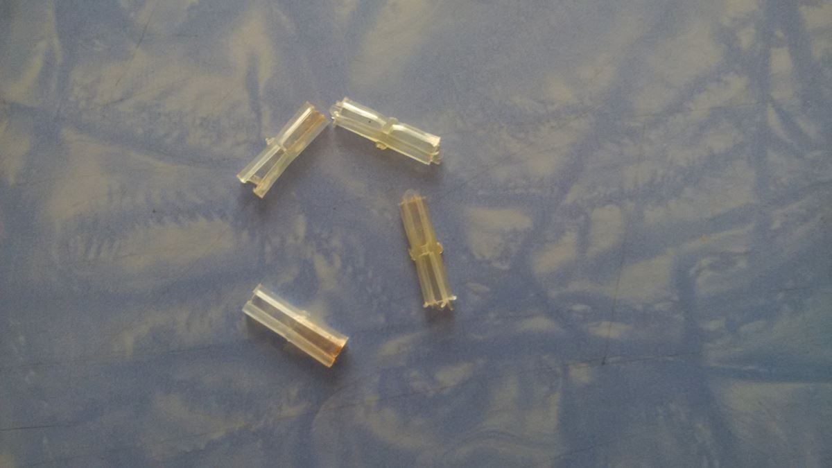

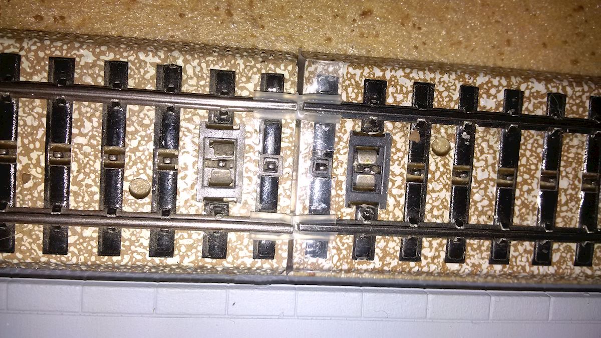

Hi Bob,
I have done this by using 2 plastic rail joiners to isolate the outside rails. I then cut a small piece of hard plastic ( I just used a piece of the hard plastic that come wrapped around everything we buy today) and inserted it between the 2 sections of track. This completely isolates the ground. You know how to isolate the center rail. I then installed a 2 way switch so that in one position normal track power was provided but not programming and in the other position programming but not power. This way you will never have the programming and track power on at the same time to this section of track. I will attach a couple of pictures to show the rail joiners.
