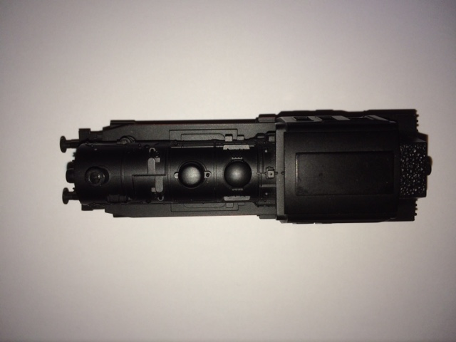

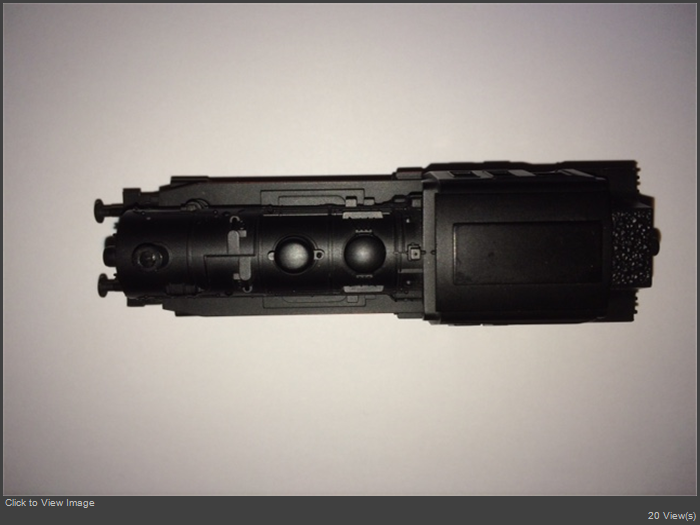

I have a train that is not responding to the controller. It just runs backwards, will not slow down and the light will not blink.
I have tried to clean the bottom and the wheels with nail polish remover, but that did not help.
I have some pictures of the train, but I do not seem to have enough privileges to upload pics ( maybe after I press the post button?).
Doe anyone have any advice? The casing seems tricky to open as there are no visible screws on top.
Thanks.

#2 Posted : 25 December 2014 16:42:50(UTC)
Posts: 8,508
Thanks.

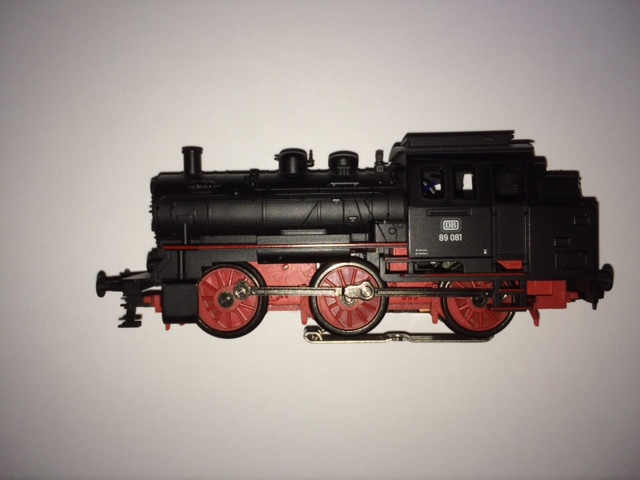

That loco is from a start set. It was a Chinese made chassis (similar to the Thomas and Percy locos) with a European body on it.
It sounds like the decoder has died.
The body is probably just clipped on. See if the sides will spring outwards and unclip off the chassis.

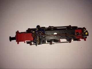

Offline kentchov
#3 Posted : 25 December 2014 17:58:59(UTC)
kentchov
Joined: 25/12/2014(UTC)
Posts: 13
Location: ZURICH, ZURICH

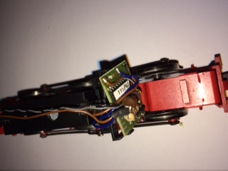

You are right, I managed to unclip the chassis. How can I check the decoder?
Everything seems to be ok, except for the fact that the circuit board in the middle is not sitting inside its holder, but that could be because I knocked it out when I opened it up.

#4 Posted : 25 December 2014 21:06:09(UTC)
Posts: 11,165
As this is a start set loco, is it digital at all?
To me, it sounds like it is running as an analog loco on digital track, ie uncontrollable and at one speed only.
What control are you using?
Is there a way to switch analog/digital on the loco decoder?
Does anyone know what set it comes from?

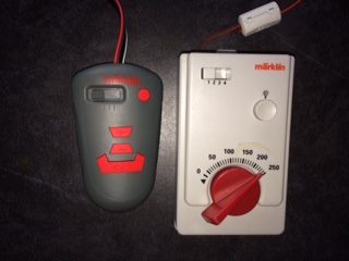

Here are the controllers that I am trying.
How would the factory reset work? I am not sure if the equipment I have support this. All I have are these controllers, power supplies, and tracks.

You will not be able to do a factory reset with either of these controllers. They are both very basic controllers designed for the entry level start sets.
I don't think doing a factory reset will solve anything either. I believe your decoder has had an electronic failure which means it cannot control the voltage to the motor, which is why it takes off at full speed and the lights do not work.

I have never seen a controller like the one on the left, but the right hand side one is a Delta controller.
Janne
The one on the left is the 'new' delta controller. The slide switch at the top does the same function as the loco selector on the old delta controllers, and selects the same four addresses.
I received one of these controllers with the set I bought from Aldi. It is soldered to the track connections, and has a 'wall wart' power supply. See my pictures in the thread on Aldi selling Marklin start sets that ran in late November through early December.
