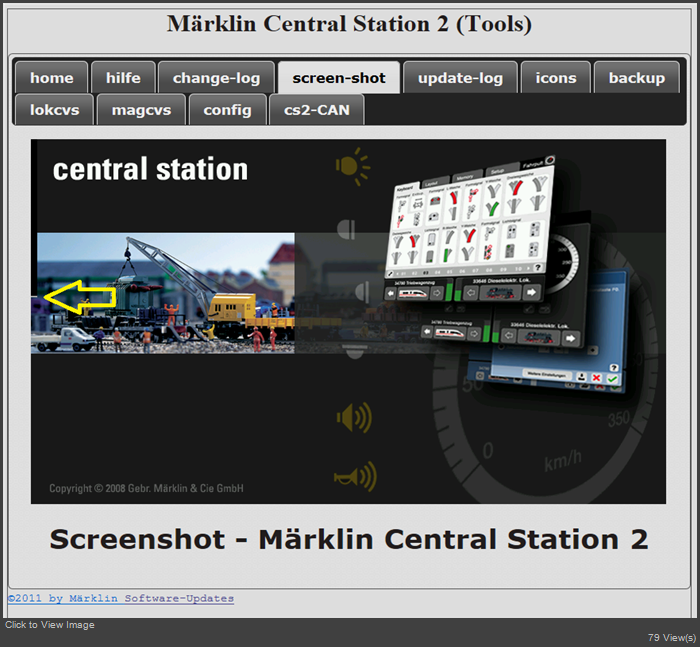

Three months later, I saw on the Maerklin-site announcing the release of an updated software version to 3.8 and decided to update the software.
I connected the station to the computer network, the Internet, turned ON and began to expect, when the station loaded, watching the screen.
But the station was never loaded. The boot process started as always with the slowly flashing of a large STOP-button.
Further, the flashing continued with acceleration, and further, the flashing stopped,
and on the background of the splash screen in the upper left corner of the screen appeared the sign of the cursor (like on the computer screen in console mode).
Then, after some time, the cycle of flashing the STOP-button was repeated and the cursor down one row. And so on.
I am attaching the screenshot: ScreenShot_w_cursor.png, which shows the cursor position after some time.
I decided to leave the station in this condition for a few hours, but the situation has not changed. And I tried to analyze what was happening.
I was convinced that the station receives an IP address via DHCP, and the built-in WEB-server (Maerklin CS2 Tools) successfully starts.
It means the operating system is still started and the problem may be in the starting settings of the application or in the application itself.
I looked at the tab - Change-log - into CS2-WebTools and saw the notice:
... momentan nur im Betatest: GUI Version 3.8.x (ab August 2014 im Betatest) ... screenshot: Change-log.png

AlekseyV attached the following image(s):
