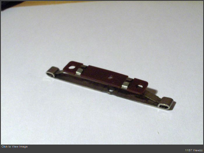

Märklin old 7173:
Märklin old 7173:
So a same sized pickup shoe has bee used, but without the wide insulating part.
Both used the same recipe : solder the power wire directly to a 7185 pickup shoe.
Marklin 7185:
Marklin 7185:
This eliminating the thin fragile and breakable original contact plate between chassis and pickup shoe.
I did not know what was this contact plate .
Because I wanted these locos to be as closed as possible to their original set up
and because of the availability of a new corresponding pickup shoe 201570,
I started some small investigations on the original replacing parts of these models.
Searching "Kontaktplatte" on the web, I finally found some parts:
Tell me if I'm wrong, this part is designed as "20087"
Märklin old 7173 and corresponding contact plate:
Now the new 201570 pickup shoe:
The new 201570 pickup shoe:
So I've luckily found on Ebay two of these old contact plates.
And now you can see my two happy locomotives in their almost original set-up:
See how the thin contact plate is bending only with the pickup shoe pressing upon...
My Primex 3008 :
My Primex 3008 :
My Märklin 3012:
My Märklin 3012:
Hoping it will help...
Joël
