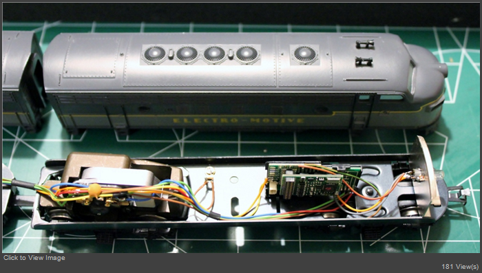

I have now successfully converted my 3349 Electro Motive F7 diesel Engine with dual motors using the following:
2pcs 60760 kits (Only using the motor parts, not the decoders)
1pcs 60976 kit (MSD3 diesel sound decoder 11-pin)
The loco signed in from the programming track, but it took like 10 minutes Before it was ready. Sound started first, but the motors didn´t start.
After that all was fine and it worked like a charm. I see no problems with the load correction or other motor features which possibly could have suffered from twice the normal load. ThumpUp
I did a video tutorial, but it´s still in editing. Will publish it here once ready.
Regards / Martin T

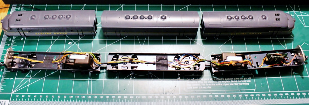

Here´s a short video of the process:
Regards / Martin T
