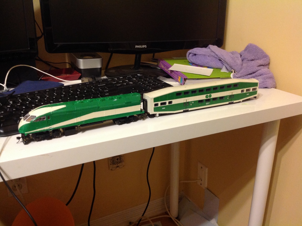

Here's the roof painted and the decals applied. I still need to add back in some of the details (handrails/etc).
It took on a bit of a fantasy livery, but pretty happy still with the way it turned out.
