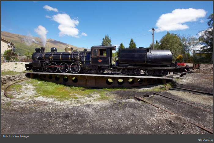

I would like to replicate in HO scale a small, manually operated turntable...similar to the below photo. Any suggestions for a commercially available product that would suit or would I better off scratch-building this? I'm using analogue M-track.

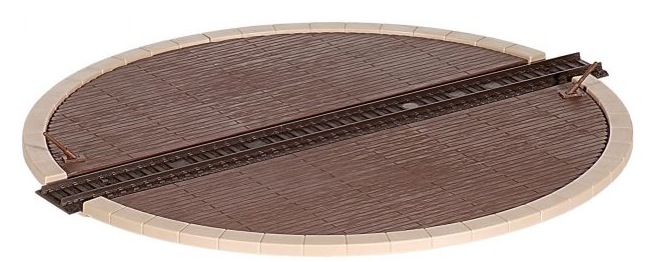

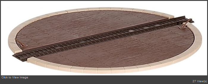

Mechanical turntables Kibri 39456 (HO scale) or Peco LK-55 (OO scale) spring to my mind.
Wink
#3 Posted : 07 July 2014 23:58:31(UTC)
Posts: 5,881
I am using the Kibri one with K track, which brings the flattop turntable tracks to same height as C track (or M track).
#4 Posted : 08 July 2014 15:06:05(UTC)
Posts: 5,881

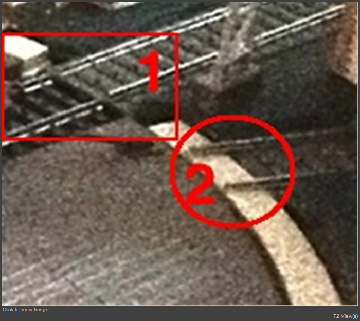

Sorry, I forgot to mention that the Kibri kit is composed of loose pieces. Therefore, I cut out a circular support, using 3 mm PDF. Then I glued the loose pieces to the circular support. Like that I reached the height of C track (or M track). And I have a "portable" turntable which I can place where I please. I attached feeder cables to the K track, and those cables dangle out of a center hole in the middle of the turntable. At first, I cut out segments for tracks to reach the turntable (see detail 1). However, if one cuts out to many segments, the turntable operation becomes unstable. Therefore, I used another approach for later addition of tracks: I glued two short rail pieces on top of the outer circle segment (see detail 2). The distance between the K track and C track stubs is so short, that any pick-up shoe bridges the gap without problems. If I could start over, I would only use the latter approach. Looks nicer, too.

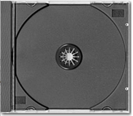

Then I heard that people created a HO scale turntable by recycling the core of a CD box and a CD for pivoting locos.

I note from your last post that you have already purchased a turntable, but are considering one day scratch building just what you want. I am assuming that you mean by this a turntable similar to the one in the photo you posted.
The turntable in the photo appears to be a product of William Sellers Incorporated of Philadelphia in the USA who made a range of turntables in a variety of sizes. The turntable in the photo appears to be either a 50' or 60' version, more likely a 60' version. A number of Sellers turntables were imported into NSW by the New South Wales Government Railways and installed around the State. We actually have a 60' Sellers turntable here in Lithgow which was donated by Railcorp and transported to Lithgow from its former location at Nowra. It is intended to install the turntable in the old turntable pit at the former Eskbank Locomotive Depot when funds are available.
If you want a turntable of this type, then you might be interested to know that Anton Bognar (I'm not certain if that is the correct spelling of his surname) actually makes a manually operated fully assembled Sellers 60' turntable in HO scale for $265-00. Anton operates a business manufacturing kits and the like for detailing NSW and Australian model railways in HO and O scale. The business operates as "Anton's Trains" and is based in Sydney. If you google "Anton's Trains", you will find his website and can see a photo of this item. It is made for 2 rail, but Anton is an old disgruntled Marklin man, and he may be able to help if you want a 3 rail version. His telephone number is on the website. He regularly attends most of the bigger model railway exhibitions in Sydney if you want to see his product range. He may be at the Newcastle exhibition on 23rd and 24th August, and will almost certainly be at the Liverpool exhibition on the long weekend in October.
