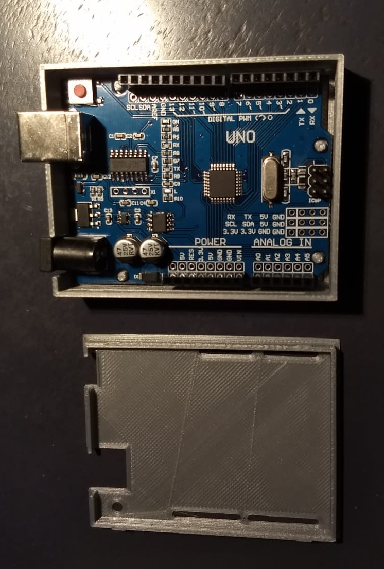

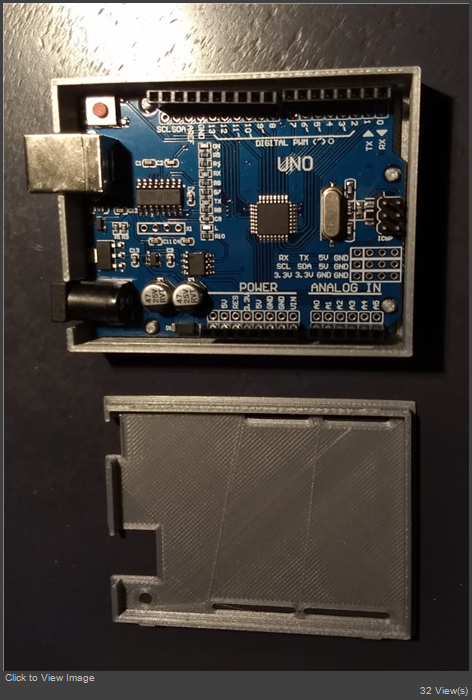

Another Dutchman here BigGrin
I am currently working on building the solution of Marcus, but also adding a DCC interface.
The intention is that I can control the turntable both manually and by Koploper (the Dutch train control software).
Once I have it running, I will post the result on this page.
In the meantime I have already printed a case for the Arduino and the keypad, a case for the relay and ACS will follow shortly.
thanks 2 users liked this useful post by Jvdwaa
