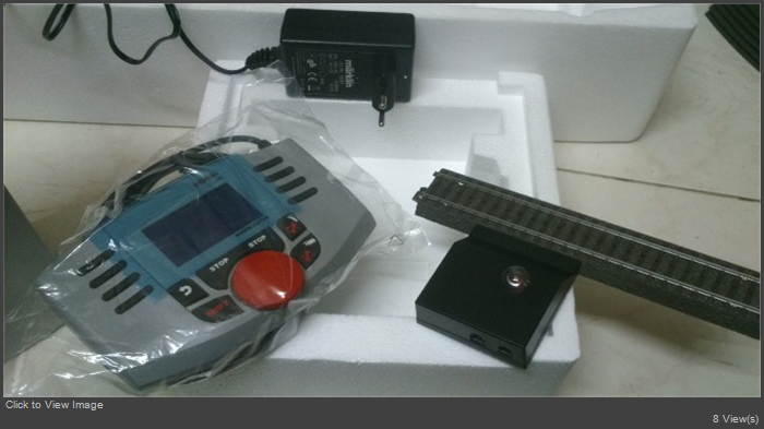

Offline madhu.gn.71
#6 Posted : 24 June 2014 10:04:11(UTC)
madhu.gn.71
India
Joined: 16/04/2014(UTC)
Posts: 775
Location: Bangalore, India
Hello all,
Thank you all for the recommendation. To summarize, I'll go for MS2 (60653) as my next upgrade option.
Untill my loco count is within 6, I'll manage with the existing IR control. Also I can set same address for two locos so that I can make then run simultaneously on parallel tracks right?
I believe this 60653 contains all the components to set up the Mobile station like transformer, feeder track wires, track box etc. Correct me if I'm wrong here.
Thank you all,
Madhu

Offline Bigdaddynz
#7 Posted : 24 June 2014 12:49:14(UTC)
Posts: 18,767
Yes that is correct. The only other thing you might need is an adapter to convert the European mains plug on the power supply to your local mains plug type.
Offline madhu.gn.71
#8 Posted : 01 November 2014 17:58:14(UTC)
madhu.gn.71
India
Posts: 775
Team, earlier I had asked if the 60653 contains all the components like feeder wire, track box and transformer etc. After a long wait of 5 months I got my MS 60653 today and to my horror the box contained only the MainStation unit Angry . I paid 109 euros and this was annoying as I still could not use it:(
I'm still not "DIGITAL". (Lokshop.de sells this at 79 euros and I'm cursing myself for having paid 109 in Conrad Cursing )
Friends please guide me here as what all I should buy now to connect this 60653?
1 If I order just the Track Box 60113 (H0), should I be able to use my MS?
2 Do I need to buy wires separately to connect 60113 to the track ?
3 Can I reuse the transformer (36VA) which I got with the infrared starter sets?
The feeder track from my infrared starter set is of no use in MS connection I guess.
Please guide me and I would appreciate if you are as descriptive as possible. I've attached the images of my infrared starter set's transformer and feedertrack
madhu.gn.71 attached the following image(s):
#9 Posted : 01 November 2014 18:46:20(UTC)
Posts: 8,463
Hello All,
I have bought the following stuff:
-29163 (with infrared control)
-29310 (with infrared control)
-36700 loco
Here are my concerns\queries:
1. With one of the two infrared controls contained in my startups, I should be able to control all the 3 engines listed above right? ( as one remote can control up to 4 locos)
2. If I need to buy a digital central station , what are your recommendations (cost effective options)? CS1, CS2 or any other Marklin compatible stuff? Please highlight the price in euroes or dollars so that I can plan accordingly.
Also if there is an existing thread in the forum, please redirect me there.
Thanks in advance,
Madhu
I am not familiar with the IR control unit, but I suspect you may need to change the address of two of the locos to operate on the control, rather like the Delta controller will only control a fixed set of locomotive addresses.
Check the instructions for the control, and it should tell you what addresses it will control.
Offline madhu.gn.71
#10 Posted : 01 November 2014 18:57:53(UTC)
madhu.gn.71
India
Posts: 775
@kiwiAlan, thank you for the reply. That query is resolved and now. I'm able to run 5 locos with one infrared controller where in two locos are set with the same address.
Now my query is that of my misunderstanding of 60653 which I bought after the recommendations by the community.
#11 Posted : 01 November 2014 19:00:03(UTC)
Posts: 3,528
Hello Madhu ??
Yes; but I think the photo you showed mislead Bigdaddy to think that you would order what was on the photo, not just a 60653.
You need a 60113, and I THINK you can use the transformer / power supply you have from the infrared set.
Can you give us the number written on the transformer? If it is 66361 it's the same as you get for a mobile station.
A much better deal for you now would be to buy a 60653 + a 60113 from a starter set, on Ebay or similar.
This way you will have two 60653s, and thus will be able to control two trains at the same time.
Buying just a 60113 from Conrad will probably be just as expensive.
#12 Posted : 01 November 2014 19:03:31(UTC)
Posts: 15,440
You're picture posted 24/06/2014 shows all you need: MS2 60653, power supply, track box 60113. These three items from starter sets typically come together for about 70 Euro - without original boxes.
You only bought the MS2 - not from a starter set, but the retail version with original box. It does not include the track box.
The 36 VA power supply is perfect for the MS2.
