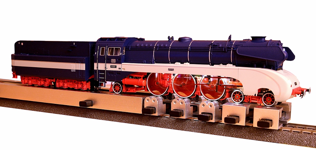

My class 10 running on my test stand
tulit attached the following image(s):
Question: would it harm an engine to run a driven wheel without a roller?
e.g., could you run a class 50 steam engine with your set up or would it be bad to free-wheel two of the driven wheels?
Thanks!
Ken
USofA
Thanks!
Hello, should be no problem.
Thanks!
I think it would be fine other than you might make it less stable and more likely to fall off the stand? You can buy rollers in pairs of two if you have locomotives with more driven axles.
