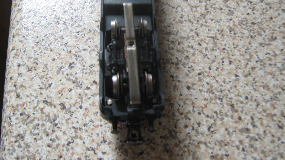

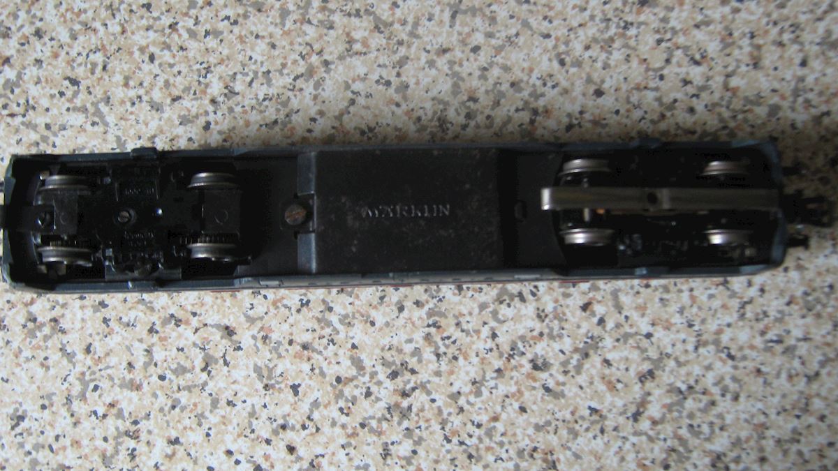

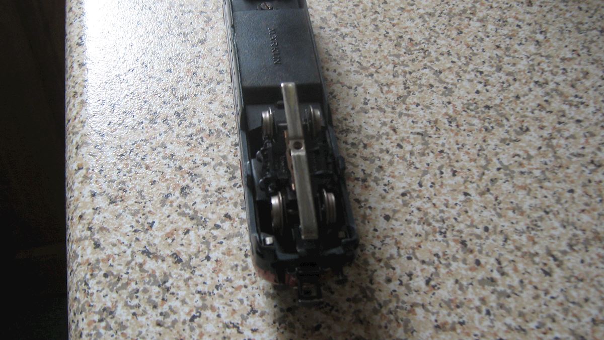

I hope someone can help .I was running my v200 060 and it ran fine over points, but when I tried to run it the opposite way every time it crossed a point it stopped. It worked fine with the shoe truck at the front but as soon as the shoe is the trailing truck it wont cross points without stopping a few inchs past . Eddie

make sure the slider is not bent sideways or is not level, another explanation could help what type of tracks you are using and see if the gauge of the wheels is correct or even better send a photo of the underside of the loco with the slider.

Thanks John , I am sending 3 shots of the beast,but I think you are right as the slider looks to be a little out. Is it just a matter of slacking off the screw and putting the slider so its even between the wheels. The pictures are not the best. Eddie I ment to tell you I run on c track

The slider look dirty, Need a cleaning job and also on track.

Thanks Steven, The slider is not so much dirty as I think its worn out. I should really change it . I do try and keep the c track clean. Take care Eddie

Catalogue number 7183 Pickup shoe. I still have one in seal bag.
