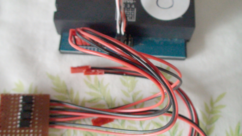

the ESU servo come in 2 versions, plastic and metal gears. the number for each servo motor is: 51804, 51805.
the servo motor has an input of 5 V DC and can be connected to a switch pilot servo 51820 (V2) this new Version has the capability for RailCom feedback.the switch servo will recognize the turnouts on your ECoS track plan, the switch pilot servo module has also a second option of controlling the servo motors manually by a pulse switch (external).
I have had a topic whereas I used the switch pilot module in conjunction with the servo motor but this time the turnout is controlled automatically via a switching track. further information needed ask me and I refer you to the topic.
the switch pilot module has various programmable functions: a.) the extend of movement to the right or left. b.) check movement from right to left and adjust speed control.
the programming starts usually with turnout being curved and the buttons provided to adjust the lever's position can alter to suit the turnouts end position. with K-tracks you have 2 options, either use the hand lever which is provided with each turnout and drill a small hole between the middle of the other 2 holes on the lever..
I've looked at Rinus illustration how he secured the servo motors to the board and I find it unnecessary to put a block underneath it. you can use several assortments of levers which are provided with the servo motor.
I have ruined several motors because I've clipped the wire to its correct length and by doing so I've shortened the motor, in hindsight the chrome wire is connected to the lever and the screw than holds the wire and the lever while screwing it into the servo motor cogwheel.
I've contacted ESU about this and they will supply plastic screws in future so nobody can make the mistake as I did by cutting the wire while the servo motor is connected to the switch pilot unit.
the last picture shows another option to control the servo motor connected to a switch pilot servo module via a switching track or reed contact or any other ground contact by using optocouplers.
the optcoupler has an independent current flow whereas on one side you can feed it with DC and the other side with AC.
the switch pilot servo pulse connection (second picture) shows eight connections (bottom left) these connection have an internal power supply therefore no other power source should be attached to it.
in the photos below you can also see the plastic casing the servo motor gets mounted into and the position of the casing can be switched into different positions, flat, upright etc etc.
the switch pilot servo module can be programmed via the Lokprogrammer
further information including diagrams can be requested
regards.,

Matt, the plastic sleeve I put around the metal rod myself to prevent any accidental contact with the rod.
secondly the motor gears are metal including the screw, so the metal rod is not isolated from the motor gears and the plastic lever doesn't isolate the rod from the gears if you look closely at the pictures.
the wire manipulates the turnout and the 3 wires from the servo motor are attached to the switch pilot servo module.
to understand how the servo motor works you have to open it up so the fact is there are also metal pins inside which hold the gear wheels in place and these pins are connected to the electronics within the servo motor.
explaining it in simple turns, the pins within the servo motor are under live current, the metal cog wheels are spinning around the pins and the brass fitting with its thread outside the motor this is where the screw and the plastic lever gets secured and the screw in turn also holds the rod in place.

Matt, ESU is looking at altering the metal screw for a plastic screw which I think is the simplest way of overcoming the possible shortening of the servo motor, nothing has been written about until I've raised the question and maybe I was the first idiot who cut the wire while it was connected to the switch pilot servo module but who would think it would create a short.
