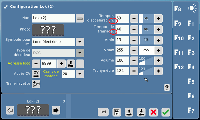

Dialogue #4 (coming from the new 3.6.2 version):
"Mise à jou" looks incomplete. Is "Rei" complete?
"FS" is German.

I think there is some design flaw in the GUI. Some text cells seem to be "fixed size with centered text", which may explain some of the incomplete translation we see.
That's a problem when applying translation, because when words are longer than the cell size they are truncated.
#Dialogue 4:
"Mise à jour" is truncated
"Rei" doesn't mean anything ! If I set the GUI in English language, I see "Rst" which I suppose means "Reset". So in case "Reset" is the expected meaning, then "Ràz" (Remise à Zéro) would mean the same thing.
I don't know what "FS" means. What I've noticed with 3.6.2 is now "FS" shows the speed step of the decoder and no more a percentage as before.

#18 Posted : 08 June 2014 14:49:07(UTC)
