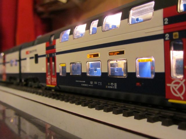

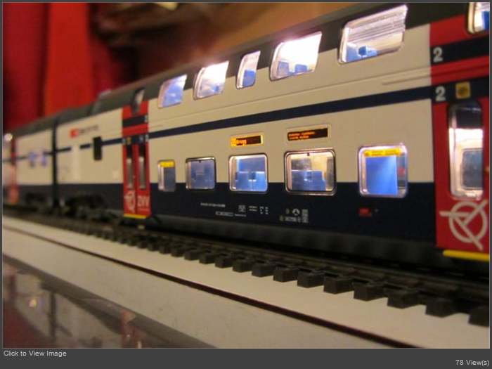

#1 Posted : 29 April 2014 06:14:18(UTC)
Posts: 8,242
I just received this new Liliput model of the SBB RABe 511 KISS double deck trainset. The four coach unit is a very nice model of the latest double deck commuter trainset used by the SBB for the Zurich S-Bahn network. The model comes equipped with one motor in each pilot coach and is equipped with interior lighting and illuminated destination signs and white or red LED headlights.
The aspect and detail are very nice. From eye level, it will be a nice addition to any Swiss themed layout.
Liliput is also releasing a model of the trainset in the livery used by the SBB outside of the Zurich region.
The one downside that I noted was that all lighting is activated by F0 and there is no separate control for the headlights, interior lights or destination sign.
It would be nice if the model had headlights controlled by F0, destination signs by F1 and interior lights activated by F2, leaving F4 for shunting mode.
The other thing that I noticed is that when the train is heading in one direction, there is a humming noise coming from the lead pilot coach when the white LED headlights are on. When you reverse the direction, the hum stops. I checked the other pilot coach to see if the same occurred, but could not detect the same noise from the other end. Is it normal for the LED or circuit board to hum when active?
I will add a photo or two of the model later tonight.

I received mine yesterday as well.
It's a great model but I am underwhelmed by the quality.
My L133930 came without a humming noise, and with a LokPilot 3.0, with headlights and destination lights controlled by F0 and interior lights by F1.
You may want to make sure that the switches in the decoder compartment are set to digital/aux. Factory delivery is in analog mode, which probably explains the all-or-nothing lights control.
Alternatively, you may be able to reprogram the Lokpilot Aux settings.
Too bad, mine does not move: the front end motor seems to be mounted incorrectly and does not connect to the drive train. I will be returning it to Germany today Angry .
Bart
*Bart
#3 Posted : 29 April 2014 18:17:06(UTC)
Posts: 8,242
One of the pilot coaches can move on it's own. The other one needs to be connected to it in order for that one to function.
When you had the problem, did the lighting work throughout the train?
It could be a wiring connection between coaches.
What happens when you connect just the two end coaches?
My model had one other little minor problem on delivery. One of the axles was not sitting properly in the bogie and was shorting out against the AC slider. That took about 1 second to diagnose and rectify.
Thanks for the information about the switches. That is good to know. Once I have changed the settings, I can use my Lokprogrammer to change the settings so that F1 is also activated in analog mode.
