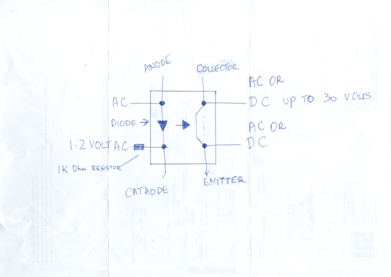

#5 Posted : 05 May 2014 16:36:59(UTC)
Posts: 14,910
Greg,
today I've reached out for help from a local IT specialist and at the same time tried it once more on the ESU forum and I had already a reply from both people, the ESU forum is a voluntary answer system so one can't expect you will receive an answer.
since I''ve connected the optcouplers I had some of them failing but one is still intact.
the new diagram I've received makes sense now and I will try it tomorrow and see how it pans out but I'm pretty confident it will work this time.
the whole idea was to be able to use 2 digital components from different manufacturers and because they are not compatible by direct voltage connection, the opto coupler serves as a double independent voltage supplier and at the same time sends a signal to the emitter and collector from a led, so the moment the led gets a voltage contact it send the signal to the emmiter-collector and this in turn activated the pulse connection on the Switch pilot servo module (common voltage) and it doesn't allow you to connect any external voltage to the pulse connectors.
my next project will be to replace or stop using switching tracks and use reflective optocoupler which can be placed between sleepers and the slider when going over it will activate what ever you intend to activate, e.g. ESU servo motors via the ESU Switch pilot module.
if it works and I can't see why not this will a.) reduce the price again considerable, so long there is no debris over the reflector it will be more reliable than the existing switching track and also can be placed anywhere on the track system without any interruptions to a.) replacing or ripping up tracks, b.) finding a spot to install them and c.) one could place a reflector between each sleeper if you need more than one to be able to activate another source of contact.

#9 Posted : 06 May 2014 05:04:19(UTC)
Posts: 14,910
Anders,
thanks for your diagram, there is one problem with it, the set up you've displayed is the same set up I have (Märklin braking modules and switching tracks.
the problem with the ESU switch pilot servo module is, the A1-A8 connection is an internal power supply and not suitable for an external power supply, hence the use of an optocoupler.
Sofar I have not being able to establish whether or not the voltage is AC or DC on these pulse connectors (A1-A8) but I assume it is 5 volt DC the same voltage used for the servo motors.
in the switch pilot servo brochure it says the connectors (A1-A8) you can use pulse switches and activate the motors but you're not allowed to use them from an external power supply, I tried one and ruined it.
the first diagram shows the optocoupler and its function, the second diagram shows a reflective optocoupler (replacing the switching track) coupled with an isolator optocoupler. recommended track: k-track
regards.,

#14 Posted : 12 May 2014 04:48:34(UTC)
Posts: 14,910
Well I've cracked it now, all is working fine and the diagram for the optocoupler is correct, modified all my optocoupler circuit boards by adding 8 resistors.
