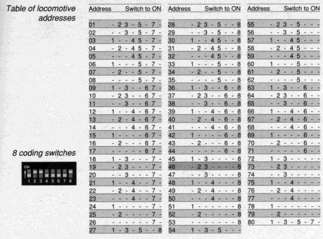

MärCo: The Piko manual says that the locomotive uses the preset digital address 78 "Marklin Delta steam loco address". One detail: the Piko lights works when I select the first position in 66045 control, but lights doesn't puts on with other positions. I think that the 66045 and Piko 'talks' with the 78 address, but have any problem with the weels :)
I've some doubts with the Marklin BR 81 locomotive. The manual talks about one control (DIP-switch, similar to this:http://francis.courtois.free.fr/jc1/serial/Cases/Inficon/DipSwitch.gif ) with 4 position (1 to 4), but in the real life my BR 81 locomotive have 8 positions (1 to 8). Seems that is more modern that the manual --or not, I can see this 4-switches in images like this: http://images.google.com...q=marklin%20dip%20switch
Without a valid manual, I think that the 72 address means the 7 and 2 in the ON position. I think this because the manual says that the 72 address works with 1 and 2 switchs ON (in the 4 DIP-switch module), but with this combination the locomotive doesn't runs even with the 6647 transformer alone! With the 7 and 2 ON, works fine with the 6647 transformer.
Now I'm worried with the BR 81 DIP switch because my son (aged 8) have anxious with the mechanics and quickly have modified the switchs: all to OFF except 7 and 2. Now he doesn't remember the original switch positions from 5 o 8 switches. By the way, now have one new question: anyone knows the BR 81 DIP switch original positions or have a manual that talks about modules with 8 switches instead of 4? :)

The positions of DIP switches 1,3,5,7 correspond to the four of the little one, if the 2,4,6,8 are set to off. At ./downloads/switch.zip you have a utility for your aid. Note that some delta decoders must be set to all off for analog running, and this setting may not be used for digital running. Others recognize analog running automaticly.

<br />Without a valid manual, I think that the 72 address means the 7 and 2 in the ON position. I think this because the manual says that the 72 address works with 1 and 2 switchs ON (in the 4 DIP-switch module), but with this combination the locomotive doesn't runs even with the 6647 transformer alone! With the 7 and 2 ON, works fine with the 6647 transformer.
For address 72, you have to set switches 1 and 3 to ON, all others to off. (Switches 7 and 2 give address 25 which is not supported by the Delta Control.)

Here is a list with settings for a decoder with 8 switches:
Address
78 = delta 1
72 = delta 2
60 = delta 3
24 = delta 4
80 = delta 5, can only be used with the delta pilot
Absolutly AFB-NOHAB fan ;-)

The positions of DIP switches 2,4,6,8 correspond to the four of the little one, if the 1,3,5,7 are set to off. At ./downloads/switch.zip you have a utility for your aid.
Thanks for the utility! I use GNU/Linux (SuSE) but switch.exe works with the Wine emulator (here the evidence: http://bitassa.com/stuff/switch-win-wine.png :)
The programs says that put 1 and 3 ON for the 72 address, maybe the 1, 3, 5, 7 switches correspond tot the four of the little one?

The combination is 1 and 3 on. With your workaround first and with the switch.exe confirmation after, the 66045 now works. More details at my response to Lars Westerlind.
