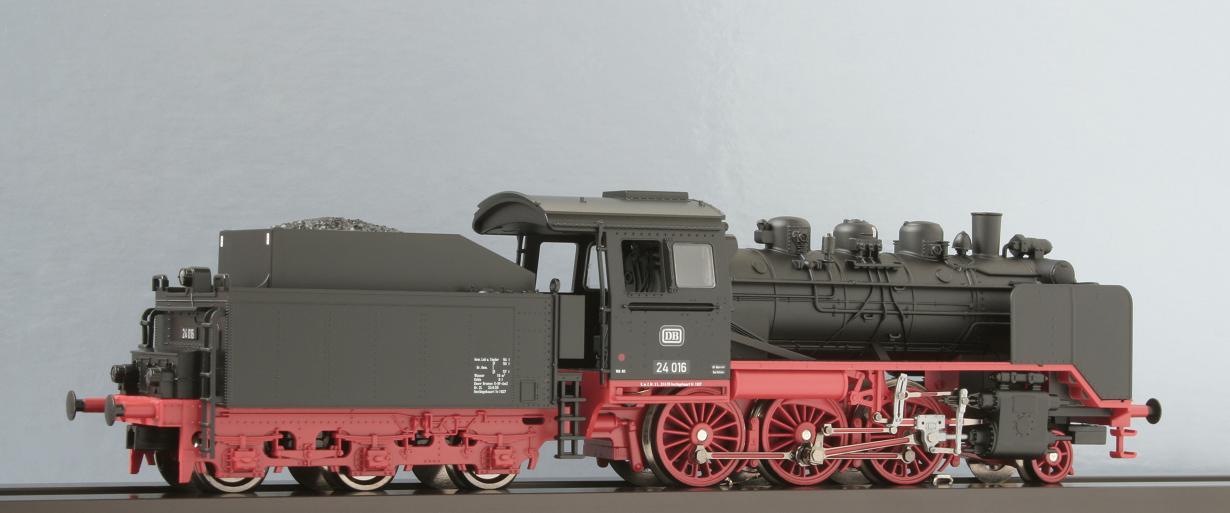

I bought a pair of these wonderful locos last spring. Märklin item 36242.
So far so good.. BUT.. They have serious problems with the motor control. They run smooth and nice as long as the locos is running without cars on a flat track.
As soon as it is pulling cars and especially on track climbing, or even worse going down, they change speed like a "rubber band effect". It seems (without really knowing) that the decoder is over compensating the motor load, or compensating too fast, or possible keeping the compensation too long time.
I have never altered CV values for the motor load compensation on my CS2...
QUESTIONS:
1) Do you think the rubber band like motor drive problem can be corrected by altering the CV values?
2) If so. Which values should I be working with?
Please help.
Regards / Martin T
