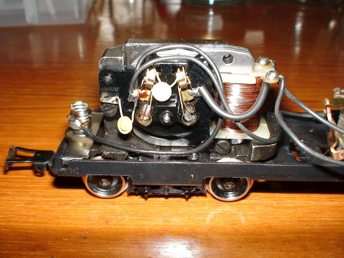

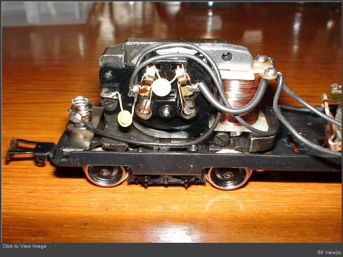

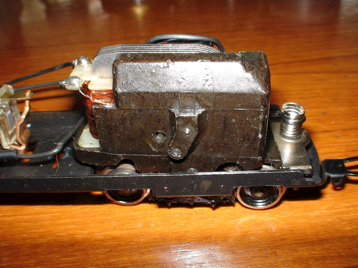

I'd like to show some photos, but have not yet been able to work out how to do this on this forum. Let me know how, please!

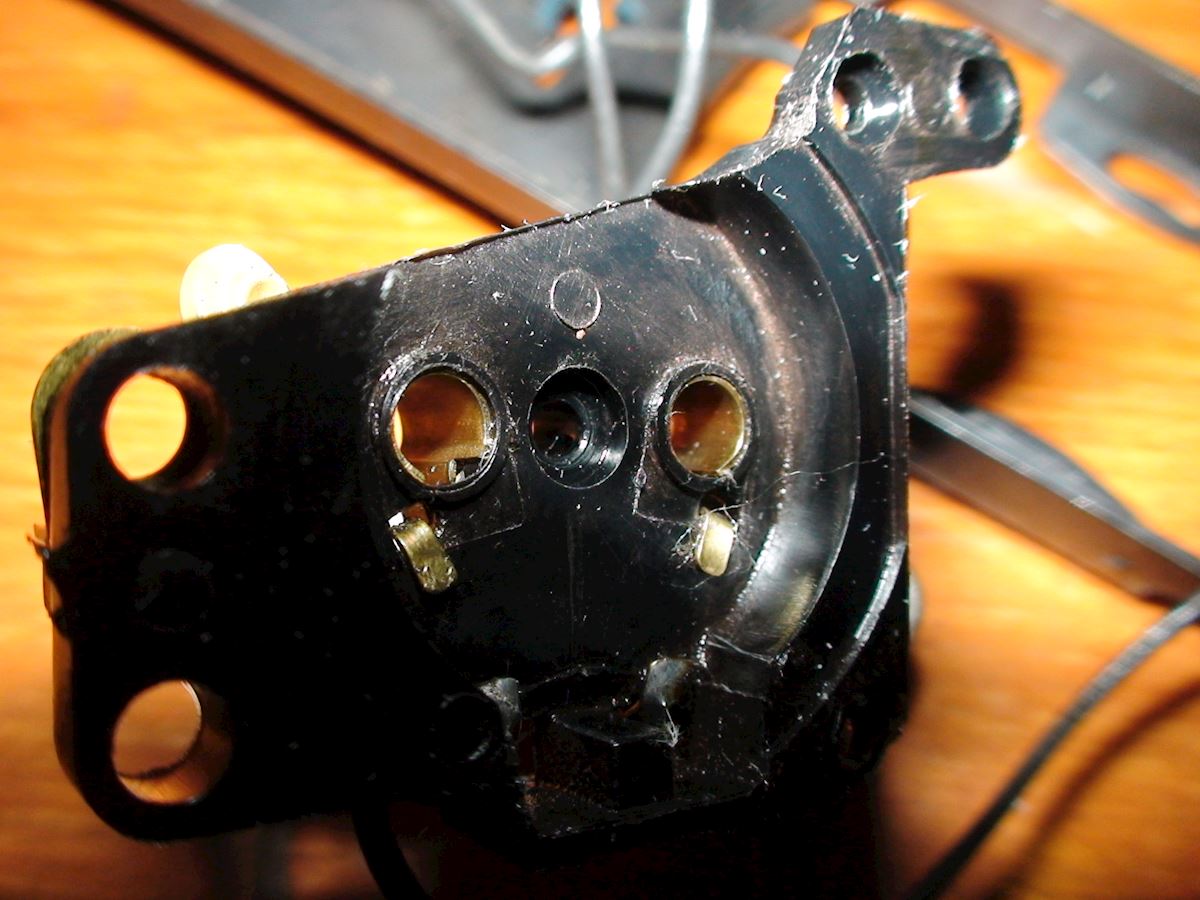

Here is what I think happened: The Ballistol loosened up the gunk that had built up over the decades, turning it into something akin to engine grease. Then, when I added even more Ballistol, the gunk liquified enough to free up the parts until a tab got bent into the rotating path of the rotor.
Ballistol is actually designed to do this, i.e. to dissolve baked on residues until you can wipe them off.
There are 2 small copper tounges that are inserted (from the side of the armature (?? not sure what to call it) that holds the brushes) into the motor, and then they get bent flat against the inner housing of the motor. One of these tabs had somehow been straightened out again, thus interfering with the rotor's movement.
When all the gunk was cold, then the rotor could not touch the protruding copper toung, but once heating of the gunk made it softer, the rotor began to occasionally rub against the protruding copper tounge. This caused the intermittent loud screeching noise, which was accompanied by sudden deceleration of the engine. When I added even more Ballistol, things got so loose that the rotor eventually hit the protruding copper so hard that it got bent into the path of the rotor, making further rotation impossible.
Once I've figured out how to integrate photos, you'll see what I mean.
Thanks again, Mik
ps: Photos now attached, but how do you integrate them into the text and maybe explain what each photo shows if needed?
