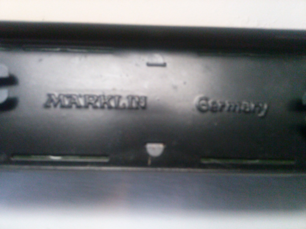

I am concerned about your comment that the track is a hard plastic. That does not sound like a Maerklin 3 rail track from the 1950s.
Does it have a centre rail or contacts? Perhaps posting a picture of the track will allow forum members to identify it for you.

Peter, thank you for your quick response and you indeed helped solve this. In looking close at the beds in the light I found the markings, RIVAROSSI Made in Italy. A quick google search did not show me any 3 rail rivarossi tracks. I do have the transformer for this track but the lettering on it is completely in Italian so I am not sure about plugging it in.
I do not have any rivarossi or lima trains that are 3 rail so could the Marklin have been used on this track at one time?

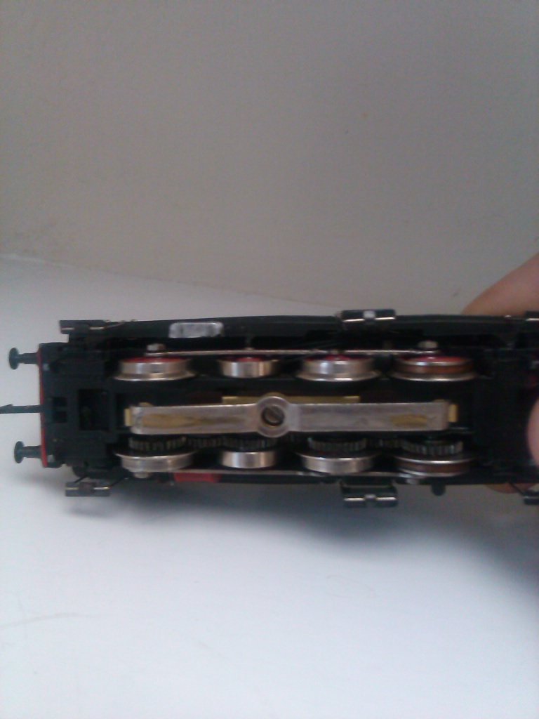

Hi shamrock,
Your Märklin locos could be HAMO, or in other words 2 rail locos ...
Easy to check, do they have a slider down the middle of the underside, or not ?

Hi shamrock,
One step at a time ... ^^ ;)
Yum Wink
The E6302 small green Kroc has the slider in the middle and the Made in Germany lettering. The brown Italian loco has the pick up buttons not a slider. I am wondering if that one is a rivarossi instead?

So, gentlemen, are we saying the little silver "buttons" on the underside in the middle are the pick-ups for the third rail rather than the slider?
Keep in mind, this would never work with modern Marklin "stud" or "pukos" in the middle.
Looks like a very interesting assortment of trains. I am very curious how this will work out for you, since I have a fondness for Italian trains.

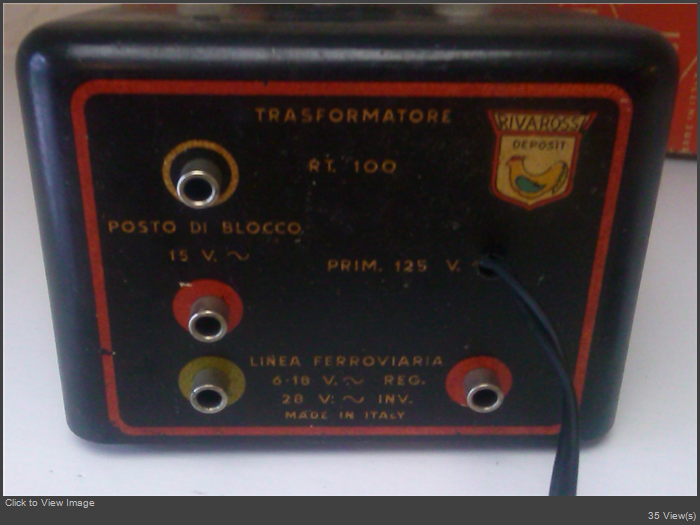

The transformer you show in the picture is rated for North American use. The primary indicates 125 V which is fine for the standard US 115-120 V service.
I don't speak Italian but from the terminal arrangement on the back it looks like you have a variable AC output of 6-18VAC (Can't tell if that is a 10 or 18 in the picture) on the bottom two terminals (Linea Ferroviaria is the train track) and 20 VAC for INV which I assume stands for Reversing.
Not sure what the upper left 2 terminals are for but it appears to be a steady 15 VAC most likely for a lighting or accessory circuit.
Safety First: If the power cord is not frayed and showing any bare wires it is probably safe to plug it in. If any bare wires are showing don't plug it in because you could get a nasty 120 VAC shock. What I normally do when I want to test out an old transformer and haven't been able to look inside is I plug it into an extension cord and place it well away from me and away from anything combustible, and then plug the extension cord into an outlet. That way if the transformer is faulty it will not blow up in your face or hands and will trip the breaker or blow the fuse in your house for that circuit.
If nothing shorts out or trips a circuit, take a voltmeter and measure the AC voltage output on the bottom 2 terminals as you move the lever from left to right and make sure it corresponds to the 6-18 V from the nameplate. I can't tell if the INV is a button on the top or a light. So depending on what it is check for the 20 V output after momentarily activating it. Similarly measure the upper left 2 terminals' output and make sure it reads 15 VAC on your meter.
If all of that checks out, you are good to go. If you get 0 V output check the fuse on the top.
If you are at all concerned about it, have an electrician check it out for you at your local electrical supply shop. Consider your own safety first before saving a few dollars on an old transformer.
Hope that helps.
Such "exotic" voltages were widespread in Europe until the 1950 and especially in Italy until the 1970s. For example Märklin offered 100V, 110V, 125V, 150V and 220V for Germany. In other countries also more exotic combinations were used. I remember that somewhere in a book about HORNBY a transformer for 75V / 100 Hz is described.
I also would not try to use the old transformer.
Best of luck,
Mark
Hi Mark,
There can be two placements of buttons, those shown in the centre would be for the middle rail - solid rail of course but some may have an offset button which is actually for track detection - many of Märklin's HAMO Loco's also have the same button and the idea (as I understand it) is that a special track piece is used and the passing of the 'button' bridges these two rails to activate accessories.
The track is otherwise normal 2-rail but someone with detailed experience is sure to add to this.
Here's a photo of the underside of my 8322 Hamo Cl 194 (waiting to be converted to 3-rail) showing the button. I also had one in my 8359 Le Capitole but that button has been removed (just a c-clip holds it in place) when I converted that.
Best of luck,
Mark
Hi Mark,
