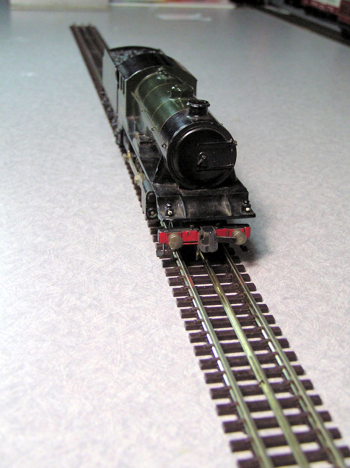

This project started several months ago after reading an Article about a fellow in the UK that had made some three rail flex track to run his older course wheeled Trix models on.
The new track will accommodate both two and three rail rolling stock and locos, AC and DC, course scale and fine scale wheels. I am not concerned about rolling stock designed for rail any finer than code 100 as I do not own any. My cutoff is usually in the mid 60s, with a few exceptions.
The picture shows the difference in height between Peco Code 100 track and the same track with code 100 rails replaced with Peco code 124 rail. The (third) center rail is a length of code 100. It has not been fixed in place yet.
I may use lengths of piano wire instead to make it less obtrusive or simply blacken the rail. One negative issue with using piano wire is the increase in wear on the pickup sliders due to the narrow contact point of the wire on the pickup surface. This can and will cause premature wear of the slider pickups. One way around this would be to use a larger gauge piano wire to increase the surface area at the contact point. But if I am going to do that, I might as well use the now redundant code 100 rail, blackened of course.
I thought of using PECo SL-17 stud strips but I may not bother with this anyway as my Trix, Hornby Dublo and some of my Marklin locos do not have slider pickups; they do not perform well on stud track. I have some stud strips around here somewhere, but they are hiding on me.
The sleepers are from a length of Peco code 100 track. The hardest part was removing the original rail.

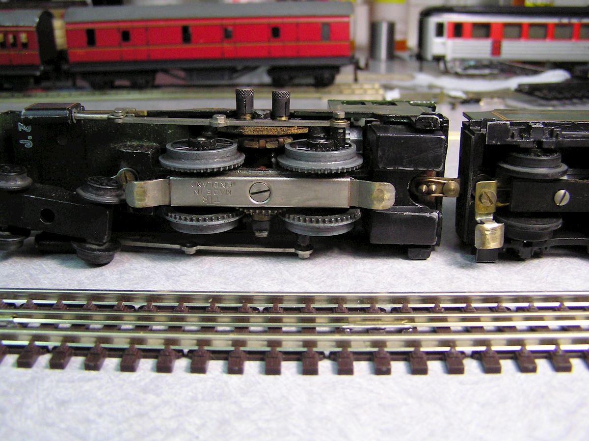

Here is the finished product, at least the MkI prototype. It is fully flexible just like the PECo SL100 track section it was made from. I plan on changing the design and assembly somewhat on the MkII version to simplify assembly.
I can now run all of my Marklin, Trix Express, Trix Twin, Fleischmann and Hornby Dublo all on the same track. AC or DC, two and three rail types but not all at the same time of course. Some types can be mixed and run together but not all. But with a big enough layout with several main continuous circuits, sidings and passing loops things should be exciting, LOL.LOL .
I am writing an illustrated article on the project and will post it here when it is finished, or at least provide a link to it. I have included a few pictures in this post.
