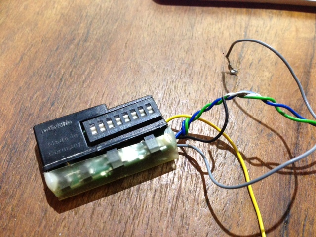

I found this amongst a box of stuff I bought. Obviously, it's a decoder of sorts, but that's all I know. Anyone have any idea if it's digital or Delta (I assume the latter), and which colour wires correspond to what? I'm thinking about doing my first conversion with it on an old railbus I have, as if I make a mess of it I haven't really got anything to lose. Any help (esp. photos) on fitting these would be fantastic.
jasondixon attached the following image(s):

Would love to help....but can we have a picture of the "this"?Wink

Oops!!! Photo uploaded successfully this time :)
#4 Posted : 21 October 2013 15:46:07(UTC)
That is a 6080, first generation digital decoder, ca 1985.
It is missing the two red and brown supply cables.
If you need their location I can send you a pic on where to re-attach them.
That would be great. Do you have the whole list of connections too?
#6 Posted : 21 October 2013 18:46:43(UTC)
Here it is.
It is a 6080, for Märklin's historical wire wound stator motors (aka Universal motor)
Red: power pick up (center rail)
Brown: power return (chassis)
Green and blue : left and right winding of the stator
Black : to the brush that is*not* connected to the common of the stator
Yellow: front light
Grey: rear light
Have fun
As others have said, it's Marklin's first generation Digital Decoder. VERY basic in features, but if you are putting it into an older suitable model (and the Railbus is perfect for that, also something like a 3000 or any other really common basic loco) then it may still be better than nothing at all, particularly if you are not completely used to the features and operation of the newer generation units.
It will give you smooth reversing, and directional control of headlights, and 80 addresses to choose from but that's it. But still better than a mechanical reverse unit.
If nothing else you will have a bit of Retro-Digital in your fleet.
