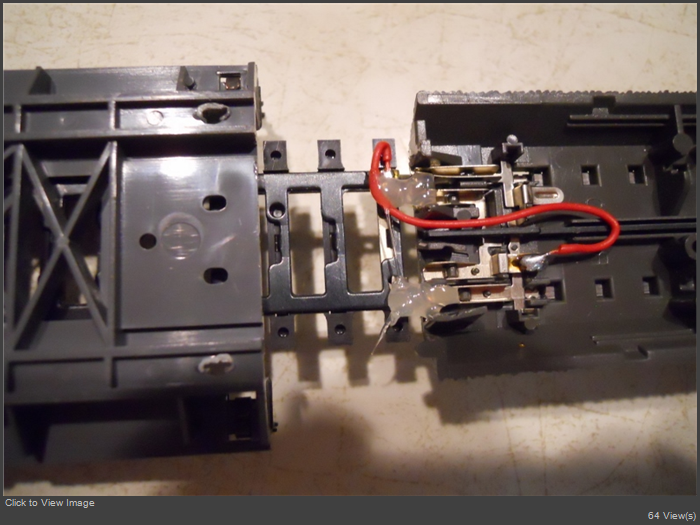

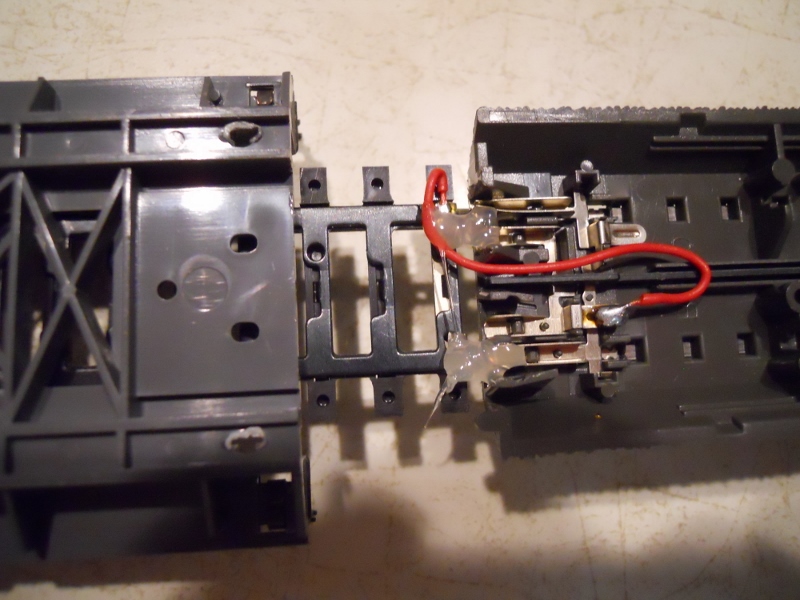

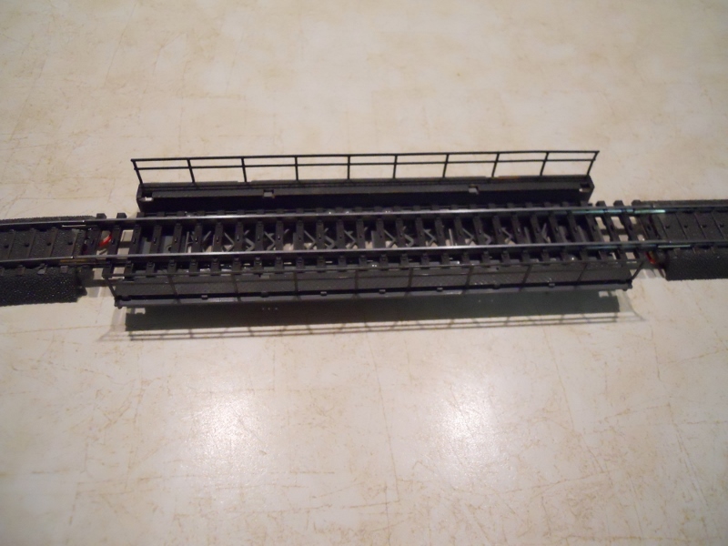

Never being happy about how C-track looks over the Marklin Bridges I came up with my own C-Track -K-Track solution.
See Pictures

Do your use ordinary (code 83) rail joiners?

Hi Kimball,
I have some older K-track and I pull the rail Joiners of them and use those.

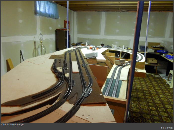

I am building a layout with a combination of C-Track/K-Track. I Just cut the C- Track under the rails and use Rail-joiners to join the two different Tracks
together ( of course you have to cut of the Tabs on the C-Track ) also as you can see in the above Picture you have to wire the centre Rails together.
