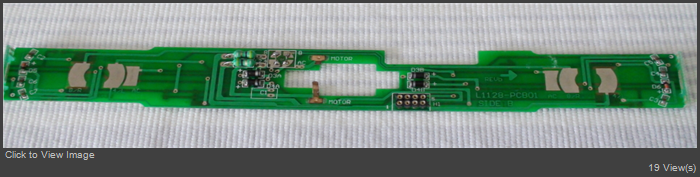

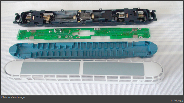

this new dome railcar from Liliput is ok but taking it apart is no easy task or to be more precise putting it back together is quite a task and not knowing what's in stall, suddenly you've got parts on your desk. a.) both side windows popped out when trying to put the housing back on (broken) and the light diffusers have also come loose.
the reason: the housing which incorporates the light diffusers get caught with the interior module on both sides and by pressing the housing down so it clips into the moulds the light diffusers get separated. don't know why the side windows popped out.
the price thy are asking for one would expect interior lights, a driver and may be some people.
the design is simple and it more or less separates itself into 4 parts.
the metal frame, circuit board, interior board and housing.
the railcar has 2 rubber tyres and 4 axles are powered. it comes with an ESU lokpilot decoder,
the light change over is from a slightly yellow colour (I wouldn't call it sonny white) to red marker lights. the running characteristics are fine and the motor is very quite. the weight would be enough to go anywhere and 2 rubber tyres would be also sufficient.
As mentioned in the locomotive column, the price is in my opinion quite expensive and for Euro 231.00 you would expect interior lights.
I will see if it can take a loudspeaker and the end result could be a railcar with sound.
I will add interior lights, add a driver and this than would full fill the extras.
there are no instructions how to take the railcar apart but there are instructions how to oil it.

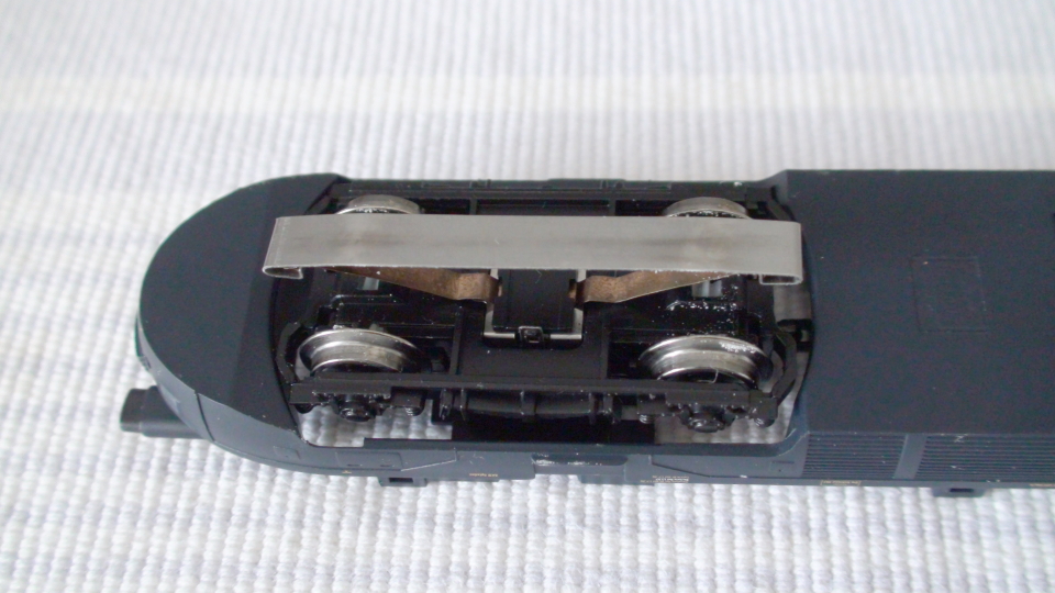

I didn't look properly if they do detach themselves but it looks like they can be, when looking at the spare part list they can be ordered separately, when I stuck them back in again they just fell out again, hence I thought they were broken. I may not have pressed them in hard enough but I didn't want to break anything else by putting too much pressure on it.
there are some dealers who offer the railcar for less and I paid half the price you paid for but I was just saying paying Euro 231 for the recommended retail price I thought it was a bit steep.
changing the decoder isn't dramatic but you have to tuck in the wires and at the same time trying to get the 2 motor contacts tongues from the circuit board on each side of the motor.
to take the housing off, I used my thumbnails on both of the doors on each side and pressed them outwards holding it while I used my finger to press down on the buffers and this released the housing on the front and then worked my way backwards.
taking the interior off you have to take a small screwdriver and get behind the clips (4 on each side) starting on the inside ones and than tackling the outside ones, the moment you've got one side loose its easy to do the other side. after releasing the inside clips I was holding it again until the outside clips had been released. the circuit board lies loose and is held firm in position after you refit the interior. when replacing the decoder I would recommend using some type of tape to keep the wires rolled up. the decoder sits on one side recessed cavity, the interior has also free space for the decoder and should only be put back in one direction, the circuit board has 3 contacts on one side instead of 2 on the other side and the extra contact provides the contact for the slider. the same goes for the interior is has also got a recess cavity where the decoder sits.
I would suggest to put the housing back in such a fashion by using one end and fold it underneath the interior so the little light diffusers don't get ripped off when trying to put the housing back on again and than try to fit the other side carefully by pressing it down and getting passed the interior. I think the reason there is a tight fitting so the light doesn't intrude into the upper level of the railcar but by fitting the light diffusers onto the inside of the housing the scrape against the housing, if they would be flush with the housing this wouldn't have happened so I assume a small design fault unless I'm doing something wrong here.
