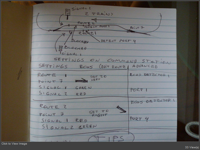

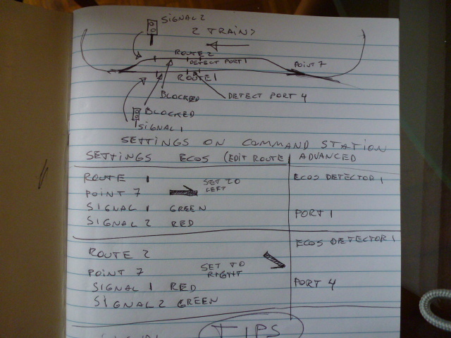

If you are willing to try to learn as you go I can give you some tips and ideas based on my controller although I don't think the differences should bi huge. In my notes there are only two tracks but you can ad just about as many as you like. I suggest you connect and program only two to start with and once you know how it works ad the rest. Everything I am going to say is based on my drawing but changes can be made. At the left end you need an isolated section (on each track) connected to a signal that will cut or give power that isolated section should be at least 36cm long to make sure trains stop. Before that you need some kind of detector e.g. circuit track, contact, reed switch, etc. Trains run always in same direction. Point7 is the only one I connect to direct the trains through route 1 or 2.
In the CS2 you probably have a screen similar to mine (points signals on the tab) tool button located down right on mine. Clicking that should allow you to enter you signals and points and detectors once you do that (same screen in mine) you can start creating routes where you need to select the conditions for the point to change to route 1 or 2. You will need to start playing with that a bit before we can advance more. See how it goes good luck!
Iamnotthecrazyone attached the following image(s):
thanks 1 user liked this useful post by Iamnotthecrazyone
